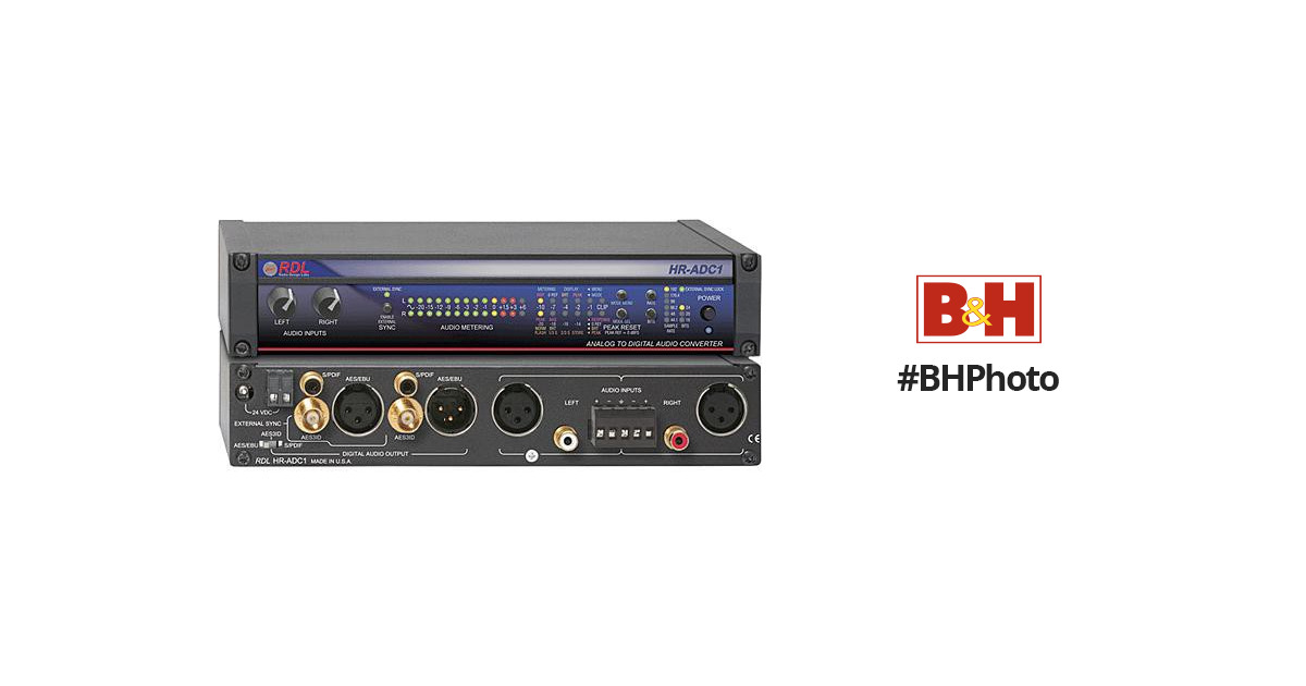

I checked B&H and the price went above 600 before I found one with 192khz, so maybe that's a bit too much to expect. Their cheapos are all 48khz sampling rate.
Now having looked through these for the last 30 minutes I'm leaning towards that first one. Almost every reputable company only sells up to 48khz. There's also a huge amount of clone products with different company names on them all sporting 48khz. Surprisingly the one I linked isn't also a highly cloned item considering it supports higher sample rates. The most annoying products, and the ones that I was finding last time, were idiots who confused a DAC with an analog to digital converter and thus 192khz is common with those. Upon reading the fine print and looking closely at the images they were just clueless.
