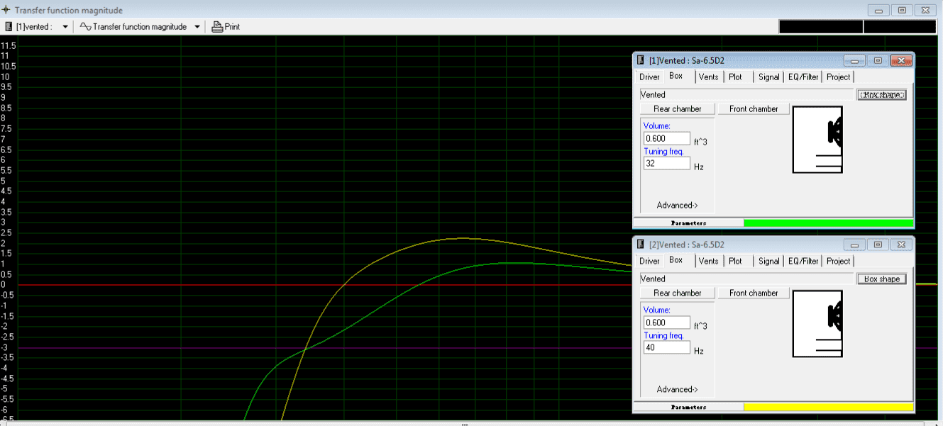

IDK... really after lookin' at both tunes, I feel the 40ish tune will sound better IMO. BTW I just overwrit my X6.5 parameters in the database earlier but the tune looks basically the same at 32hz. Too much loss of output and that's a bad tradeoff with small cone area IMO. Here's the database fixed so you can see it's a Sa-6.5D2 and it still is basically the same IMO. 38hz is as low as I'd personally go as the 45hzish punch will kinda be diminishing already tuning from 40hz to 38hz.
Green is 32hz and Yellow is a 40hz tune.
I might be proven wrong yet but that's what I'd go with.

Modeling the subs is probably better than just using a box calc and manufacturer recommendations IMO.
If it was me and I had the width I'd do a single 3.5" round 23" long... that's 41.03hz in a .6ft3 net enclosure. You'd gain efficiency and punch right where you need it with the small cone area. I don't know if you have the space or desire to tune a touch higher (using a round) but the 32hz tune looked like a dog to me.
The sheet is blurry when I zoom in with my iphone, so I cant really tell if it was impedance or frequency, thanks for clarifying. I was originally looking at doing a round port, but noticed that a slot might be shorter and accomplish the same thing. Im not opposed to round ports, I have a lot of various sized PVC available, it just seemed more efficient to use the slot. What makes a round port better than a slot? The 40Hz graph does look a lot better, and its easier to build a shorter port.
This is what I'm referring to... green is a 32hz tune, yellow a 40hz tune and pink a 44hz tune all in the same .3ft3 airspace. That's the X-6.5 but it's another higher Fs driver... I suppose they would sound ok with a 38-39hz tune but I really don't know. Looks like a TON of output loss to me with the lower tune... just sayin'...
Green line sounds terrible to me but I hear a lot of guys tune like that and think it's great. Yellow line should do nicely,,

It's hard to approximate cabin gain in Winisd but the Linkwitz-transform filter function can be used to "estimate" and I mean roughly estimate it. The 32hz tune looks like it's peaking around 30hz to me that way but again its gonna sacrifice output. They're only 6.5's so don't expect too much but they WILL dig. But its FAR below fs again... idk... you might be pleased.

It's hard to approximate cabin gain in Winisd but the Linkwitz-transform filter function can be used to "estimate" and I mean roughly estimate it. The 32hz tune looks like it's peaking around 30hz to me that way but again its gonna sacrifice output. They're only 6.5's so don't expect too much but they WILL dig. But its FAR below fs again... idk... you might be pleased.I'm out... good luck.
I not expecting car shaking bass, maybe a little rear view mirror shaking. Ill try it at 40Hz like your model says is best, if its not good enough I can just extend the port with a board on the inside. Maybe Ill do the round port partially in the box and coming out under the seat, that way I can play around with it. If I do it under the seat I wont have a hole for my boys to fill with toys, food, trash and boogers.
