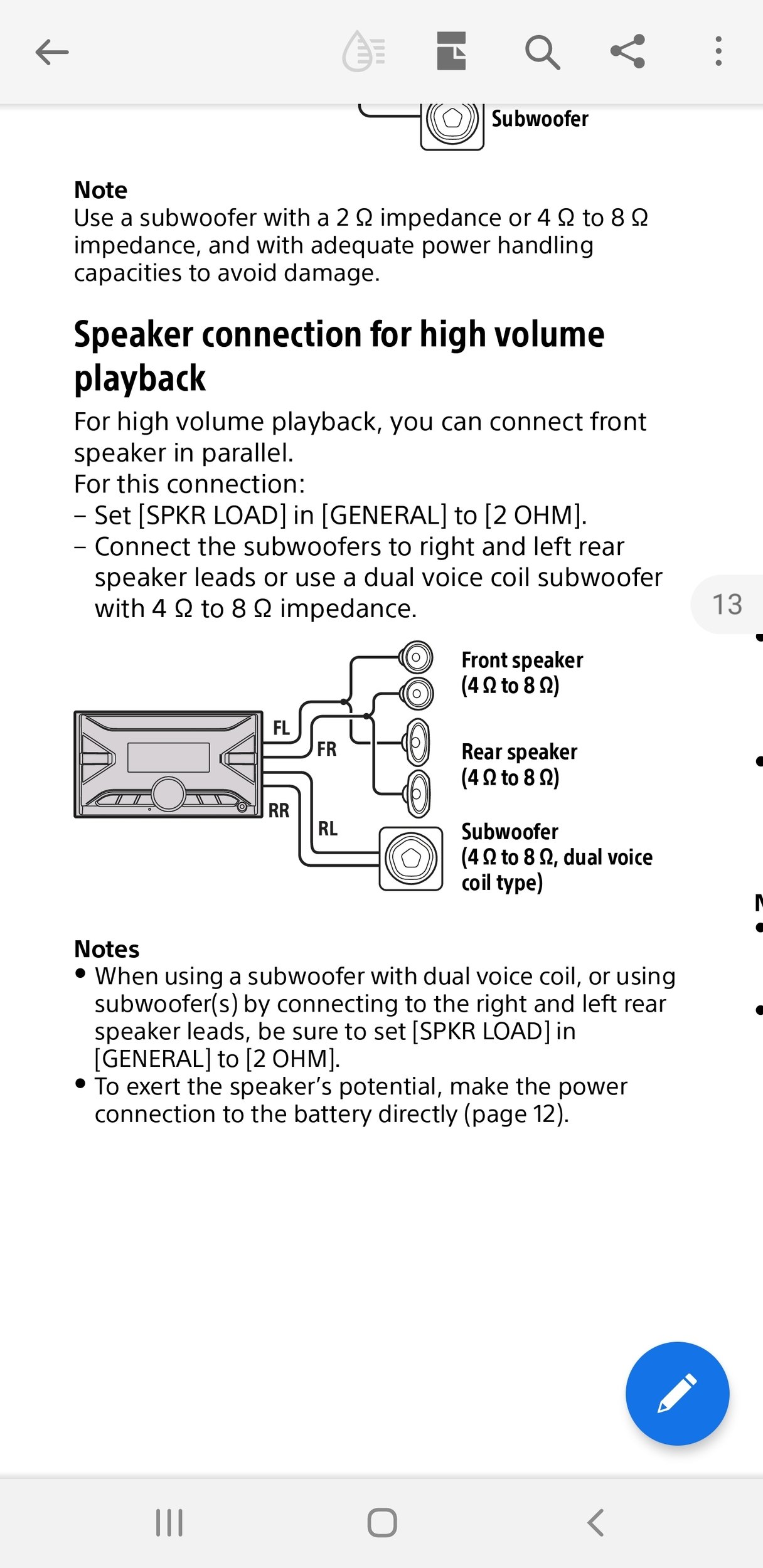

I am no genius when it comes to wiring a car stereo. I am running a Sony DSX-GS900 High power head unit. It allows for the rear channel to be setup as a powered sub output. I want to run 2 6.5 coaxial up front and 2 6.5 subwoofers in the rear.
The diagram only shows both rear leads going to a single dual voice coil sub.
So how would I run 2 6.5 subs?
One wire to each sub?
Should the subs be single voice?
Should both wires run to one sub first, then over to the other sub?
And finally, what Ohm should the subs be?
I get so confused!
I called Sony, no help at all, told me to go to an installer.
Any advice would be much appreciated. i
