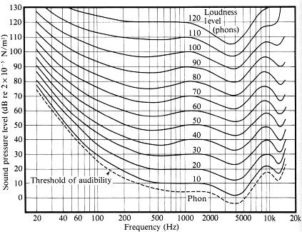

If they are scratchy, try to EQ the area between 2K & 5K and gently bring down the levels to resemble something like the Fletcher-Munson curve. If they are sizzling, gently reduce the 12K and above range.
