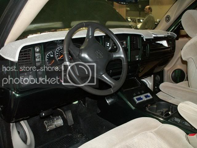

There is enough room there you may just have to work a little bit on placement. I"m attaching a picture of my tweeter in my A-pillar there is some glass work done and it has been wrapped in factory headliner material. I'm sorry I don't have a better picture, I will try and get one and post it here for you. The area around the tweeter was built up slightly with fiberglass and smoothed to transition smoothly into the a-pillar. You don't need to make it perfect if you decide to wrap it.
