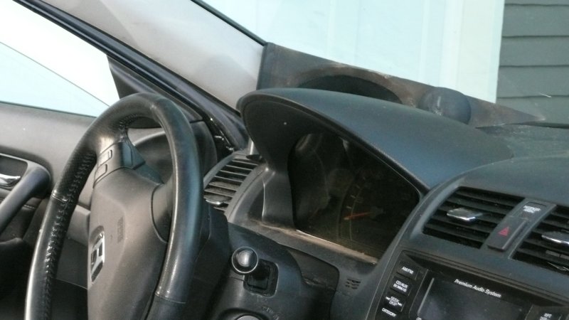

The dash is a violent place to put a full range, there's a ton of nasty reflections. And it gets 10x worse if you use multiple drivers.
Having said that, it's the best location in the entire car, there's no doubt about it. And I think you're on the right track, using multiple midranges. It's a necessity, to get the power handling and the efficiency up. I am currently using three midranges per channel. So I'm on the same page as you.
If I can help tune this thing in any way, let me know.

And here's what I'm rocking on my dash. Four midranges and two compression drivers.
