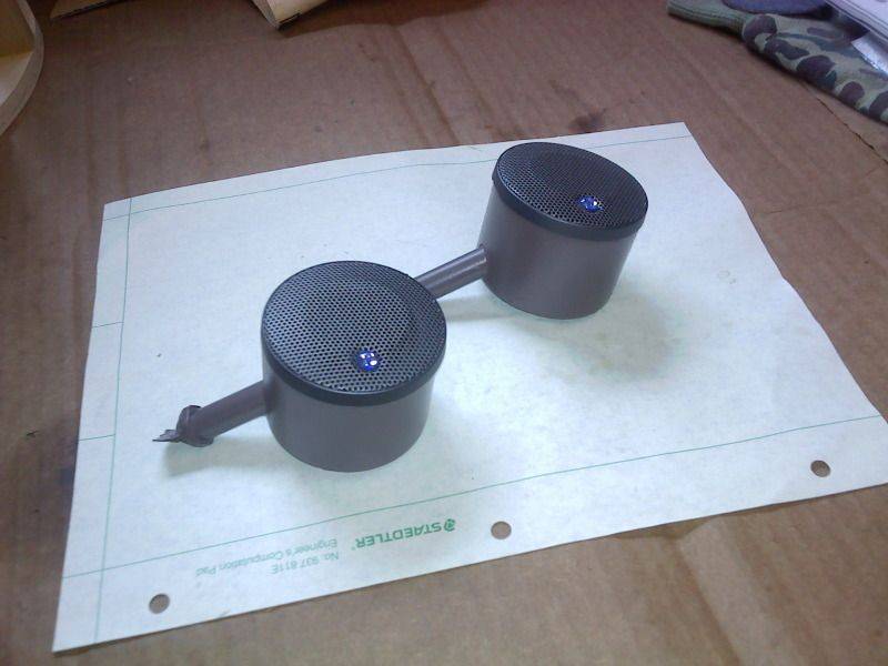

here is one option using PVC caps and threaded lamp rod

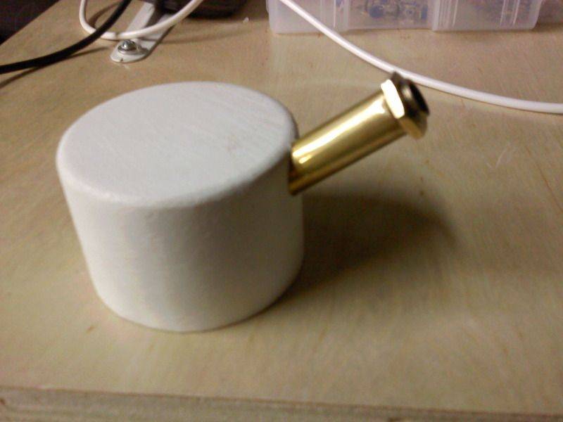

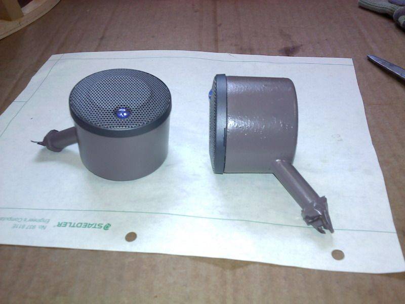

the threaded rod is covered with a brass tube cut to length so just 1/4" or 3/8" of threaded tubing is left. drill a perfectly sized hole in the panel (apillar, sail, etc.) and the brass tubing acts as a washer, a nut holds it in place.
spheres also greatly reduce diffraction which improves tweeter accuracy and resolves some phase issues.
