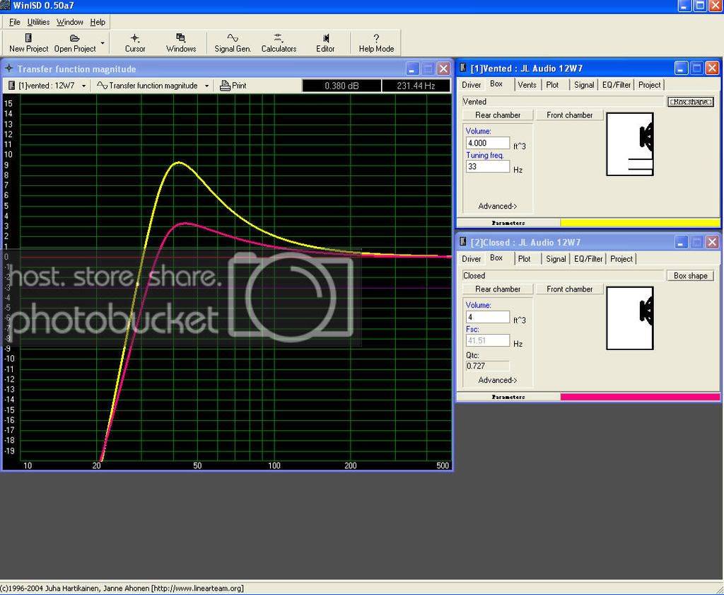

Those subs will not sound that good (my opinion) in a small ported box because there will be a response peak in the 40-50 hz region that coupled with the transfer function of the car will grossly exaggerate those frequencies. On the other hand a sealed box of the same size should couple nicely with the transfer function to play fairly flat all the way down into the single digit frequencies. Larger sealed boxes exercise less influence on the cone and thus the cone moves farther for the same amount of power and in a sealed box cone excursion is directly related to output. This becomes the most apparent at the lower frequencies where the cone must move the most for a given output level. The overall effect is that the larger sealed box is more efficient than a smaller sealed box at the lowest frequencies and thus the system response rolls off more slowly on the bottom end with a larger box. You would get some more output with the ported box but it won't blend with the rest of the system worth a **** and the W7 really are pretty freakin' loud sealed and just sound better set up that way in terms of transient response and tonality.
I'm with Heliotaxi, sealed is typically what an "audiophile will want (a Qtc of .707)
Here is what it will "probably" do (using my Ouija board!) in a typical vehicle (with the transfer function Heliotaxi was talking about)
Both will work just fine, the vented will be a bit of a "slammer" to it versus the sealed.
I will say that the vented will play 6 dB louder for FREE, or will sound like you have a 4 X more power on it versus the sealed.
Or lets say you have 500 watts on the whole woofer setup, the vented will sound like it has 2,000 on it.
Totally different sounding enclosures. Only you can pick.
Short chick with great tits, tall chick with great ***....you pick.//content.invisioncic.com/y282845/emoticons/laugh.gif.48439b2acf2cfca21620f01e7f77d1e4.gif
And if you want to play with subwoofer designs (computer simulations) go here:
http://www.linearteam.com (get the Pro version)
Its FREE! And has JL specs already installed. Cool huh!!!
I've modified it a bit to add the transfer function.
PM me if you want to know how to do. Super easy.
Have fun. And remember that we are here to help.
