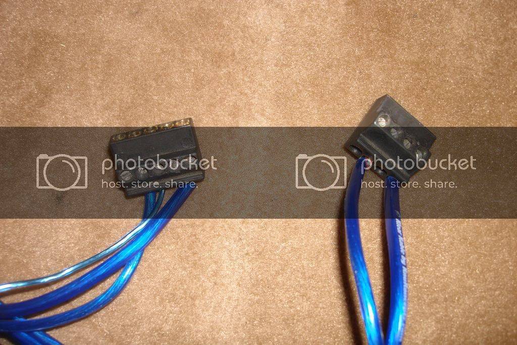

Well I bridged my PPI pc 4400.2 and ran it off the ouputs of my sax 100.4. I used some y- cables to connect to all 4 channels. Amp is wired to do 200 x 2 @ 4ohm, I checked the ohm load with my dmm and they are wired fine.

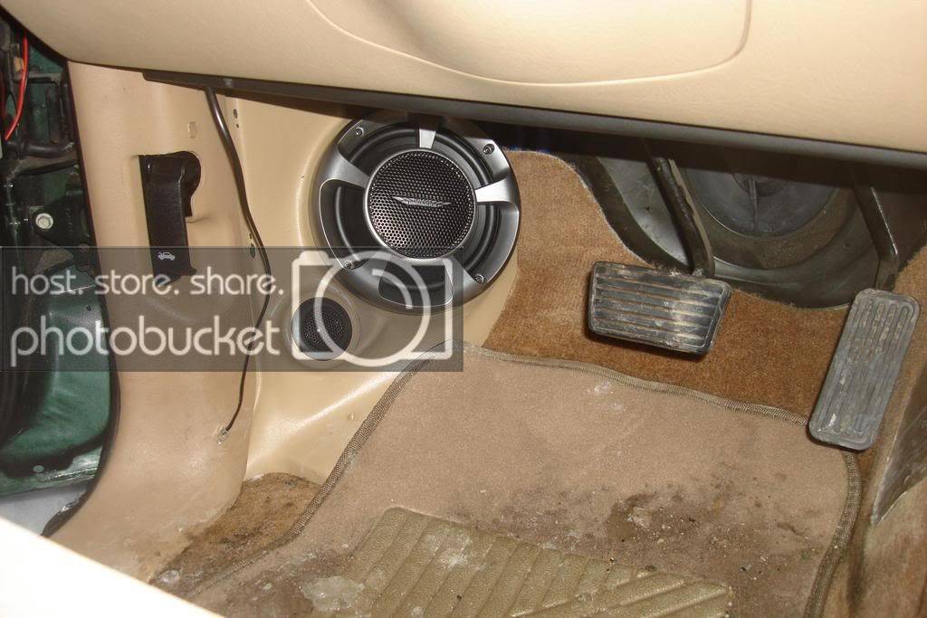

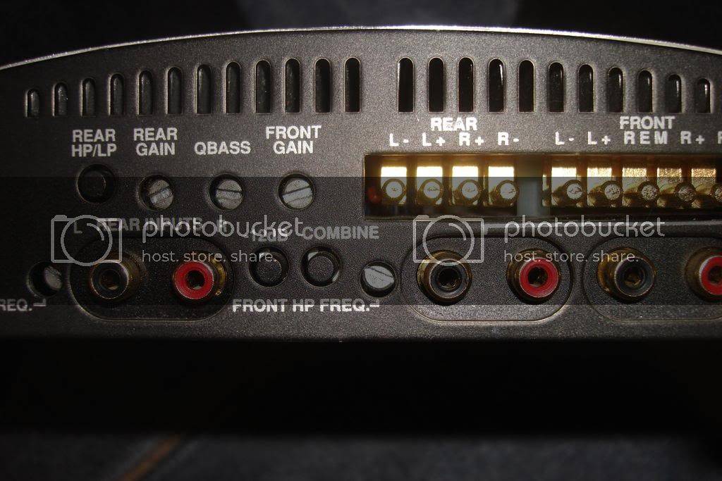

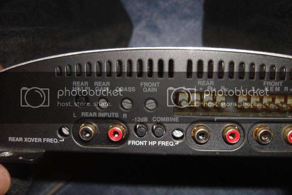

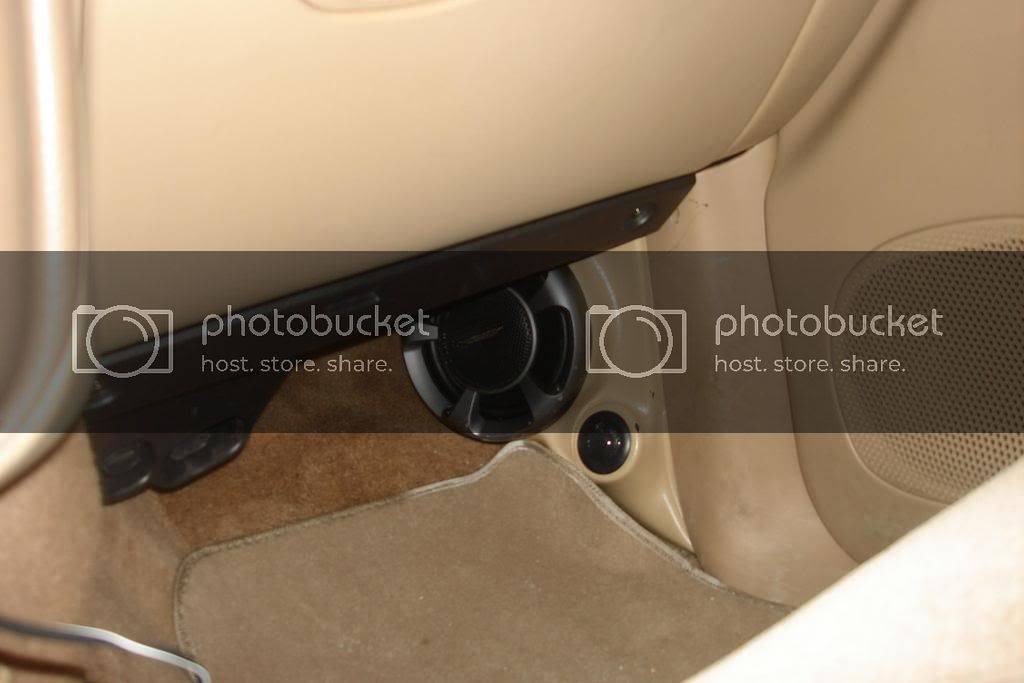

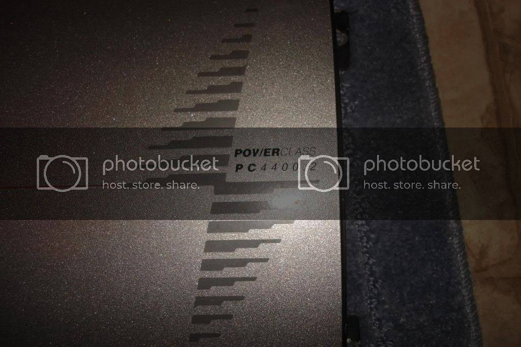

Here are some pics, of the kick panels and the amp end with setting...lookin to get help on what to set things to. Thanks guys.

nice kicks
thanks, but worthless if I can't tune em right //content.invisioncic.com/y282845/emoticons/crap.gif.7f4dd41e3e9b23fbd170a1ee6f65cecc.gif
the kicks are nice tho, solid, and fit well...hopefully I get to see how bad the ID's make em rattle...but they should be good

there is a pic of the amp above...thanks for all this help
