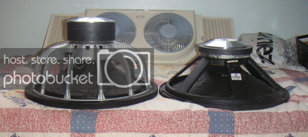

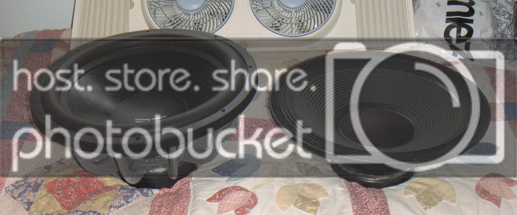

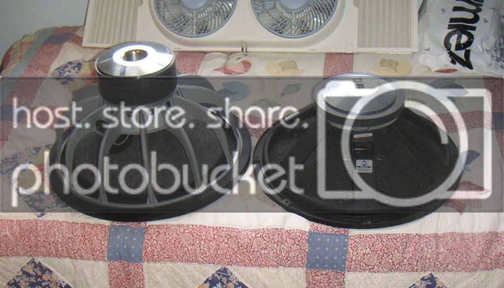

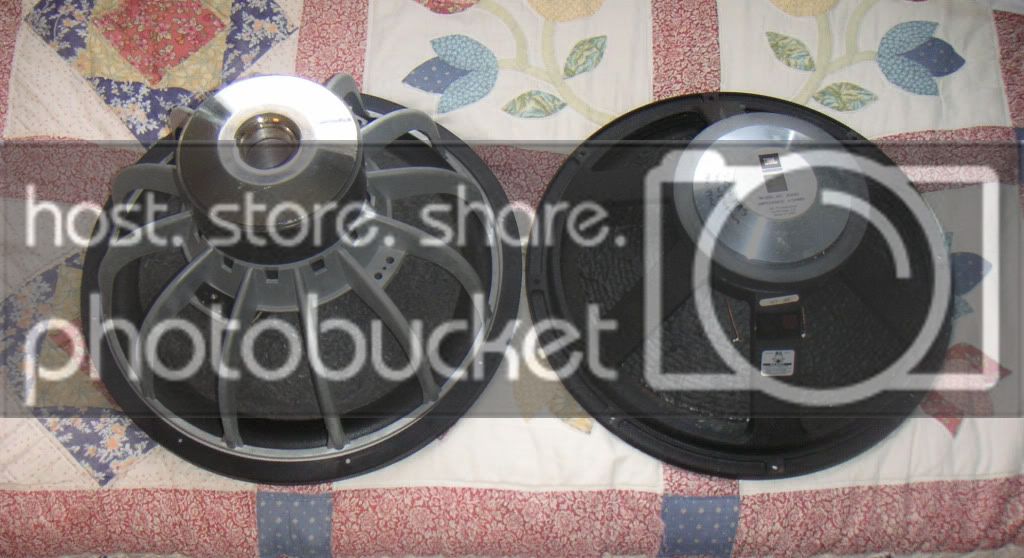

I had a pa speaker in my car for a bit. then got a real car audio speaker.
here are pix of both together.
the pa speaker is a 18" JBL model # 2043G = 400w rms power = stupid sick loud on that power level
car audio sub = re sx 18 = 1000w rms power = way more x max than pa sub. like 15mm more
resulting in harder hitting deep in your chest bass.
as the pa speaker played all the notes verry acurately and clean - it lacked the in depth punch that you feel deep in your chest bass vibrations from. - the re sx 18 nails them tho.
musicly - the pa speaker is way cleaner / like hands down no contest.
