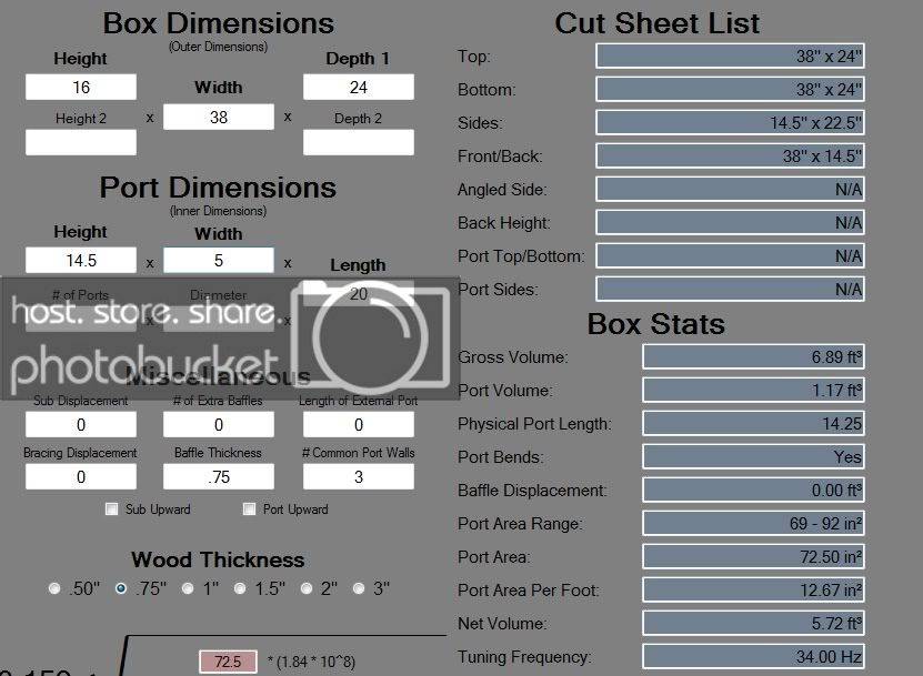

You should be able to get away with a little over 5 cubes for a pair of Type R 15"s (after sub, bracing & port displacement of course).
Four 3" aeros shoud get you to 30-ish Hz pretty easily, but you'll want someone a lot better than myself to verify whether it's enough port area.

This should work if you can fit it. Subs/slot port back.
for starters ive got a buick lesabre(similar trunk i believe. i can squeeze 38.5 wide 18 tall and ~27 in deep. right at 9 cu ft before all displacements. so in reality your looking at about 7.5 or less cubes assuming you can find same space. sealing off the trunk not so bad, just really make a "wall" with cardboard and use some great stuff the expanding foam stuff. //content.invisioncic.com/y282845/emoticons/smile.gif.1ebc41e1811405b213edfc4622c41e27.gif easiest way.

- Alpine recommends 1.5 - 3 cubes for a Type R 15", so that'd be 3 - 6 cubes for a pair. 5 (or a little more than 5) would be within those recommenations.
- If 5 cubes is okay, and according to Alpine it is, four 3" aeros should be sufficient to tune to 30Hz.
As I said, I'm not great at getting loud, but my recommendation is okay according to Alpine. Their recommendations could be bullshit, though. If that's the case it really doesn't matter what I say.
