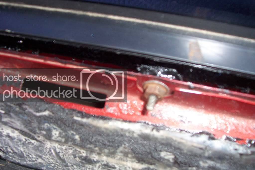

A few months ago my rear window seperated from the frame and it rattles like crazy and sounds horrible. I don't want to just replace it with another stock window and have the same thing happen again. What would you guys do in my situation? Would a lexan window flex less? Thanks.
There is a tab on the back of that bolt and it connects to the rear window. The flexing of the window must have disconnected the window from the tab. I want a permanent solution that still allows me to have a rear window. So sheetmetal or anything else that isn't a window isn't an option. Truck is a 99 Ranger by the way.
some sort of sealant and pressure on the back of the window while it dries is my .02 cents
I tried some JB-weld but I didn't have anyone with me to put pressure on the glass. I'll give it another shot with someone's help I guess. I've also seen people use gorilla tape on windows to cut down on the flex. I could apply it to the outside of the window where it meets the frame, you think that'll help?
It is completely seperated along the bottom. I can put the slightest pressure on it and see outside inbetween the window and frame.

This is what I can think of.
Get some 1/2" Lexan cut to fit the window frame. Run some weatherstripping all around. Make 2 supports going from top to bottom but not to obstruct your rear view. Then either bolt or rivet the window into place and along the supports. I'd imagine it would still flex a little but not near as much or sound like complete shit when it does. From looking at that pic, there seems to be a big enough flange of metal along the frame that you could get everything in nice and neat.
