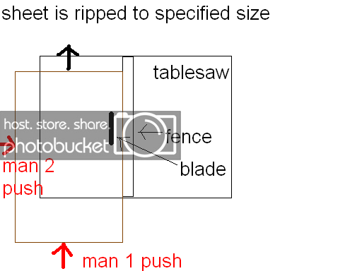

thanks,as far as the table saw maxing out at 36 inches all you do is set up some sawhorses on the end of your table saw where wood comes out level with the table saw itself. Have one guy push in from the side while you push through and you'll get a perfectly straight cut with a pretty **** long piece of wood. Ive done it before with 6 foot long sheets of wood

heres a quick rough diagram of what im saying to do.
How would that not work ive used this method several times before with no issues at all.Not trying to be stubborn or douchey i just dont quite get what your saying
Also when you say your table saw maxes out at 34-36'' are you talking about its length? because you can just keep pushing the wood after it goes off the end of the table saw as long as you keep holding it properly which can take more than one person if its large.
I see what you're saying but I always work alone so having a second person push isn't an option for me. I wasn't referring to the length, I have several roller stands and an outfeed table, I was referring to the "rip capacity" which is the largest cut that you can do to the right of the blade (accurately, with the fence square). If the 2 man method works for you and you can be accurate, then that's great and you should use it, just not something I can do.
