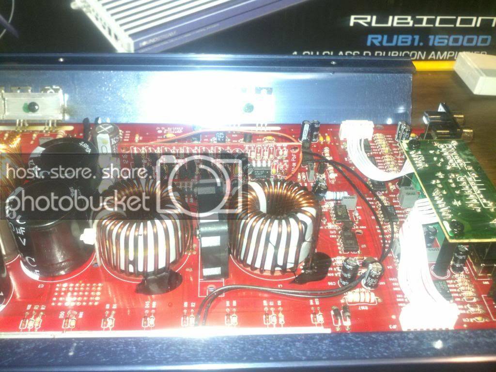

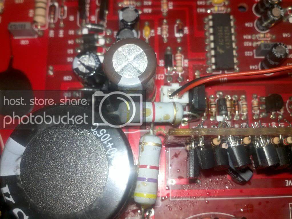

I recently ordered a Soundstream Rub1.1600D from OnlineCarStereo, upon install it is an amazing amplifier! it is the best amp i have owned so far. Just yesterday i was playing a few tracks and i got out of my car and all of the sudden the bass just cut out. I got in my car and heard this weird noise from my subwoofer, i got out, opened my trunk and my sub was making a weird noise, so i turned my car off for a couple minutes and turned it back on. Still no bass. so i went and checked the amplifier and it was in protection mode, a couple seconds passed and poof, all this smoke came out from the amplifier. i know it was not my subwoofer that blew because later i pulled it out of the box and everything was fine. Anyways as soon as smoke filled my car i freaked out and turned my car off immediately and disconnected the negative battery terminal and pulled the amplifier out of my car. I am not sure as to why this happened, but i set my gains with a DMM with a 50hz test tone at vol. 36 and i listen to it on 34-35 just before it starts to clip. I dont know as to why this happened, but i just got it a couple weeks ago and i have not been pushing it that hard at all. Is there any way i can send it in to get it repaired or a replacement amplifier? I would really appreciate a response as soon as possible! Thanks!

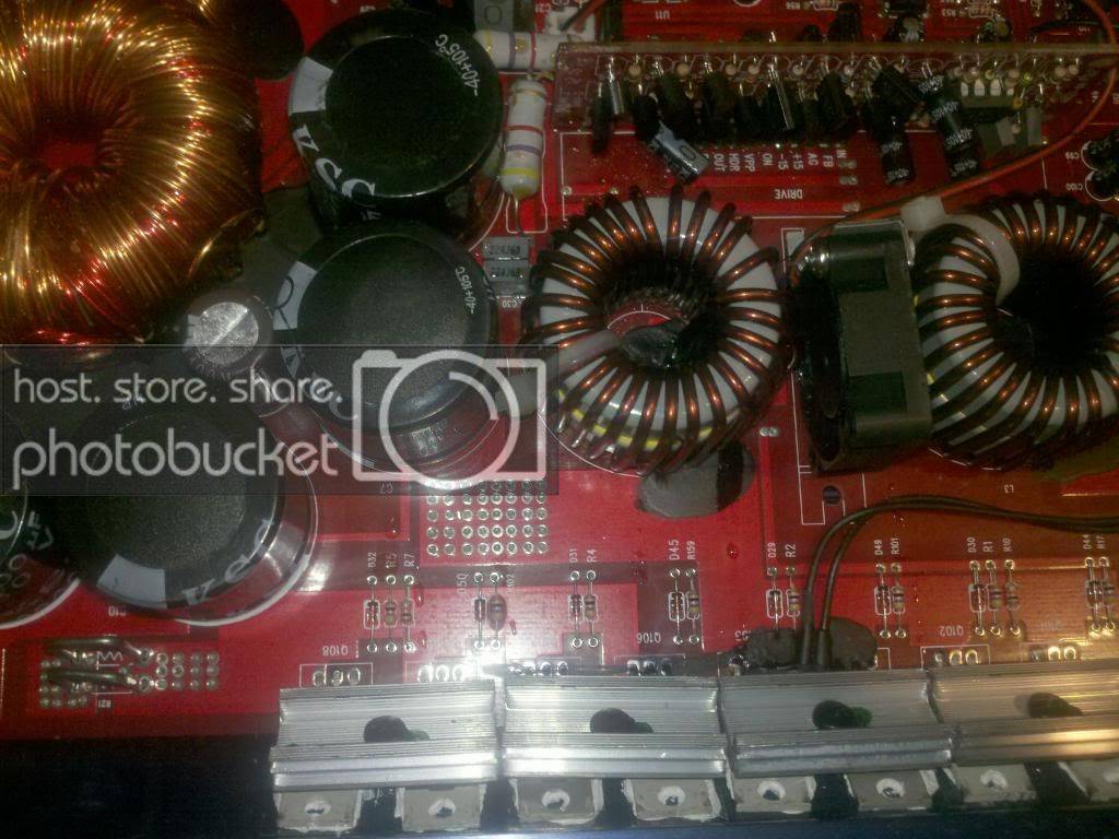

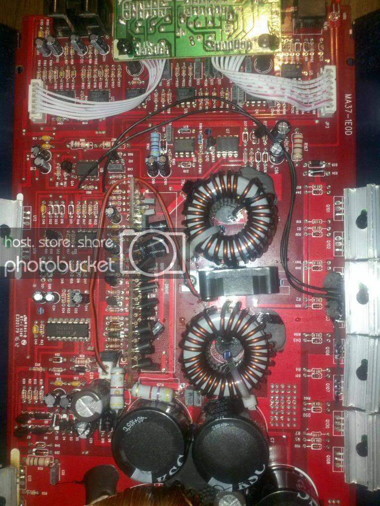

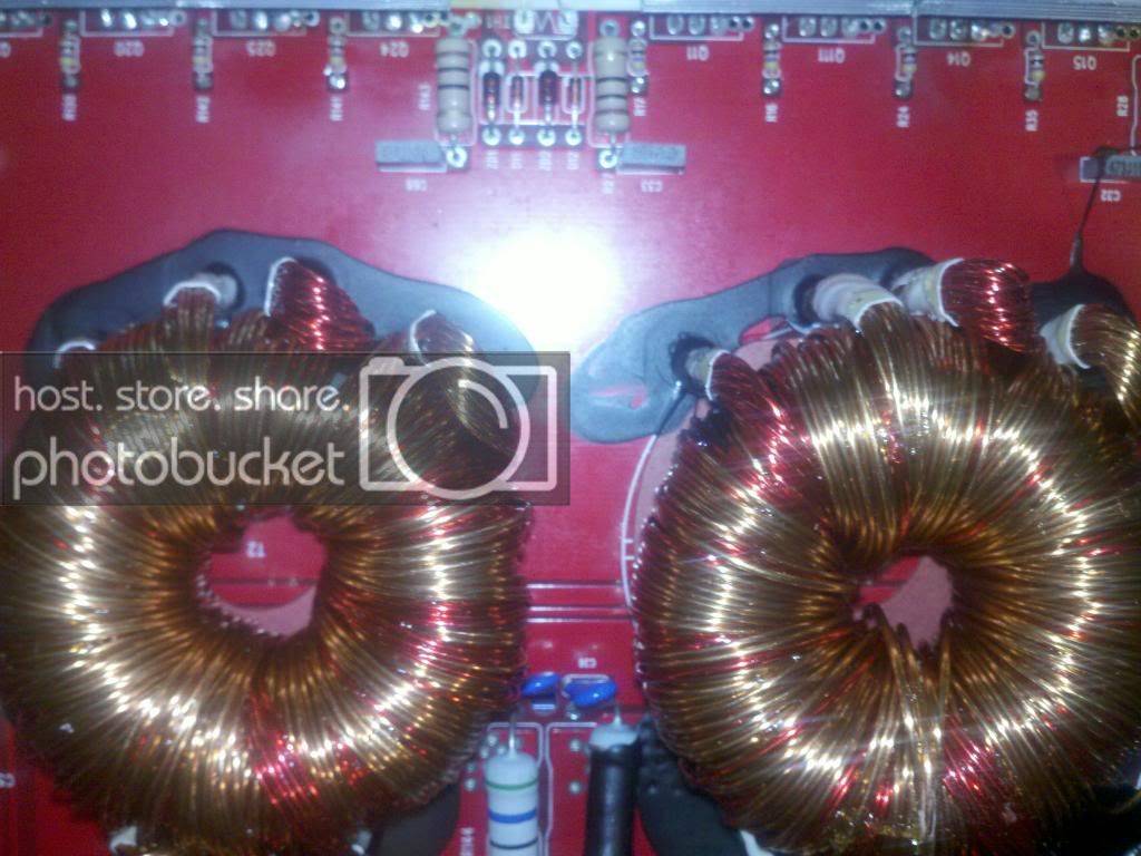

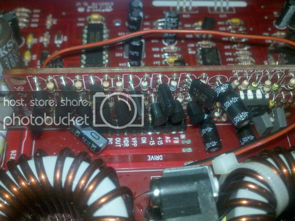

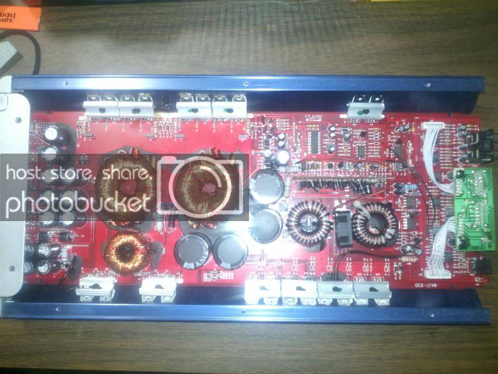

From pics it looks like it got wet shorted the ic bored that fried the fets
When i opened up my amp and checced it out i saw that wet soda looking liquid on some of it. Honestly idk how it could have, the sub is facing trunk lid and box is all the way bacc against the bacc seat and the amp was mounted on the bacc of it. Oh and by the way i took out the bacc seat to clean up my wires and ****, and just left em out of my car
Back window gasket. Check under your carpet for moisture.
Are you talking about the carpet on my enclosure? I never carpeted my box after i built it. So it could be that the bacc window seal has a leak? All of this happened after i washed my car. I was bumping it pretty hard when i was drying my side windows and put some suff on my wheels that makes it look wet. Think maybe when the bass hits it opens up a tiny cracc on the seal around my bacc window? I really want to diagnose the problem in order to prevent anything like this happening again in the near future.
