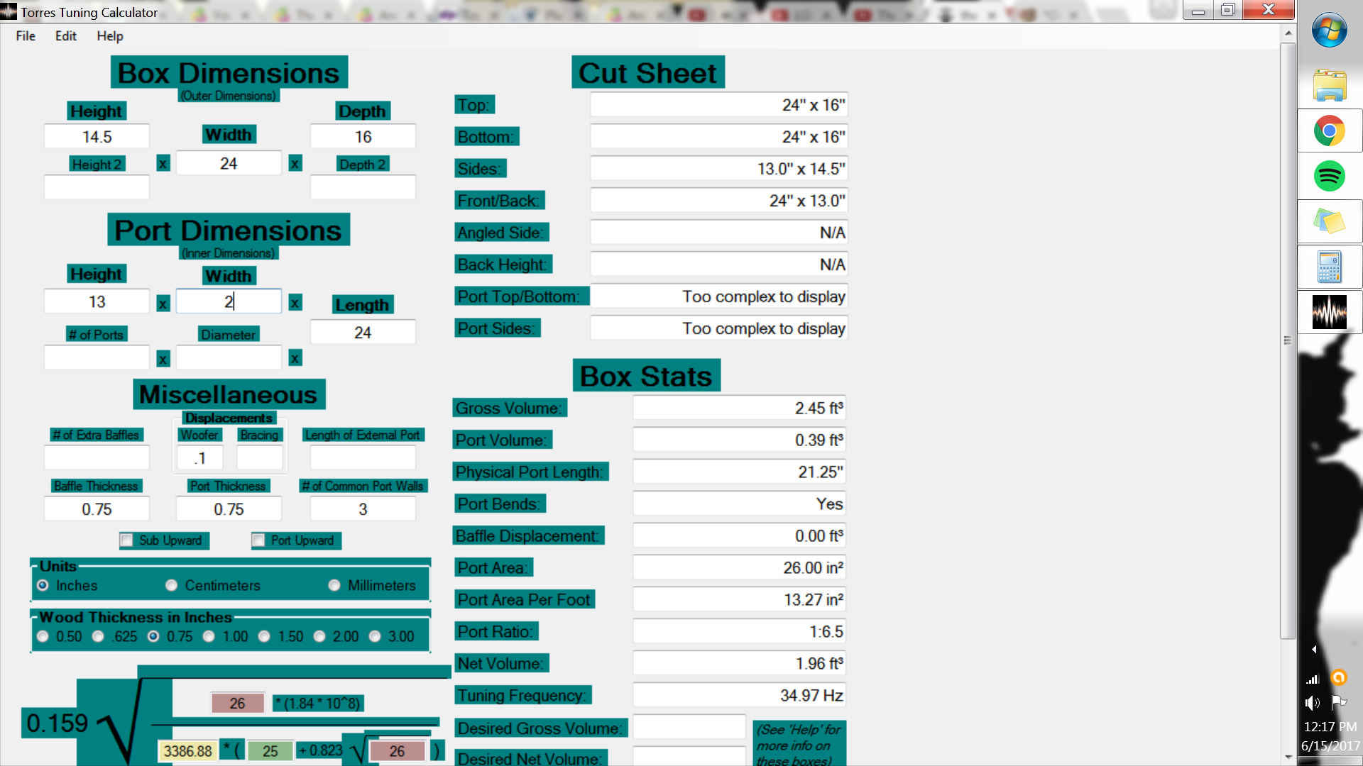

I think I finally got it if you guys want to check out that box that's the one I'm using for my sa12 right now
dude thats a horrible box design. The port takes up space as well. You are around 1.5 cubes after displacement tuned to 50hz. Your port is WAAAAAY too big causing the sub to unload its no wonder your sub is smelling. Its crying for help you'll kill the sub in that box
normally people shoot for 12 to 16 port area per cubic feet, you are at 35. 18 will already cause issues but 35... holy sh*t.
14.5 height 24 width, 16 depth and 13 port height 2 port width and 24 port length will get you closer to what you need.
Box looks pretty good by the way.
have you even ran the numbers? ITS HORRIBLE. Its well built for sure but the design is causing the sub to self implode. Its literally a burp box

yeah whereever you learned to design that port, its completely wrong. That is more suited to a high displacement 15 inch sub or a pair of 12s and the airspace needs to be a lot higher as well, your airspace tiny after displacement. You have to account for the space the sub and port takes up. sundown has box designs on their website or get one of these 2 cube 35hz boxes

If you want to do it yourself, Model the sub out on winisd and design the box with torres box calculator.

idk about that i haven't checked tuning, i will but yeah that ports a little big of that size box is if is 1.5cf ad 2.5" w woulda been better.. i'll check tuning but for safety u can set s filter at like 40hz.. brb
Your guy's advice would be to take it out of that box immediately?
laright man if box is INTERNAL 23.75 wide X 14.5d x 13.5h (internal) and port is 13.5x4" x 26.75 long it's tuned at 52hz., thats even high for comps.. see with port that big it with the sub disp. takes up 1 cf of the box, if u woulda made box bigger or port 2" or so as jeff said u would be right.. good news is box looks great just do another one with smaller port and that sound small to me if sa 12 i thought they needed bigger box but idk how much power u running and all., just check with us on port and box side before u cut wood.. and yeah i'd take sub out, i had a prefab box tuned to 60hz (15yrs ago before i knew about them) cones ripped.. set ss filter at 50hz until u get another box.. u would actually been better off to buy box like mine but 2cf at least it would be right sized and tuned right they $75..
