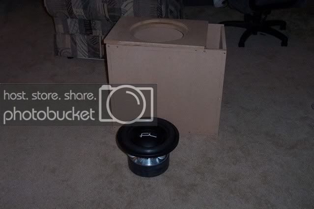

smurf blue tc4hp. has the doubled up tensil leads (not in the pic, this is before it was redone.also the old style fat foam surround. currently working on the electrical before its time for teh enclosure. it'll be 6 runs of 1/0, 2 powermaster d3100 bats, and a 220amp ho alty. all into my lil vw golf hatchback //content.invisioncic.com/y282845/emoticons/smile.gif.1ebc41e1811405b213edfc4622c41e27.gif it's gonan be a few months before i have enough funds together to get what im looking for. but if things work out nicely ill be getting loud //content.invisioncic.com/y282845/emoticons/smile.gif.1ebc41e1811405b213edfc4622c41e27.gif

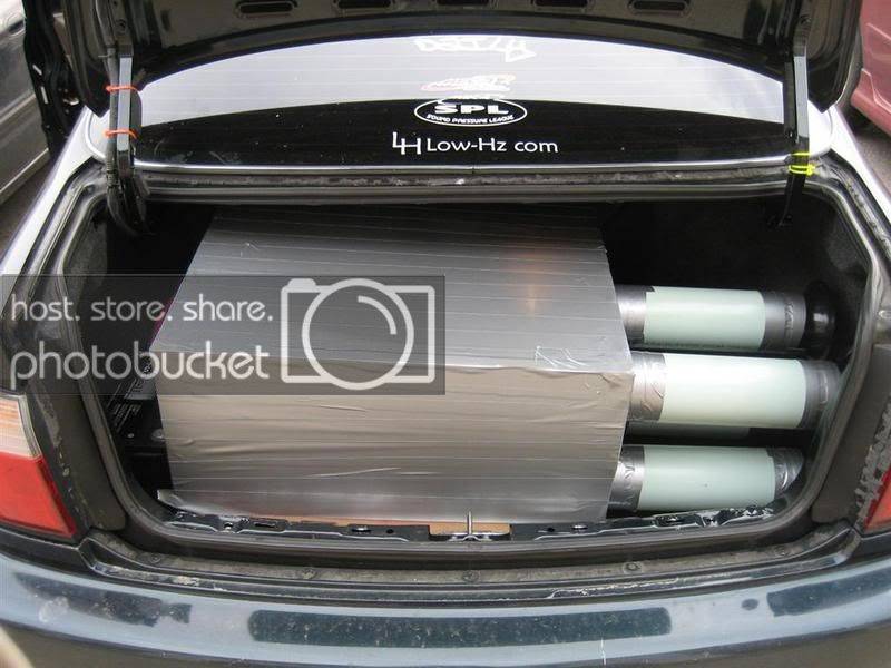

I had my ports towards the driveres side and it was loud as hell. I think that design kicks butt in pretty much any trunk car. 4 cubes tuned to 38 hz, with about 1800 watts to my TSS 15 I could make my back door flex from about 8-10 feet away. Did a 142 legal with a CVR 12 with a sub facing forward and ports to the side also.
Seen in some other pics u had the ports aiming at driver side....notice any diff of the 2?
You won't be able to hear the difference, but the mic will. The ports were on the drivers side in the other pics because I flipped the box around for drive-by at finals and never turned it back around.
Sub driver (facing forward), port passenger is the loudest most of the time in trunk cars. Like I said above, you won't hear it, but the mic will //content.invisioncic.com/y282845/emoticons/wink.gif.608e3ea05f1a9f98611af0861652f8fb.gif
