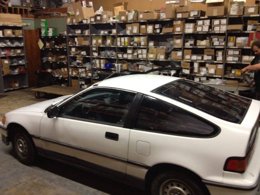

The testing grounds:

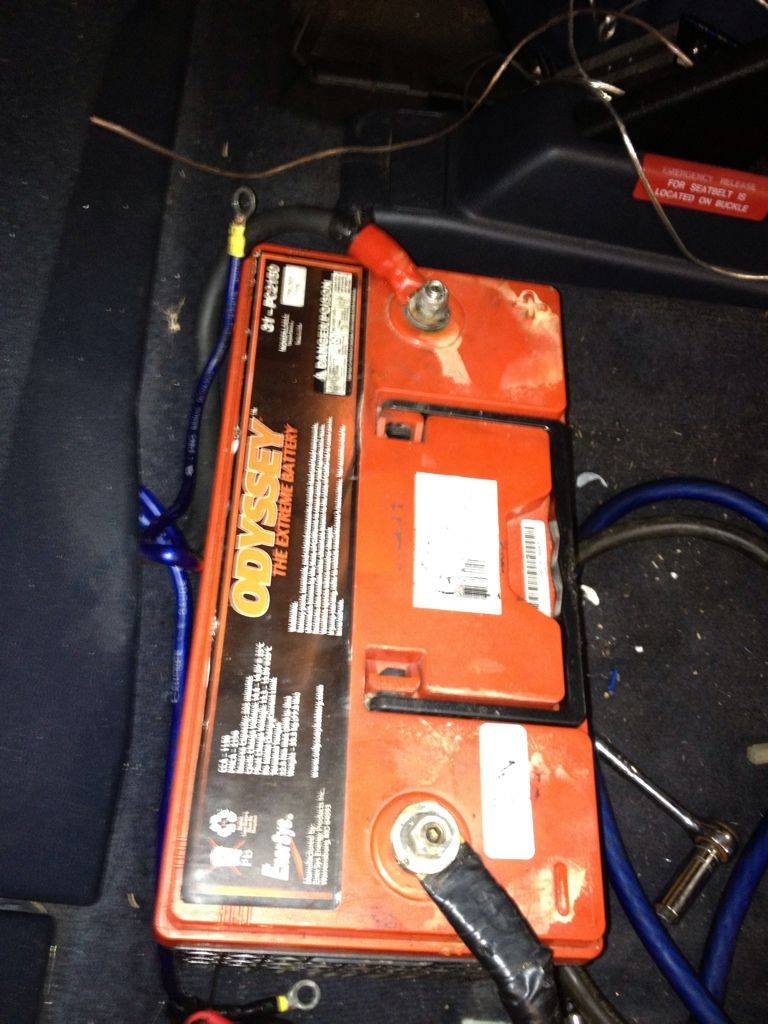

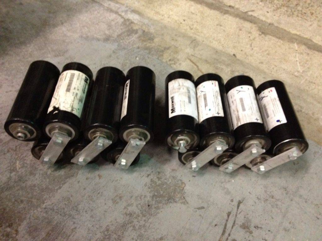

The juice. 12v and 15v respectively:
