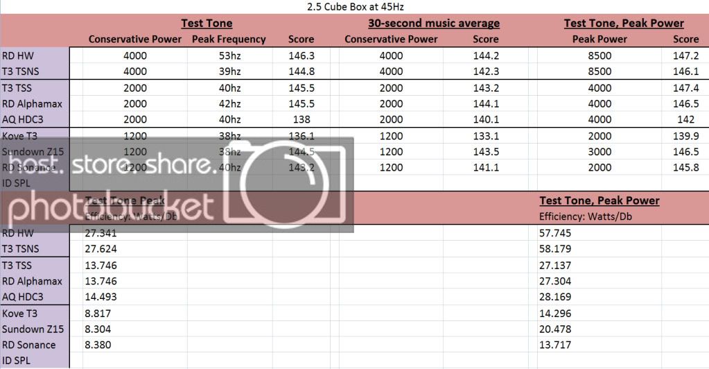

Teh results are up if anyone is interested! I found them quite interesting //content.invisioncic.com/y282845/emoticons/biggrin.gif.d71a5d36fcbab170f2364c9f2e3946cb.gif all subs seemed to perform well.
2.5 ft^3 testing :

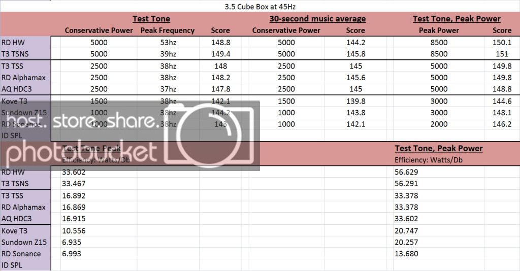

3.5 ft^3 testing :

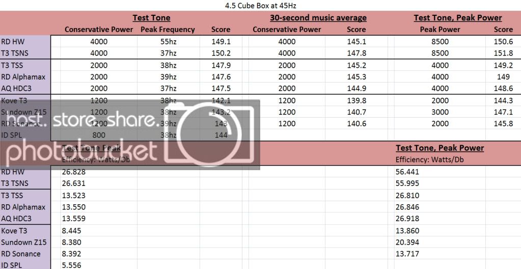

4.5 ft^3 testing :
Random Notes by Bumpin :
"TSNS on 2600wrms put up a 149.8 in the 4.5cube box at two sanctioned dbdrag shows
ID max put up a mid 144 in the 4.5 cube box off just under 800wrms on a memphis amp, as a joke. But it was at a sanctioned event and is a verified score, amp blew shortly after though when I tried a 25hz tone, it did 30hz fine.
HW can take 8500wrms at 20hz and still keep great linear throw.
AQ HDC3 held its own for a copper used sub
Kove was beat and did about what was expect out of it, got really stinky though at higher power, and really fast
TSS loved 3000 all the way up to about 5000, tried 8500 though and it got stinky on a burp but that was expected, still works flawless though.
Alphamax was a great all around SPL sub and daily beater, can take a lot of abuse and I could stand on it as well as the HW. So built strong.
Z15 wins my award for best sounding thus far. in the 3.5 at 38hz it was so clean and crisp. I know this is mostly judged by ear but anyone who heard it could agree.
More subs coming for testing as they get in"
