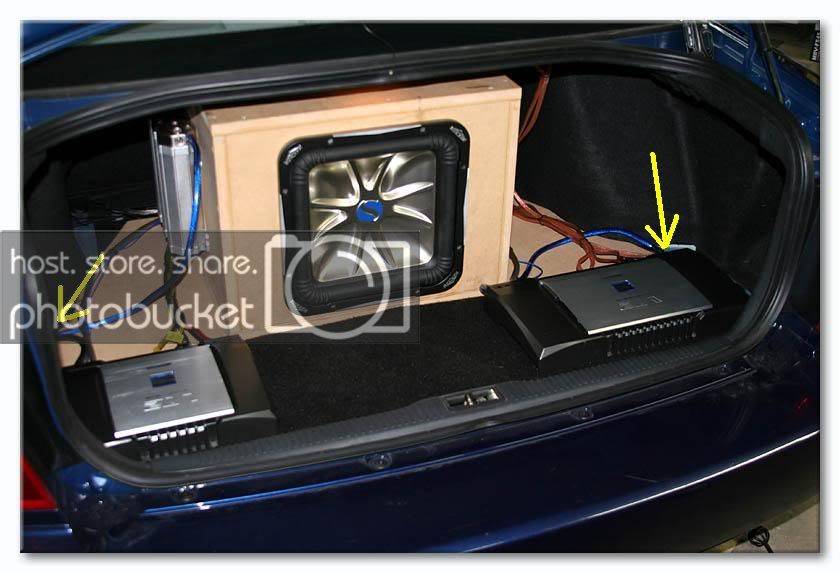

Here is what I did. Hope this helps.
Distro Block location:
My ground points:

try regrounding you HU
i see one problem with that..you are using 2 different grounding point for your amps...that can cause some noise issues in the system, its best to ground all amps to the same grounding point. best place IS the frame of the car. if your car is a unibody, the best grounding point will be the negative terminal of the battery under the hood.
