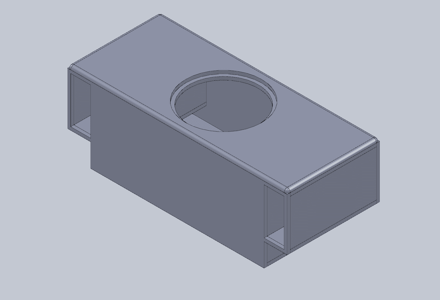

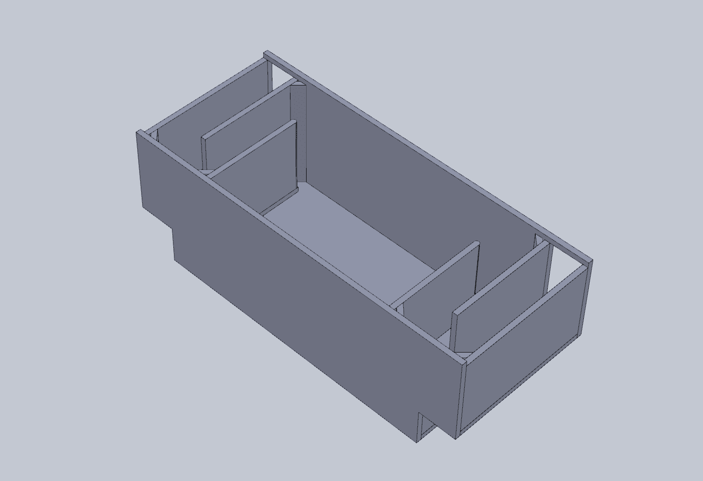

The box is 52.25 at the top and bottle necks down to 42.25, the actual box is 41.25 x 18 x 22. I'm not going to bother explaining port displacement, just know that the box net is 6.5 cubes tuned to 31hz
port is 4.75 x 22 x 37 divided into two ports each measuring 4.75 x 11 x 37, giving the box a 31hz tune.
I am going to fillet all of the outer edges, and some of the inner ones, I'm going to draw up some 45's to reduce the likely hood of dead zones under those port over hangs, and there's going to be a large plexi window.
I'm already dreading building it.
Looks lovely, but yeah, building it will be a chore. Haven't seen many boxes with the ports over the wheel wells like that. I really like the design.
Thanks man, yeah I wanted to do the port on the bottom, but It would have interfered with the sub so i had to do it on the sides like that, glad you like it //content.invisioncic.com/y282845/emoticons/smile.gif.1ebc41e1811405b213edfc4622c41e27.gif
hoes be stealing my designs
Phoenix risen's box is complicated like this too. we built it with cut outs to compensate for his batteries. HAPPY BUILDING is all I can say. I hope you have a table saw.
nope, I have a skill saw with clamps and a 4ft long level.
