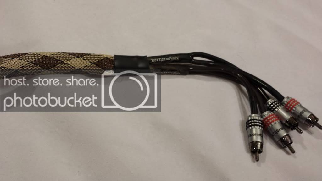

In this thread I would like to share my process for covering a wire in techflex as well as some of the techniques I have learned for working with it. In this example I am going to be bundling two RCA cables together to make a 4 channel run that is tied together at one end and seperate at the other.

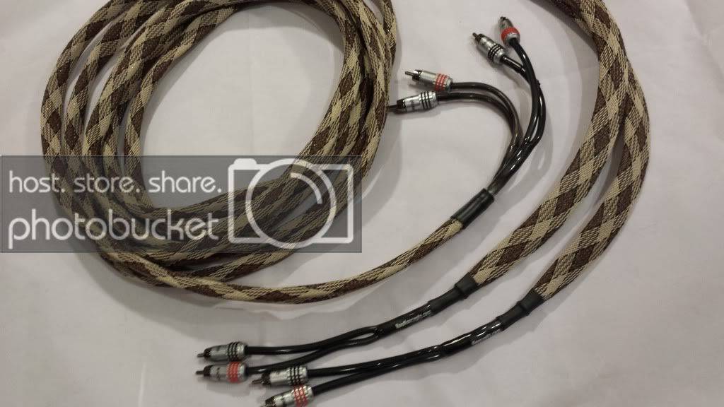

It looks like this when complete:
Lets begin:

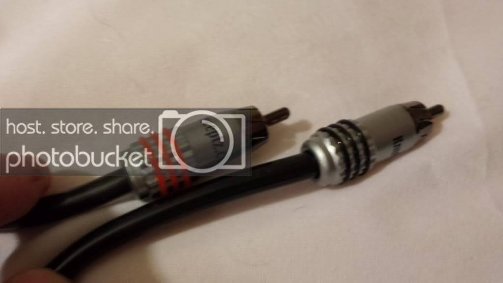

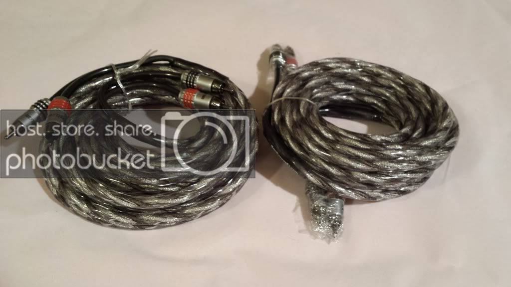

To start I prepare my wire and tech flex. The wire I am using is KnuKonceptz:
I find that I have to use .75" Tech Flex for anything RCA's. For other size wiring follow the following chart:

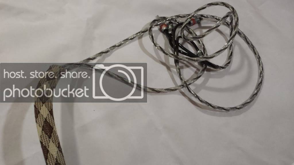

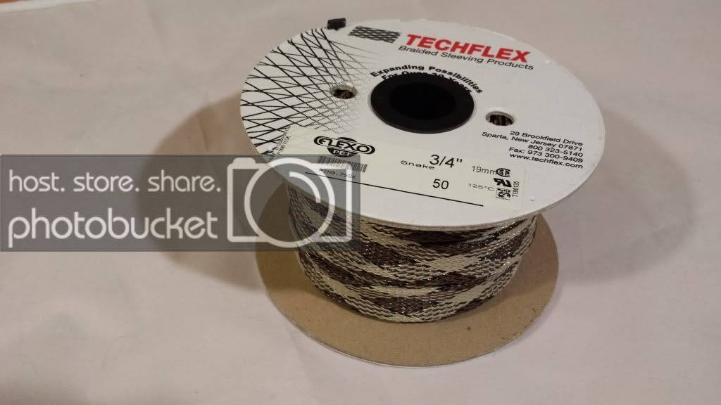

Here is a spool of the 3/4"

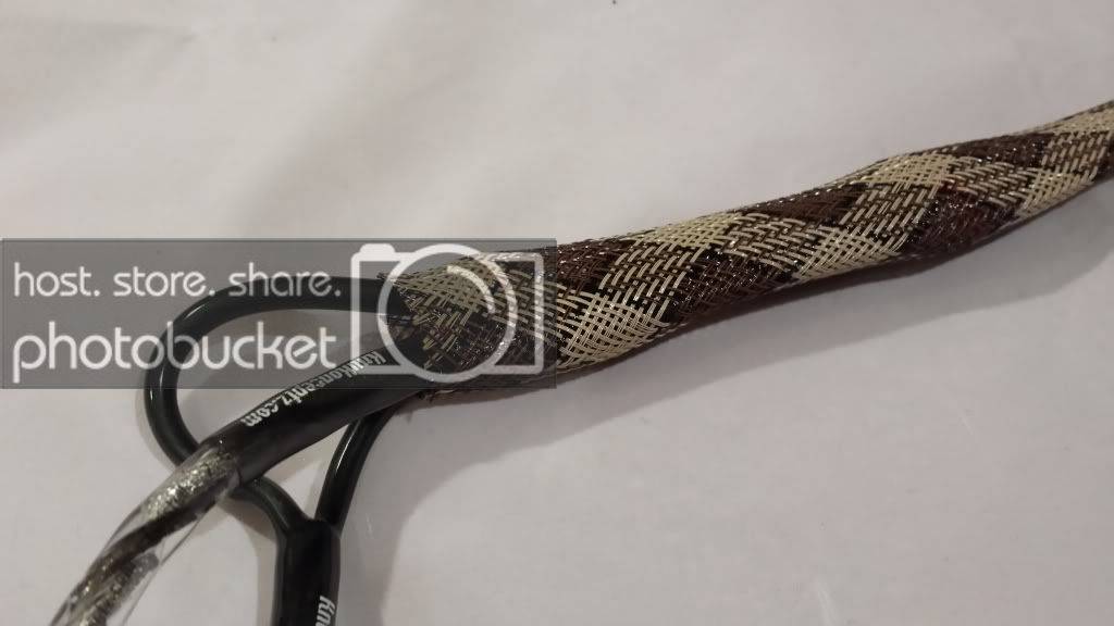

In order to begin sliding the RCA's through I hold them like this. It may help to actually tape them together like this. Also if you are running multiple separate wires through you will want to tape them together temporarily.

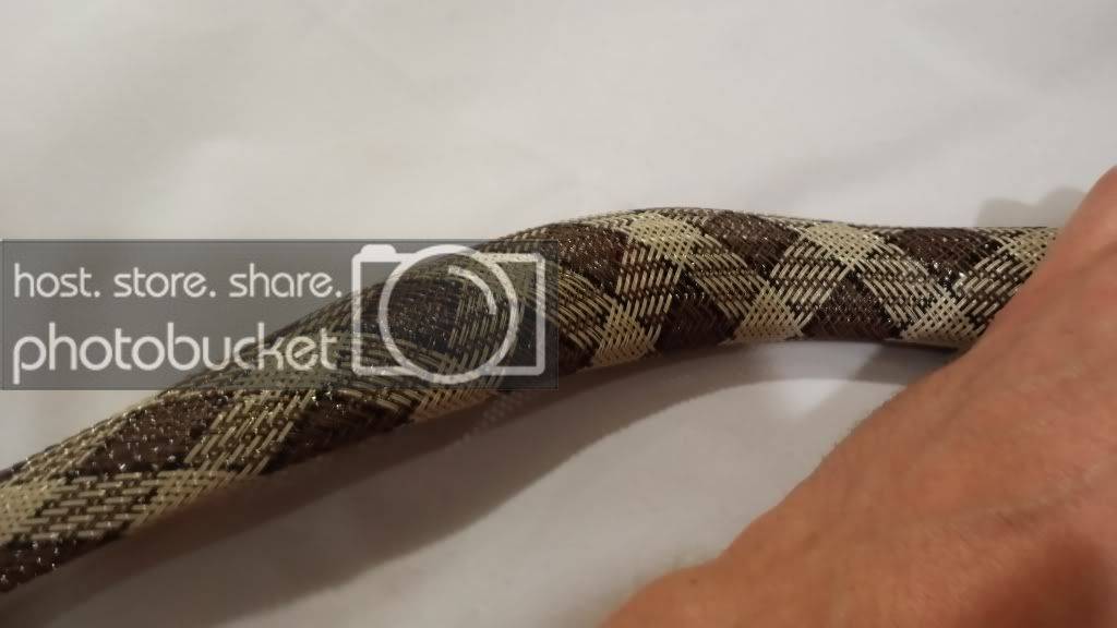

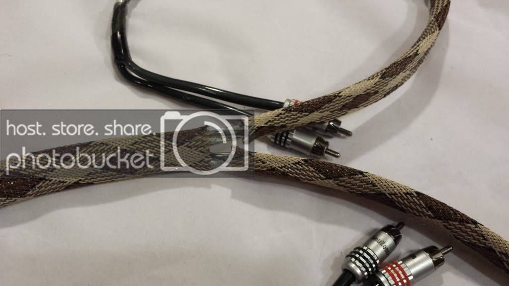

To begin passing the wire through I bunch up the techflex and then allow it to pass over the wire. Like this:
This is shown better in the video link that I will post below, but you get the idea. As you work down the length of the wire with the swollen section the techflex will move down the wire. You will have to do this multiple times to cover the length of wire you want to cover.

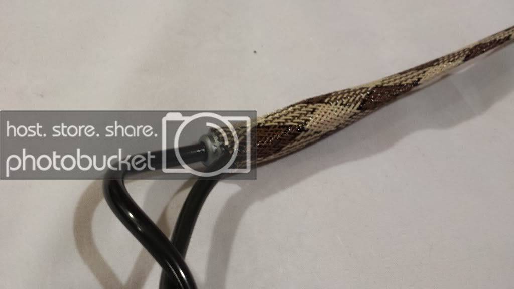

Once I got to this point I stopped because i wanted to have the RCA's be able to separate based on the locations of the amps. I did not cut the length of techflex before starting because with the expansion of the techflex itself the length can change. Its best to apply it then cut.

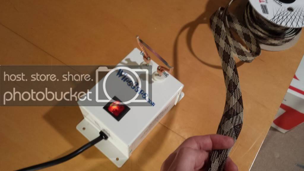

Now its time to cut the techflex. I have a nice heat knife I use from WireCare.com :: Your Cable Management SuperStore! but you can also heat up an exacto knife and use it. This is shown in the video. You must use one of these methods or the techflex will fray, the ends must be melted to each other.

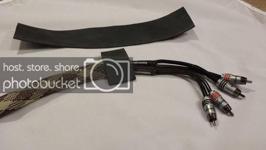

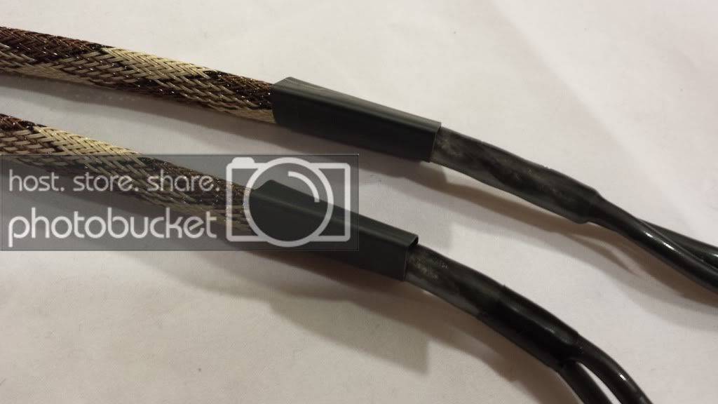

With the techflex cut I am now going to terminate the end where the RCA's are close to one another.

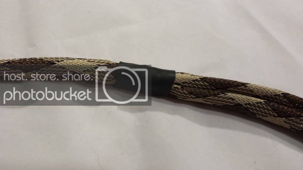

I cut a 1.5" length of 1.5" heat shrink, and shrink it to size:
Now we have this end to clean up:

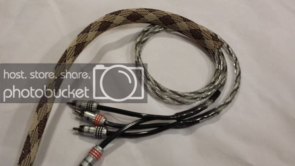

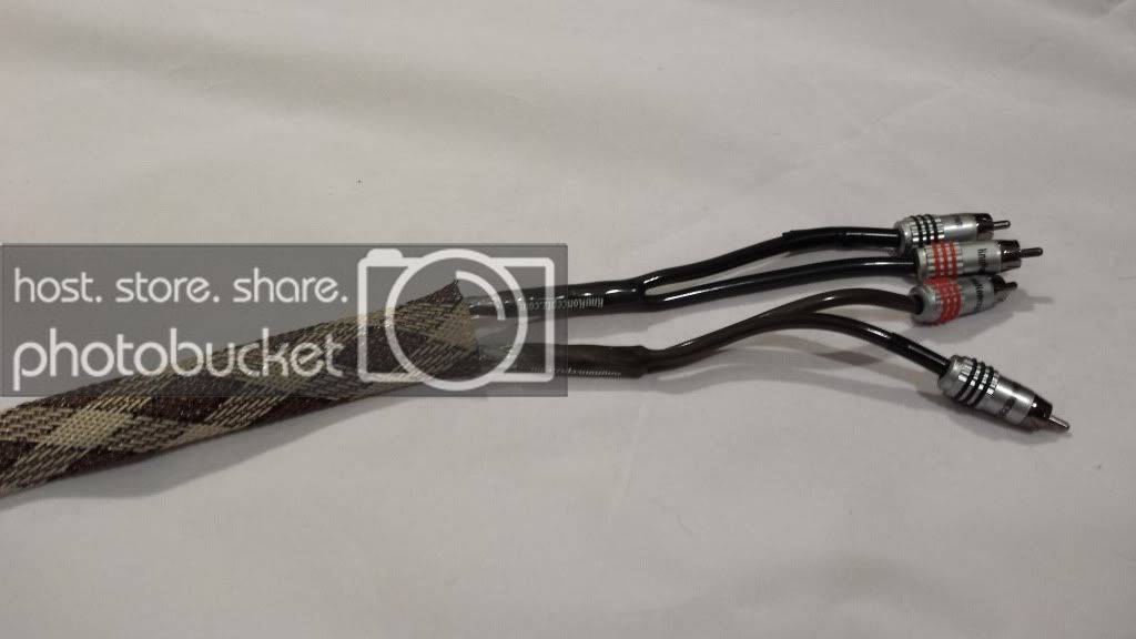

I put two more lengths of techflex over the separate wires like this:
And once again cover with a 1.5" length of techflex:

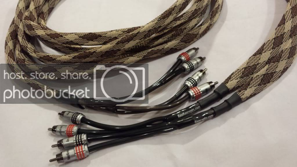

Now all that is left to do is terminate the seperated ends:

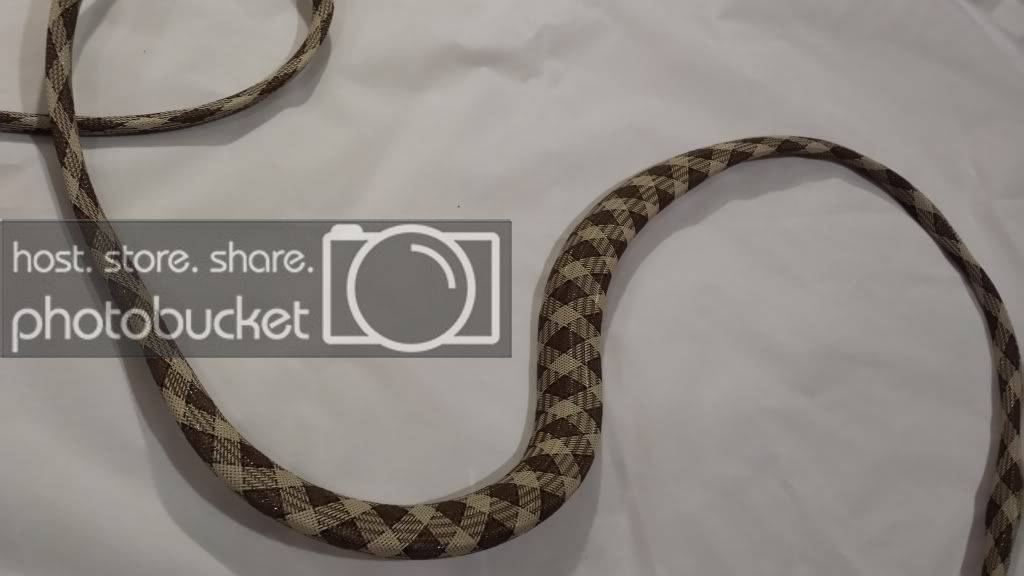

And here is our finished product!

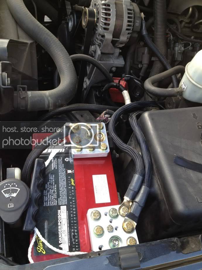

But great tutorial! Love your use of the heat knife, this stuff loves to fray and can be real tricky if you don't stop it in time. It's also not very heat resistant, be careful with any heat sources. I burned part of it when I got careless with the torch putting the heatshrink on.
Way ahead of ya bro //content.invisioncic.com/y282845/emoticons/wink.gif.608e3ea05f1a9f98611af0861652f8fb.gif

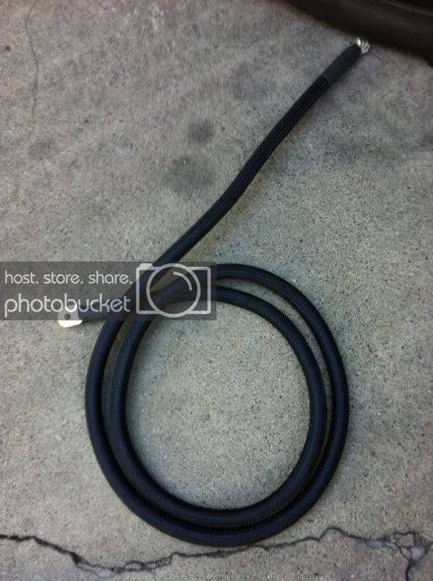

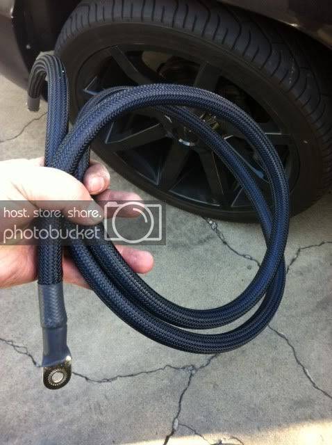

Who makes the terminal on your battery?
