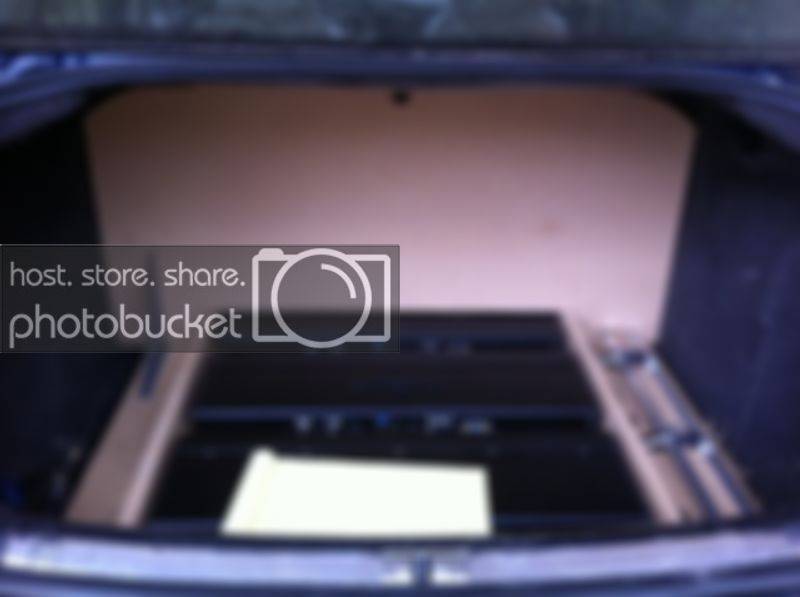

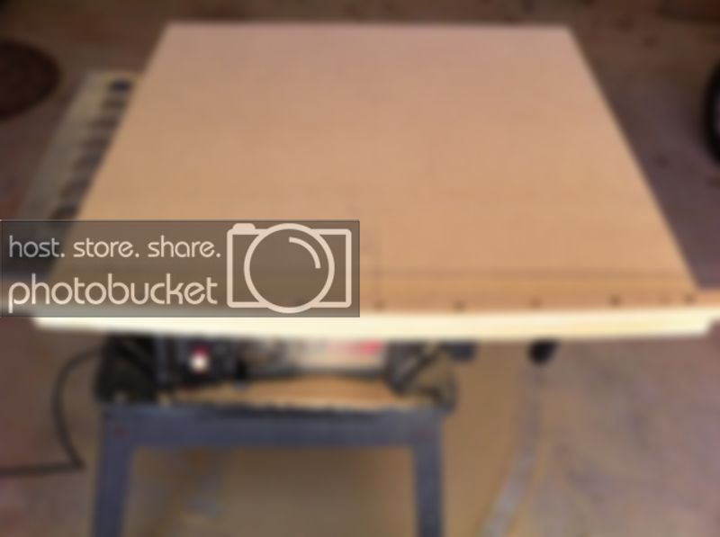

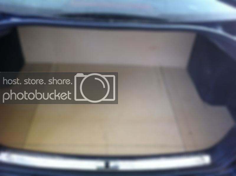

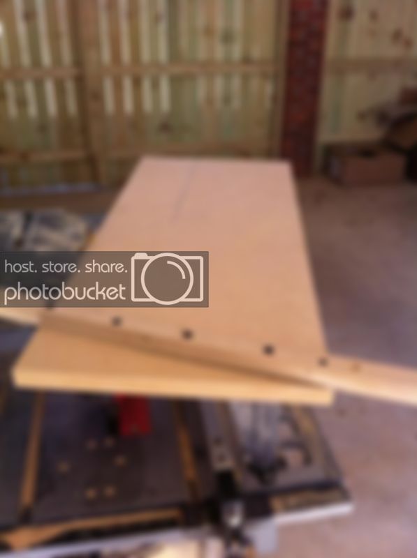

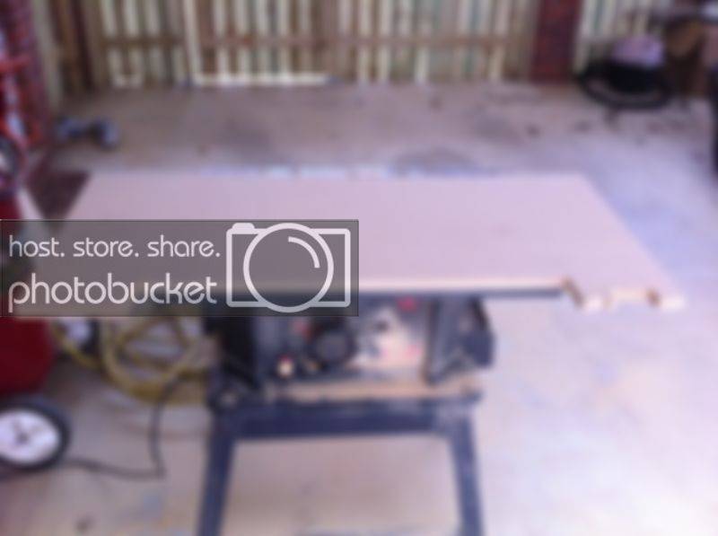

I build the back trunk panel.

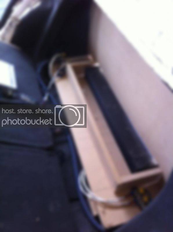

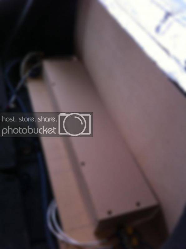

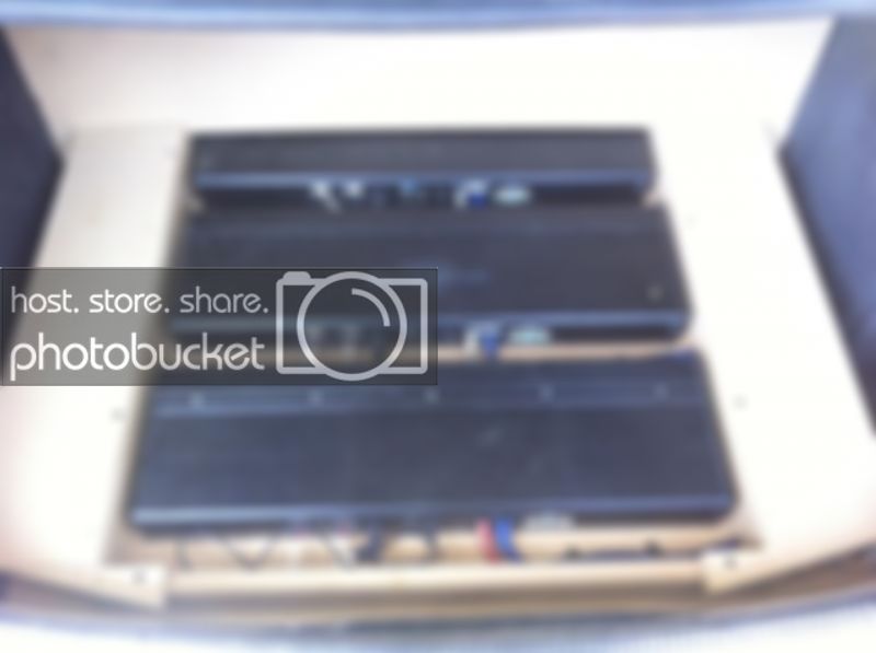

Here, where you can see the top of the third amp, this is where the panel will be that houses 4 fans to cool the amp rack.

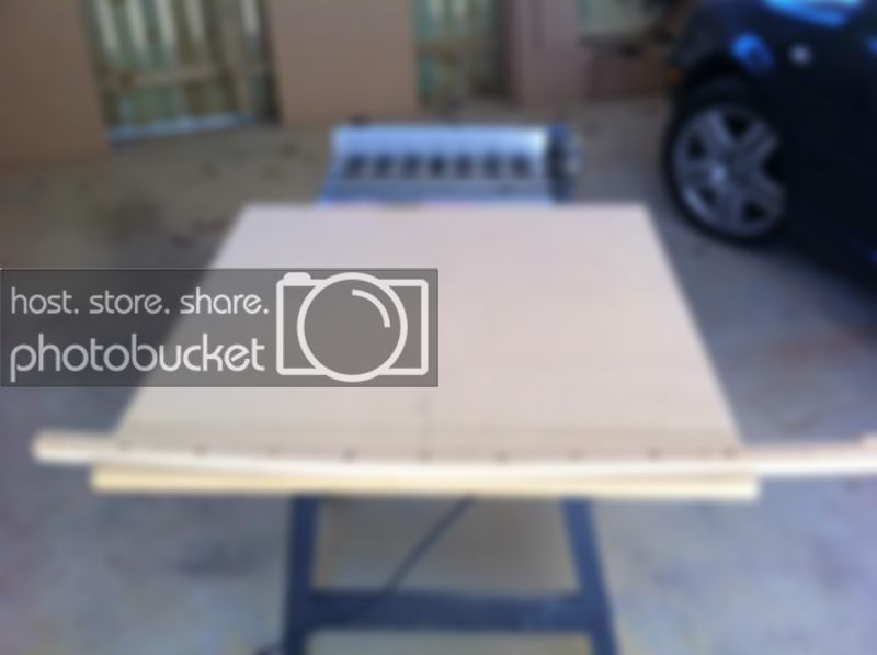

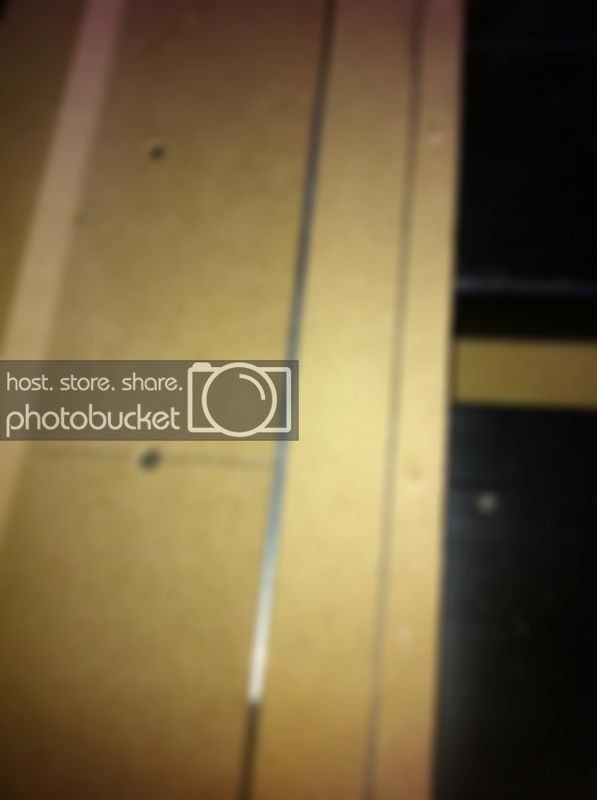

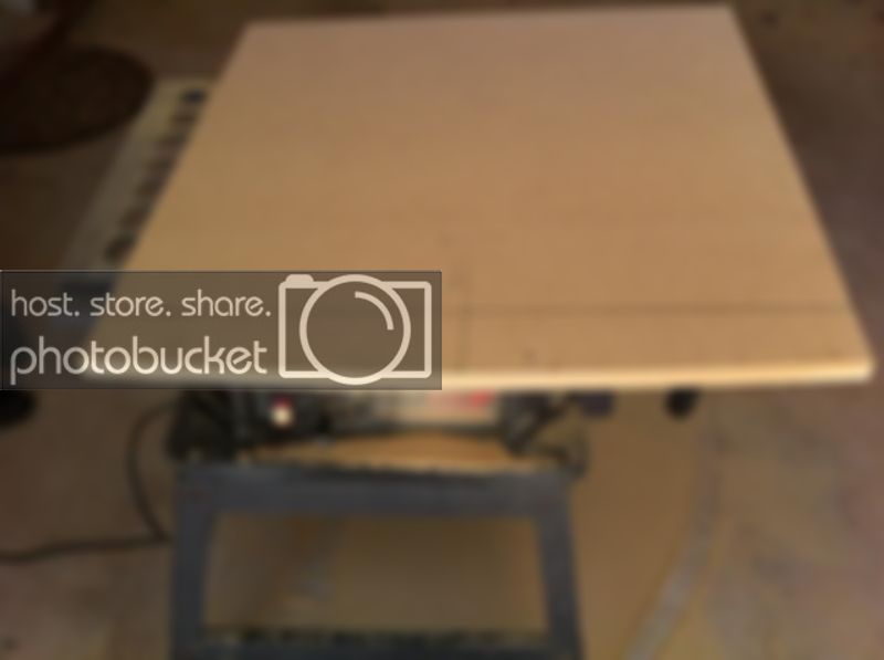

Here is the panel without the fans installed--I have to buy a 2" hole saw, first. You will notice, where this panel meets the back wall, that my MDF for the back wall was bowed. I guess I will get some new wood and use this one as a router template to make a new one. :-/

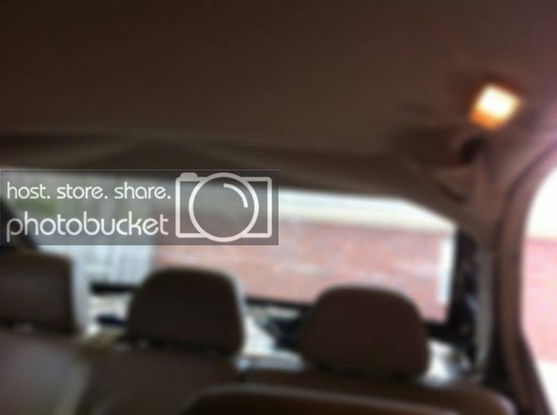

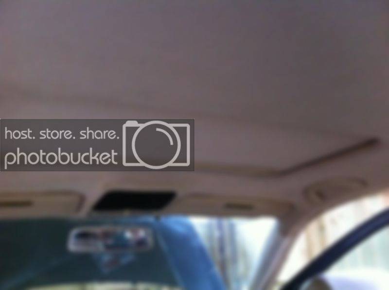

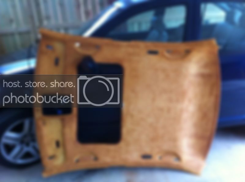

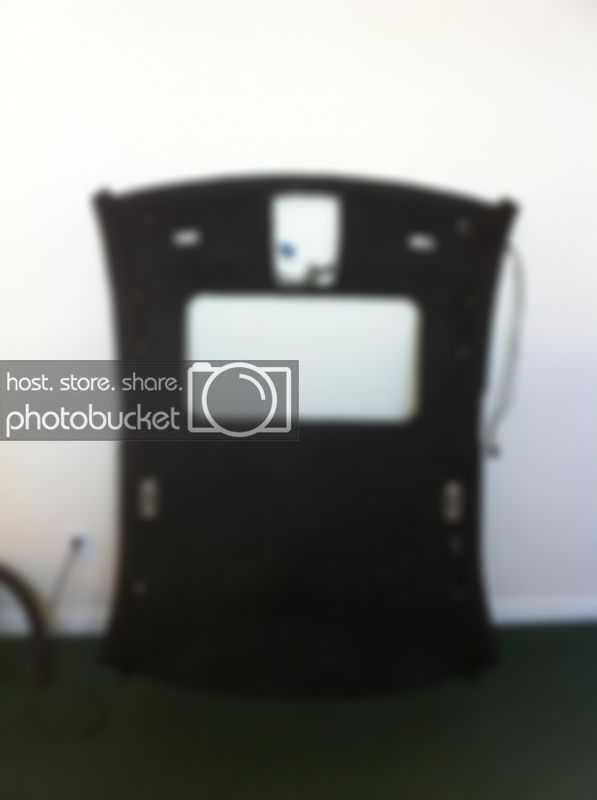

Behold my water damaged, old a busted headliner.

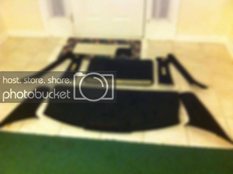

I removed all pillars, the rear deck and headliner. Here you see the blank canvas, soon to be covered with Raamat.
Currently, the interior of the car is tan and black, with more tan than black. I greatly prefer more black than tan, so the rear deck, all pillars and headliner are getting covered in suede headliner material.
I only have one part left to cover. Unfortunately, it is the headliner.

Honestly, the headliner was fairly easy to take out. I have not finished it, but I don't anticipate it will be too difficult to re-install, either. HOWEVER, to get the sliding sunroof panel out to cover was a royal pain!!! You have to drop the entire sunroof assembly and I did this by myself. On a scale from 1-10 with 10 being impossible, it was a solid 7.5.

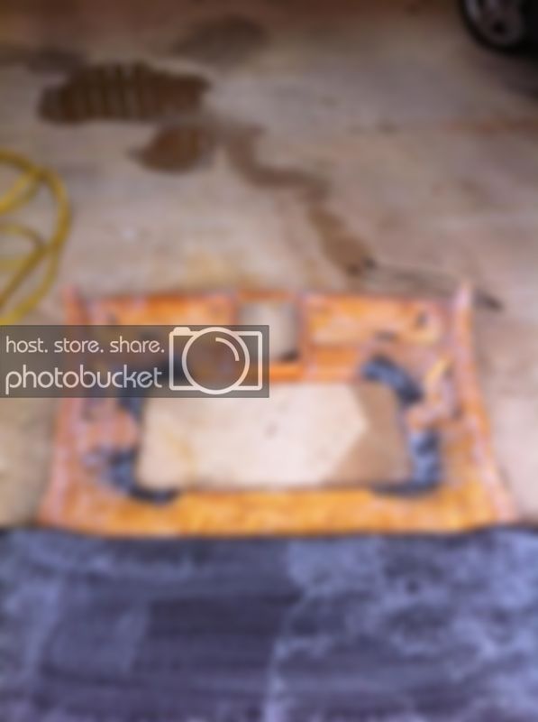

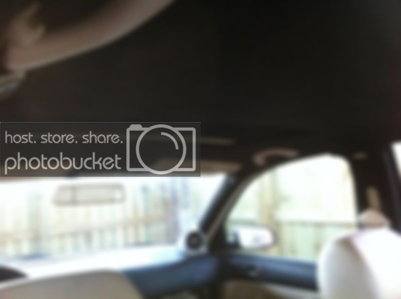

Got the headliner covered and it was just as much fun as I imagined. And by that, I mean is royally ******. The suede headliner material I ordered unfortunately has very very little stretch in it. And my headliner has tons of compound angles. Therefore, it looks good, but it is not perfect.

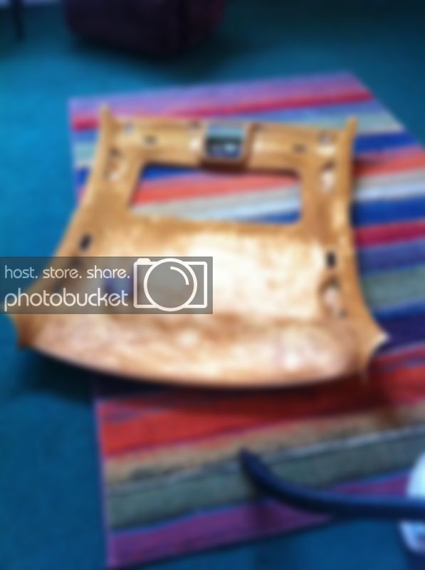

I used a piece of 40 grit to remove the majority of the foam. After that, I was able to just rub the part down with my hand to get it ready to cover.

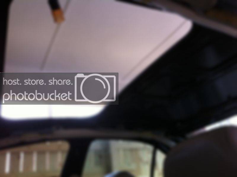

I went ahead and painted the corners of the sunroof opening black because I knew there was no way in hell the material was going to stretch enough to make the transition.
Finished product.

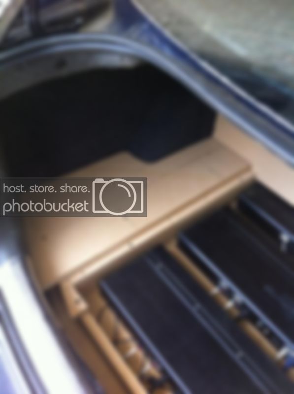

Time for some trunk panel action.

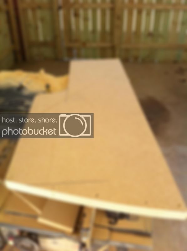

I am creating the rough shape of my panels. I try to get them close, but I don't go overboard making sure they fit absolutely perfect--you'll see why in a minute.
The two panels on either side of the amp rack serve as the platforms on which the finished panels will sit.
Here is the left side panel in place. Once again, good but not perfect gaps.
Here, I am getting the curve for the center panel. You may do it a different way, but this is how I get my curved surfaces. A pass with the flush cut bit and there you go!

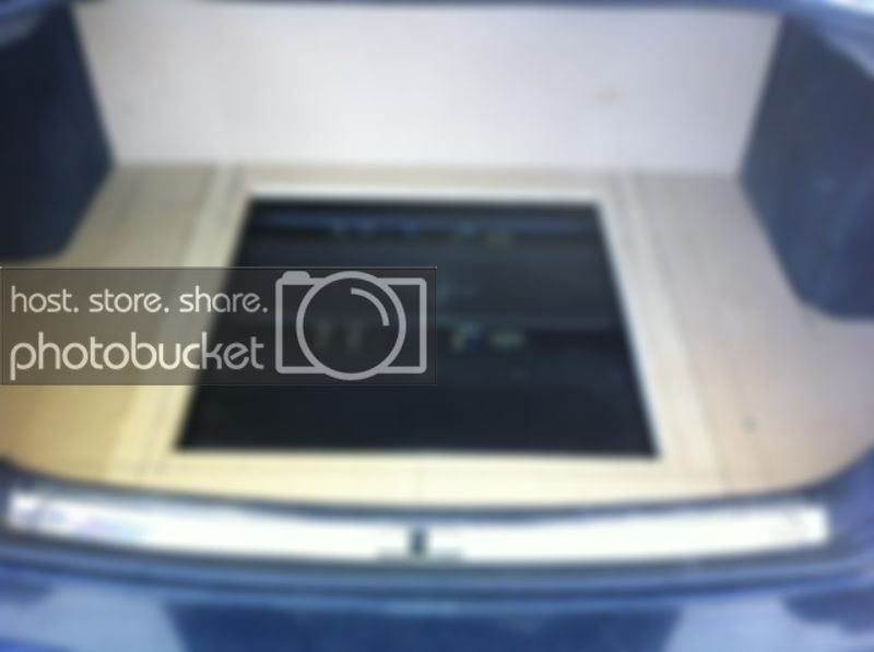

All three bottom panels in place
One thing people tend to overlook when doing builds like this is material thickness. Everything goes in great before covering, then not so great afterwards. Here, I am using a piece of aluminum stock to gap my panels.
