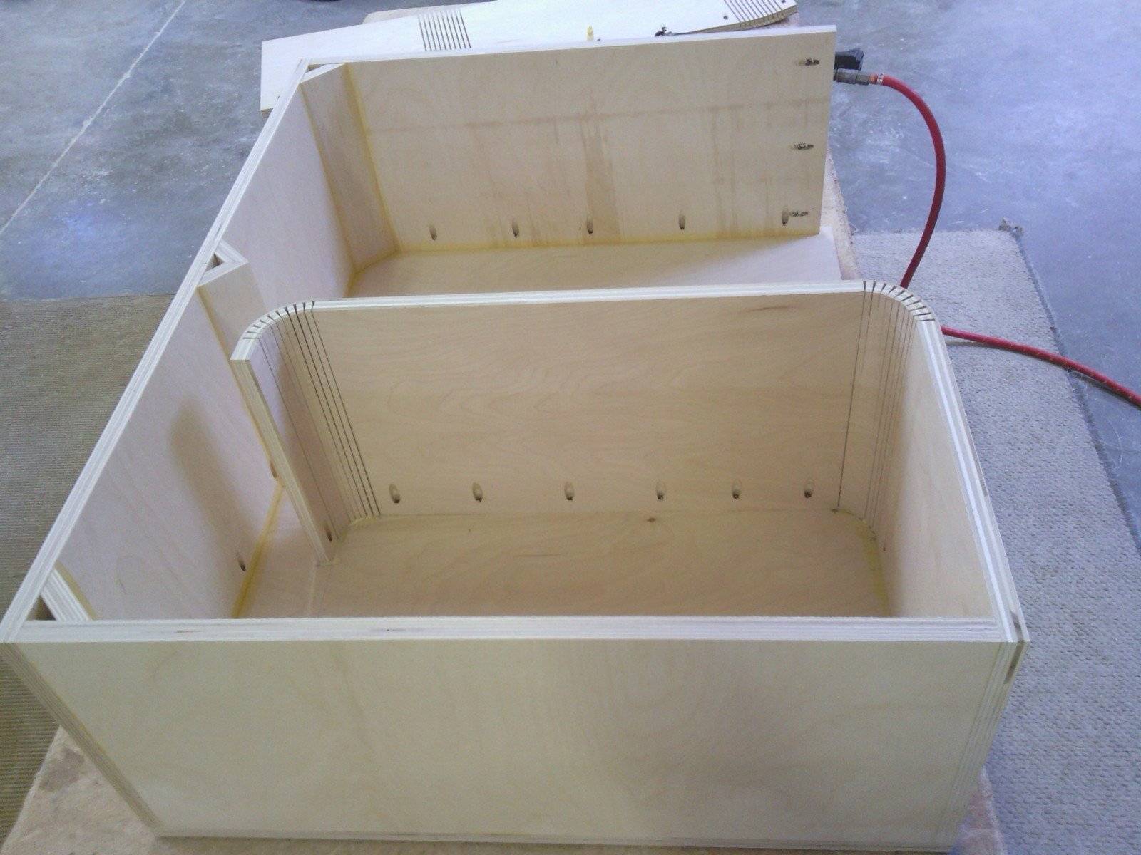

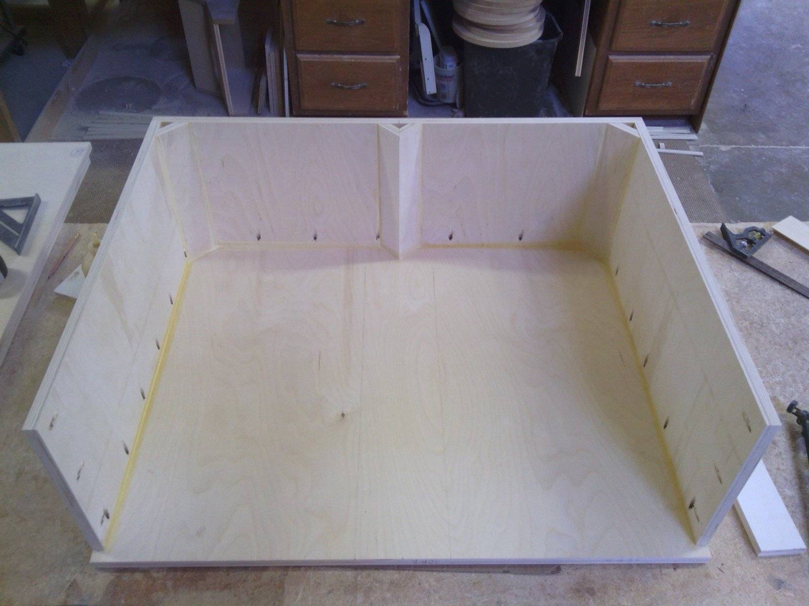

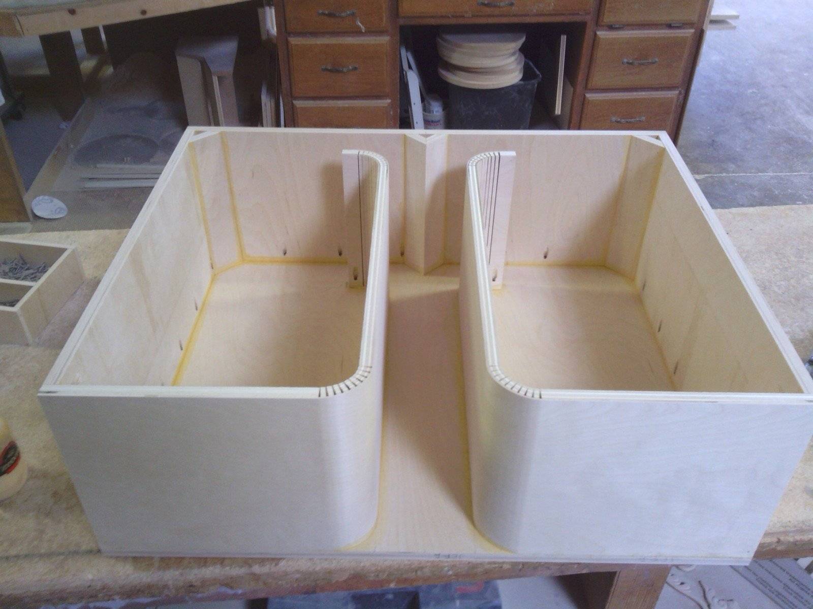

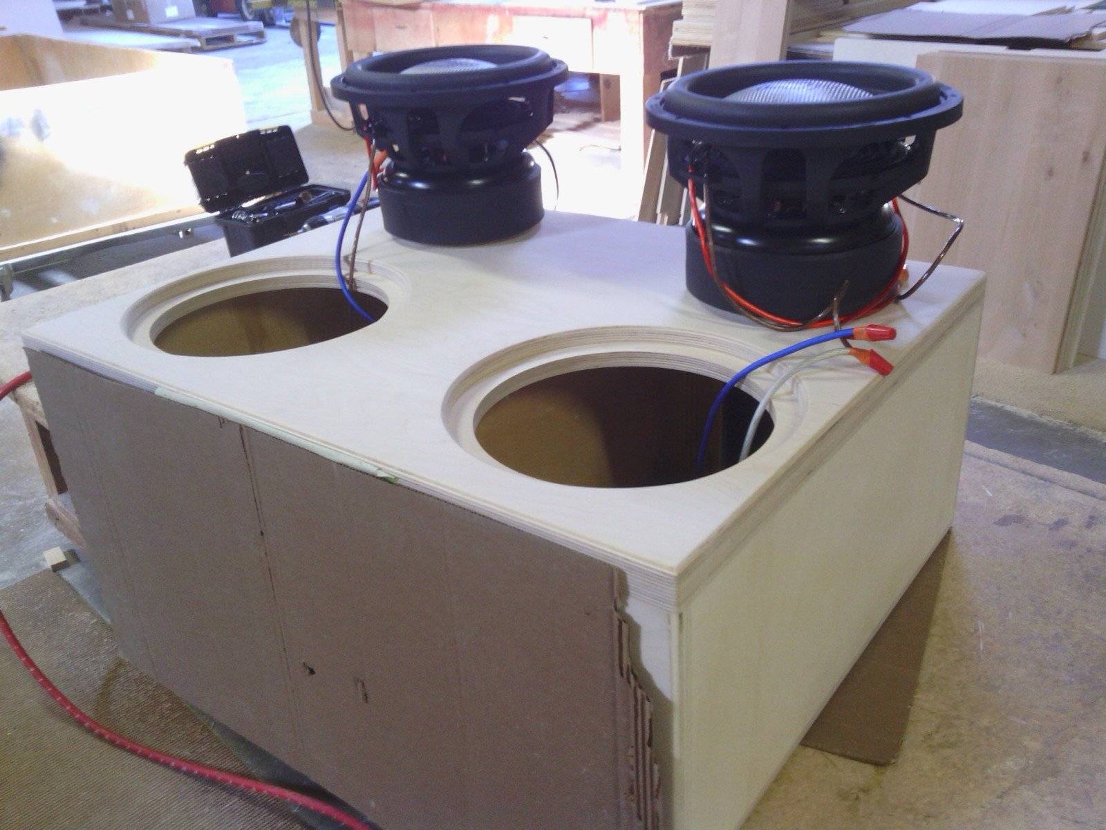

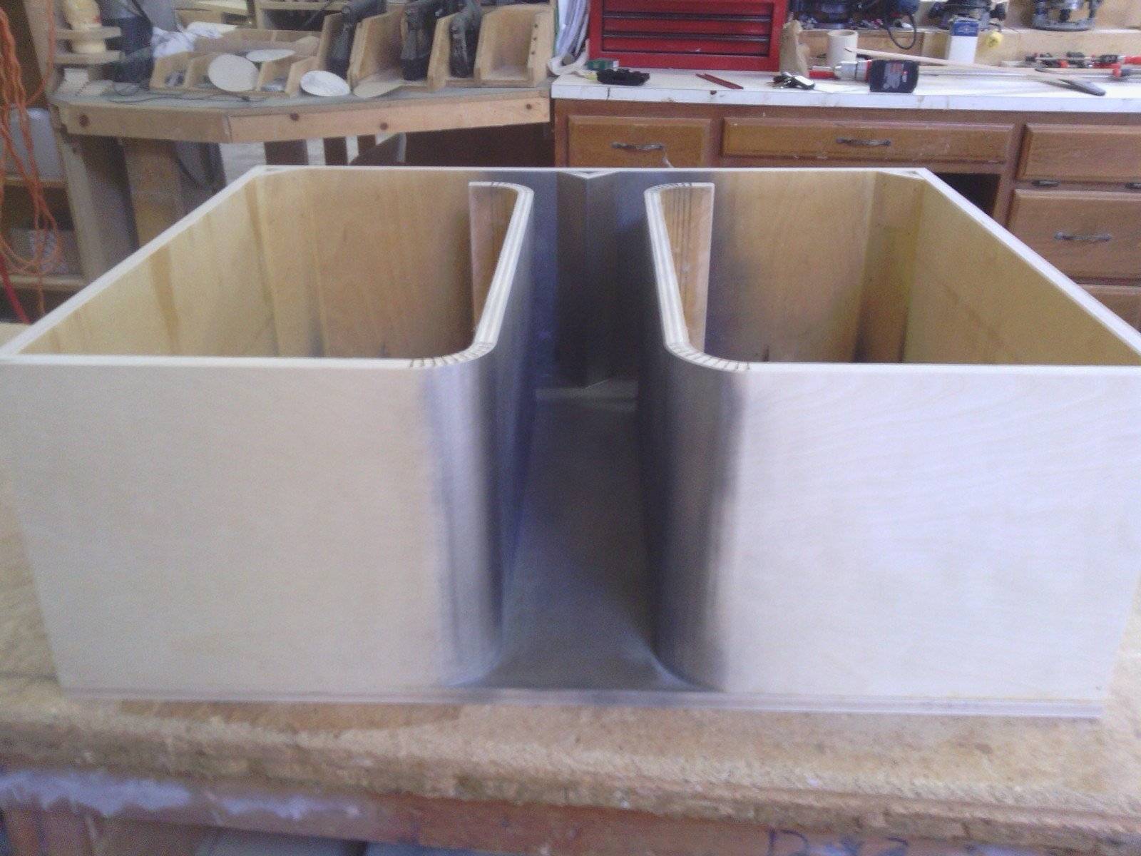

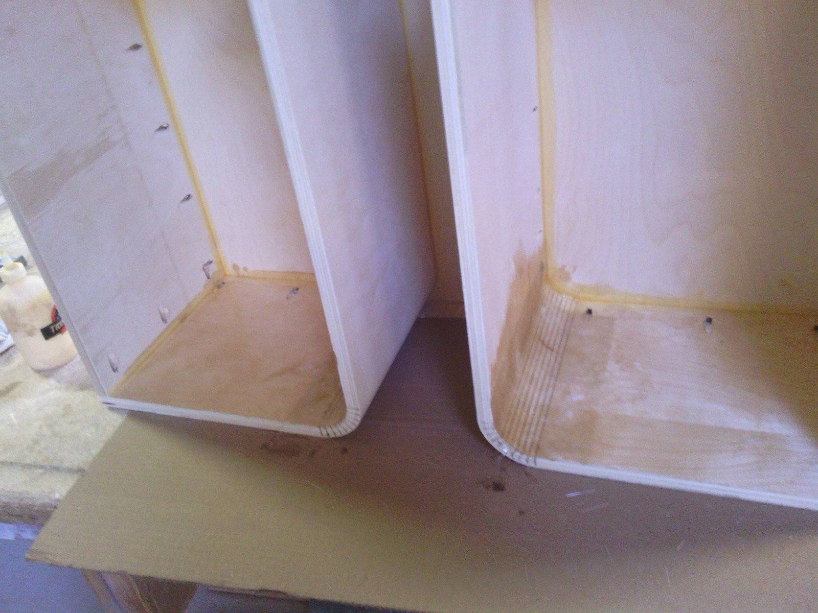

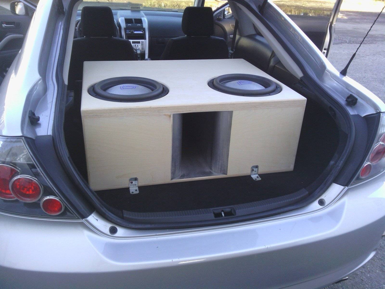

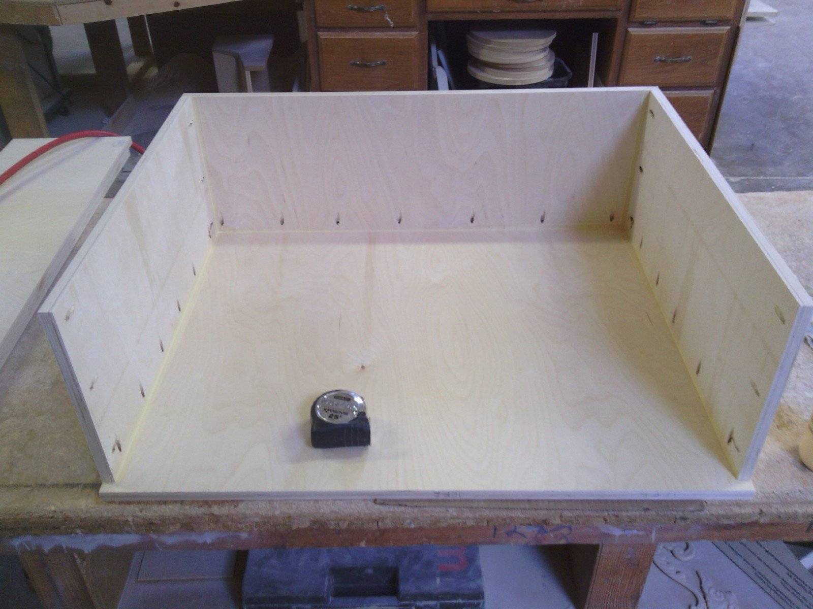

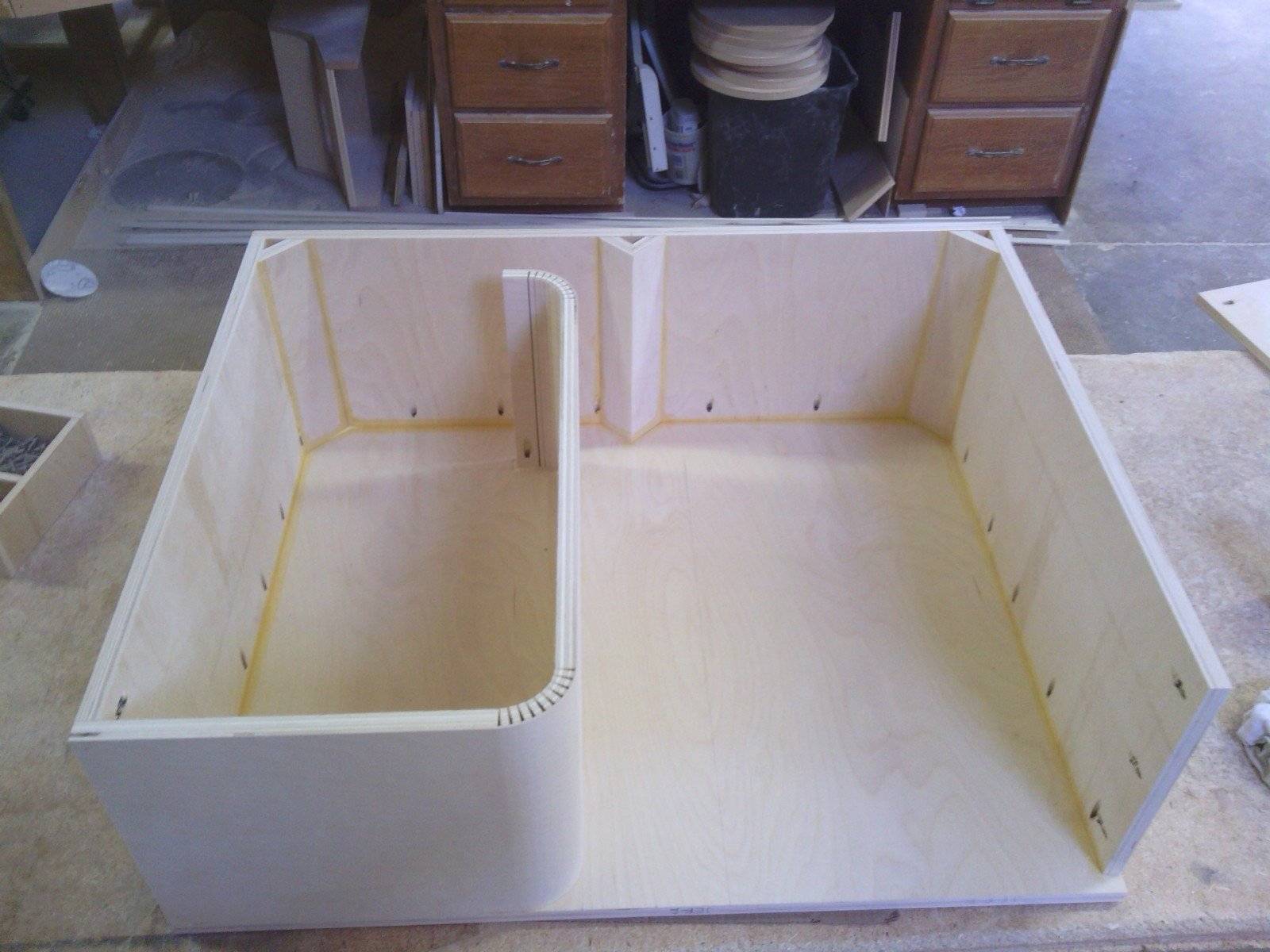

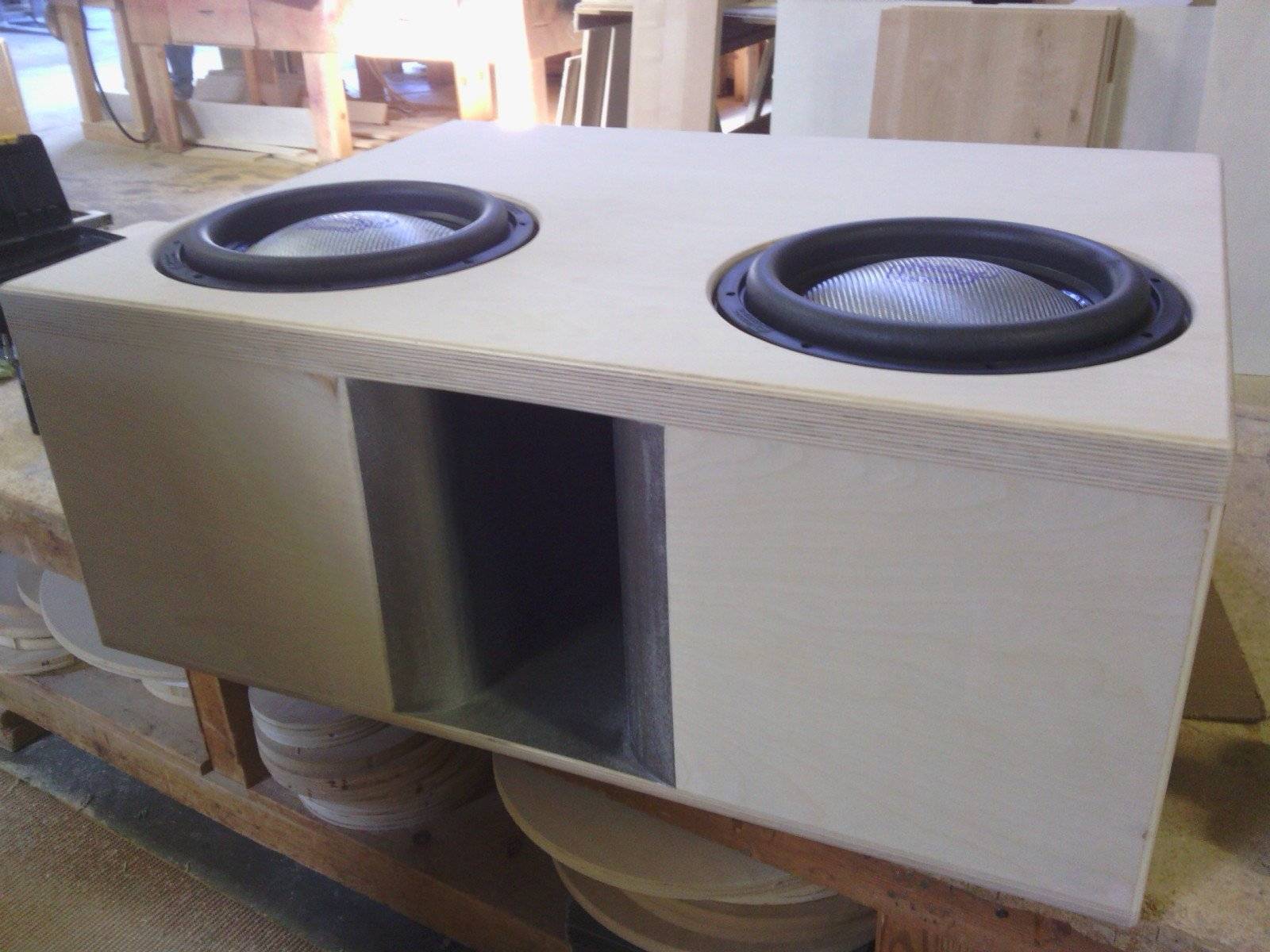

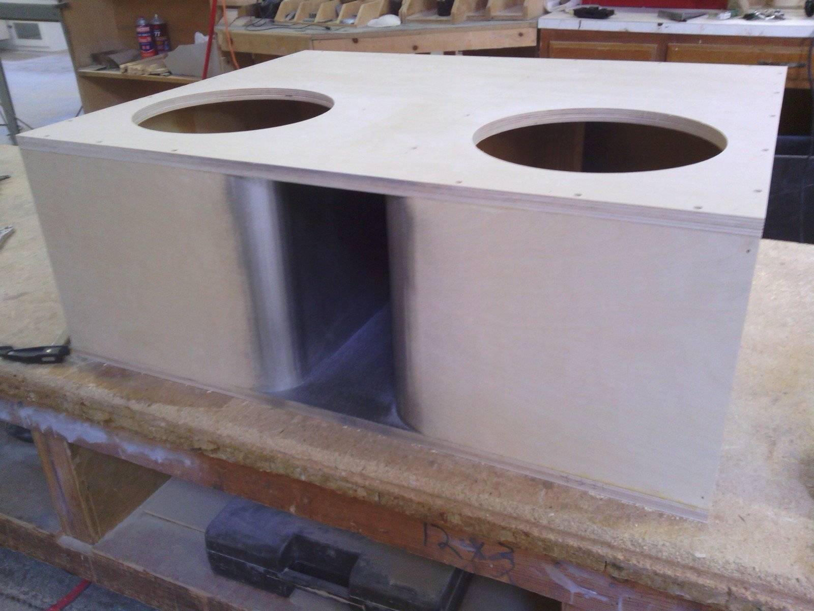

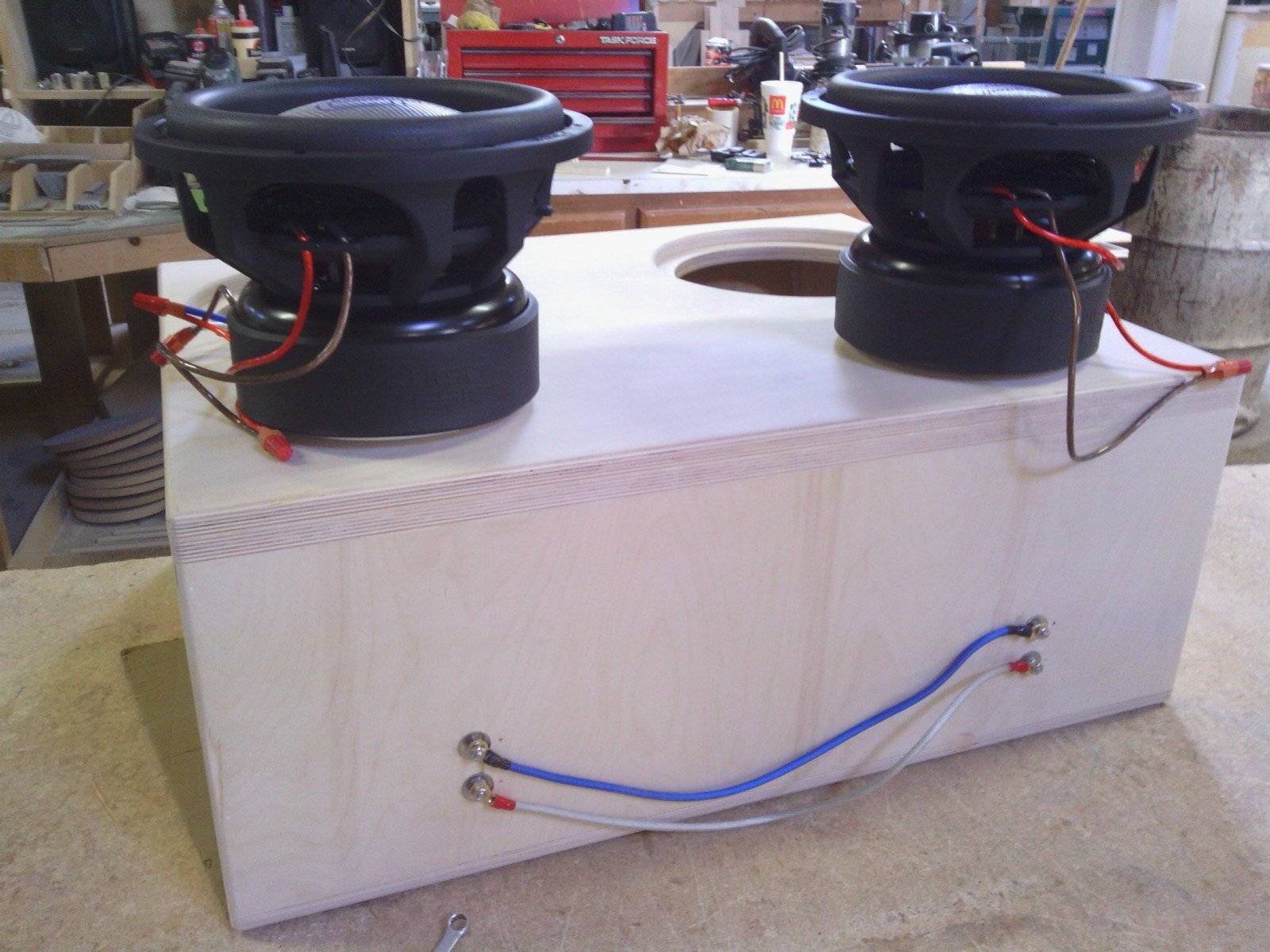

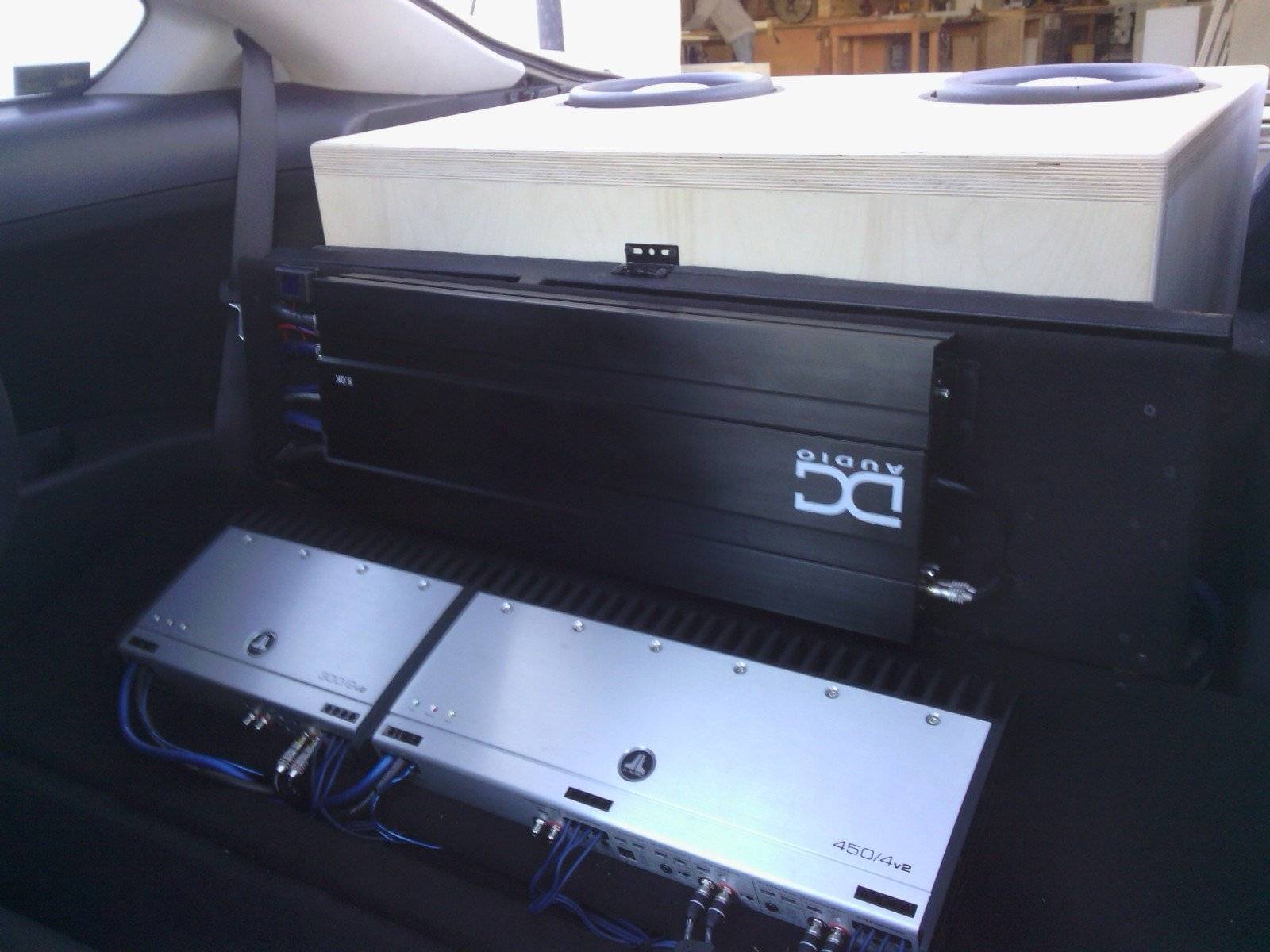

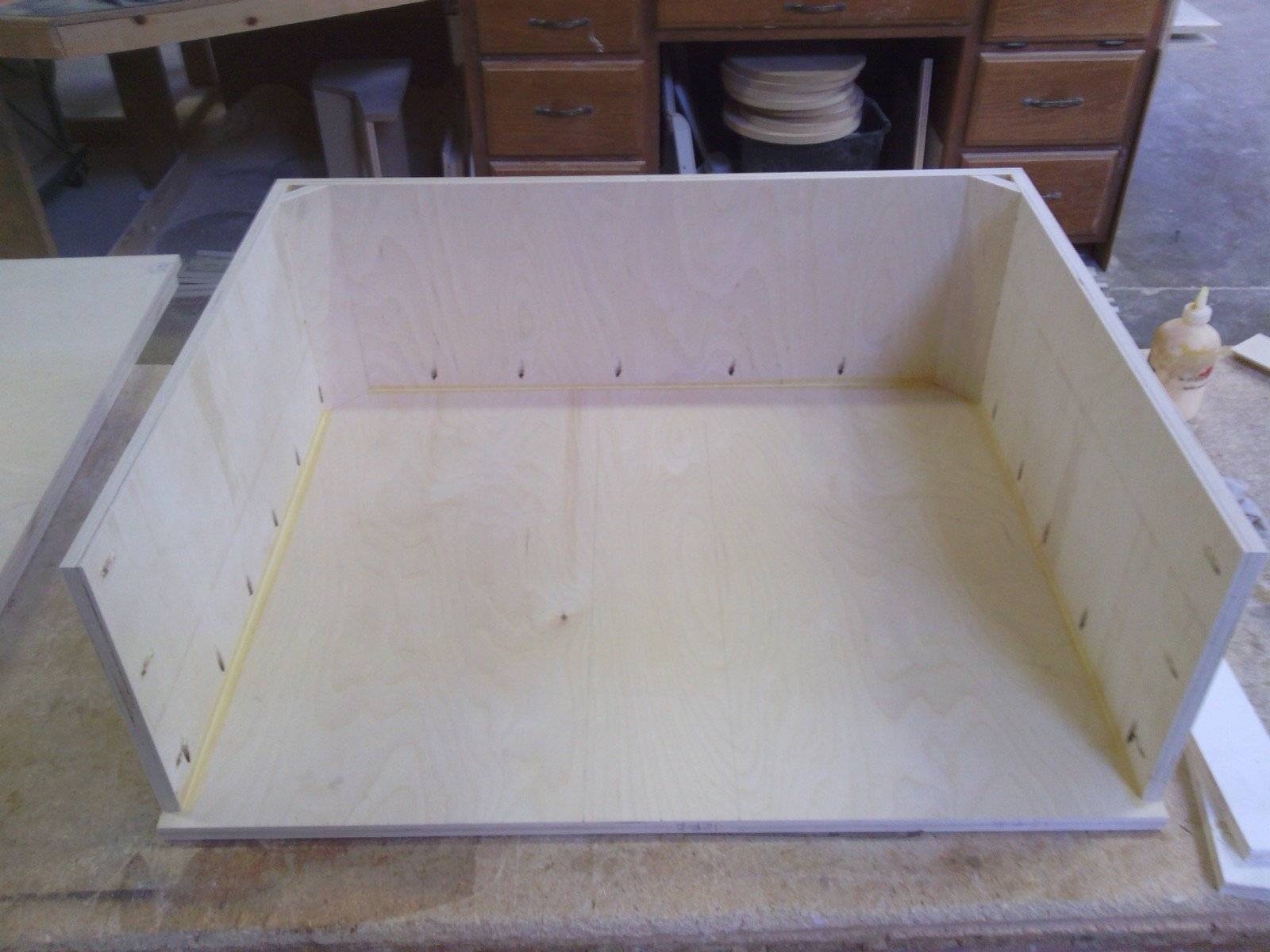

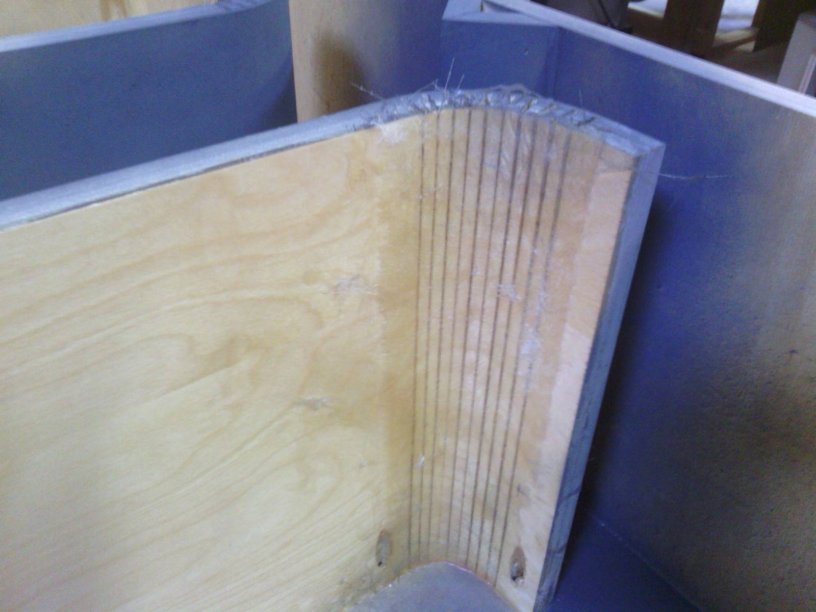

I'm building an enclosure for @DDtC ; for 2- Digital Designs 9512's.
It's going in a Scion tC, powered by a DC Audio 5k.

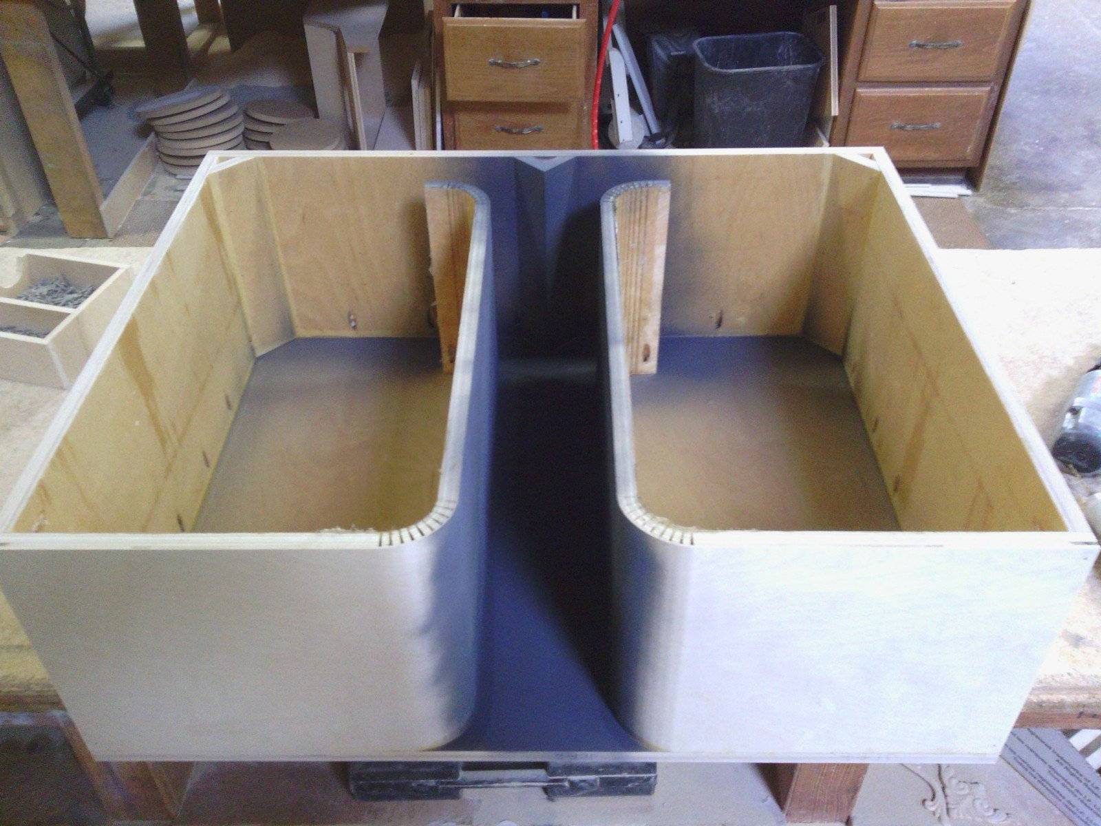

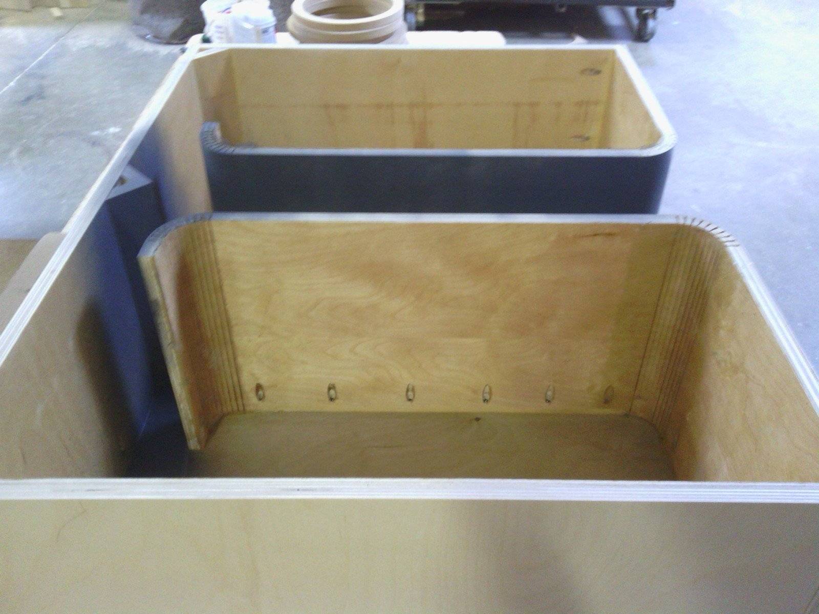

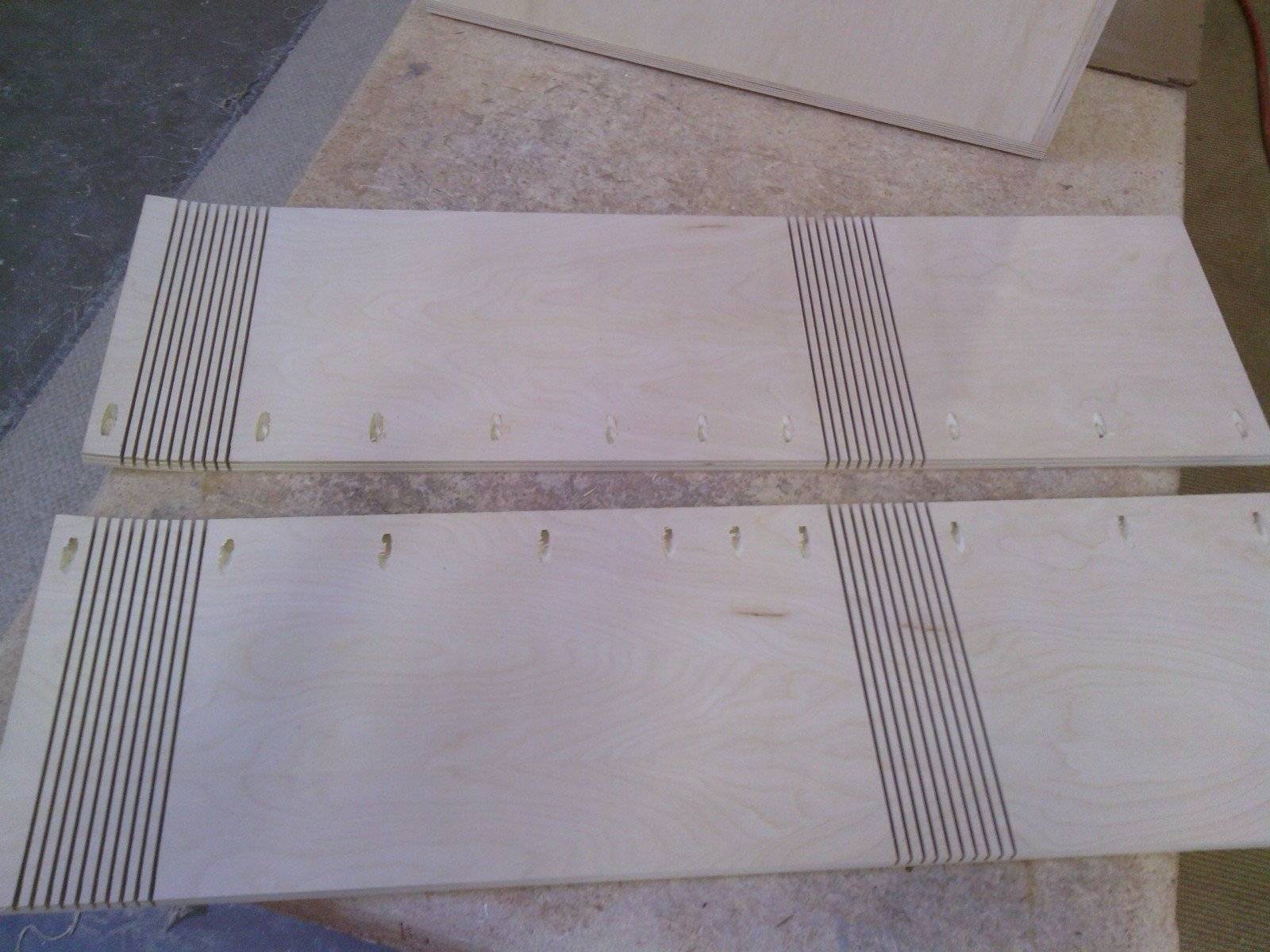

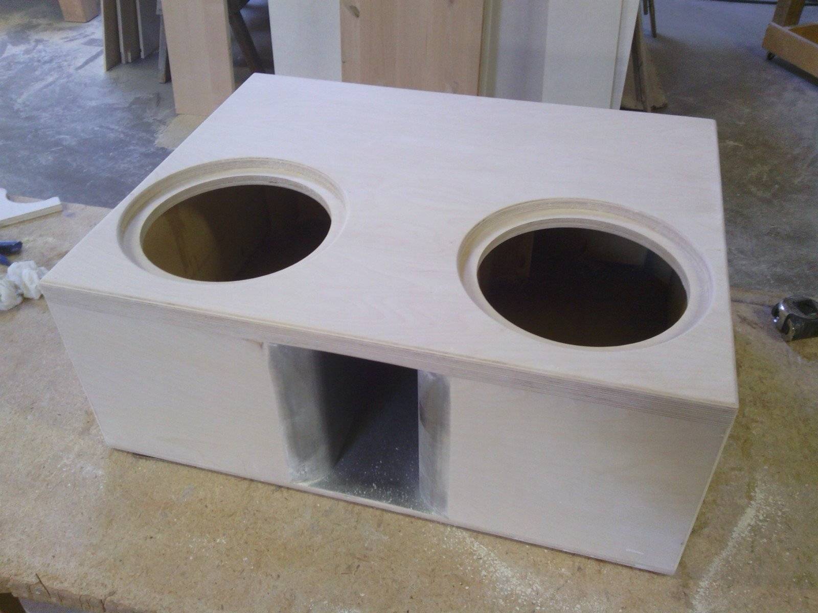

Construction is 3/4" Baltic Birch, kerfed port painted stainless steel.
4 cubes tuned to 33.5hz

I expect to see some #'s soon
It's peaking way to low for good numbers. Just messed around on the TL a few days after they went in. I tested outlaw cause this car still ***** sealed up. Played put on and hit a 148 on the 27hz note and 149.1 at 37hz. It fell off above that. It's got a 50 in it if I get around to finding the real peak and burp it. They are getting louder and lower everyday. I'm guessing from ear the peak is closer to 32-34hz
148db at 27Hz... and people say DD dont get low. thats really friggin good for 2-12s at that frequency. whats the box tuned to?
