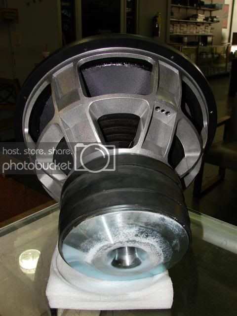

TC Sounds LMS 15 :: 20 ft^3 :: 22hz
the sub
this is why I asked for opinions...
whats group delay?
the very low end is at 5db+
at 50hz ( the top of what I consider bass) is still 3db+
at 4cubes the box was very peaky
the sub
whats group delay?
Peaky in the in-car environment or just in that program?
That sub is nasty haha
that's even big for a 15 in a HT set up. I have my 15" RL-P's in 10 cubes each tuned to 17.5Hz and they slam off 400watts each.
That enclosure wouldn't be good for a car environment....
it's on the small end of port aera 226 ish (12-16 in^2 per ft^3 ) but aeros are more efficient so i think you should be fine
hopefully some others will agree
Call me crazy but I think you used the diameter not the radius of the port to come up with that figure, seems WAY too high....
your half right i meant to tell him to use 4 aeros lol
so i guess it did look like i used dia lol
was bad math srry
