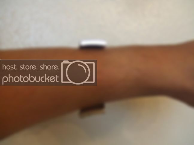

underhung motor, neo radial its a 2 piece motor with long skinny neo mags that you epoxy in the radius. I am having problems finding someone to get the right coils for my application but these 4 ohm standard copper flatwind coils are holding out **** well.

lol what are those neo mags from?^
