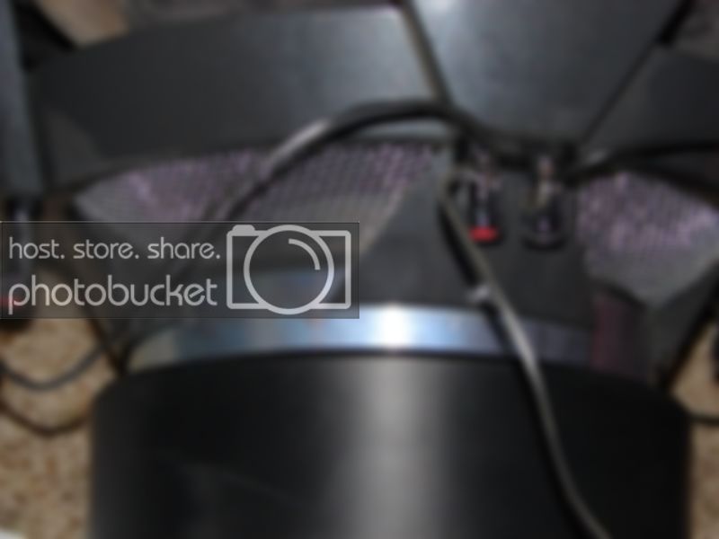

anyone know how to take this **** thing off. im trying to figure iut out i tryed twisting and pulling with no luck. need it off so i ccan send it to thilo and kyle for my replacement
pop the mesh out, its just glued in
there are bolts holding the basket down to the motor, just like how a normal sub is screwed into the motor. You might need to buy a tool to fit inside there to get it off since there is not very much clearance
pop the mesh out, its just glued inthere are bolts holding the basket down to the motor, just like how a normal sub is screwed into the motor. You might need to buy a tool to fit inside there to get it off since there is not very much clearance
**** that sure isnt "easy" as they put it
no you jackass.
screwed in from the base of the horizontal part of the basket to the horizontal part of the top plate. not in the sides where you would think it would make sense.
you eaither need to rip the cone off, or pop the mesh covers off and the bolts will be under the spider(s) between the top plate, and the spiders, through the base of the basket.
no you jackass.
yea talked to supa and i can see them, kinda sux TC makes it sound like i can just change them real fast and easy, guess if this is the case i cant switch back and forth fomr 12 to 15 and back with just having various assemlys
