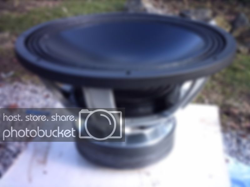

yea talked to supa and i can see them, kinda sux TC makes it sound like i can just change them real fast and easy, guess if this is the case i cant switch back and forth fomr 12 to 15 and back with just having various assemlys
truth be known that quckchange shit is just for newer sub baskets and motors. They have made spacers that would accomodate for various versions, but they're not much worth a shit because of the hack job they usually do on the baskets. Case in point :

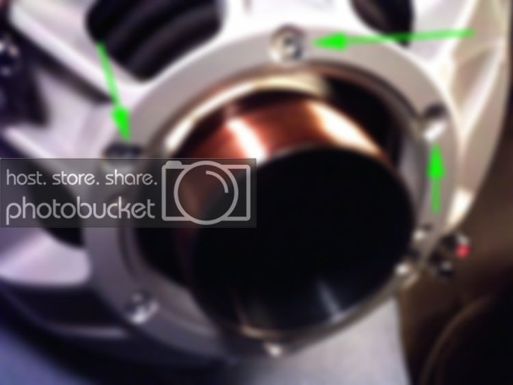

on that top plate where the arrows are pointing to, it clearly shows their "old" basket with their "new" threaded centering ring ... can you see how the basket has been hacked up to accomodate the centering ring.....ghey. //content.invisioncic.com/y282845/emoticons/crap.gif.7f4dd41e3e9b23fbd170a1ee6f65cecc.gif

The 2k's and 3k's do not unscrew, they unbolt.
4 holes + 4 screws
If yours is NOT tapped on the side you need to send us the motor and we'll recone it with our new ti cone and tap you're motor for you if you like too.
email or call us.
