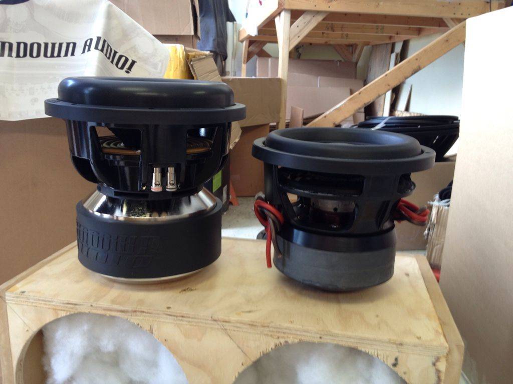

TSP's as tested...
Sundown Zv.4 10" Dual 1 ohm
- Fs - 33hz
-Qts- .51
Qes- .572
Qms- 4.702
Le- .22
Vas- .44
Sensitivity - 81db
Tantric HD10 Dual 1 ohm
- Fs- 42hz
-Qts - .58
-Qes- .624
-Qms- 8.75
-Le- .22
-Vas- .58
-Sensitivity- 85db

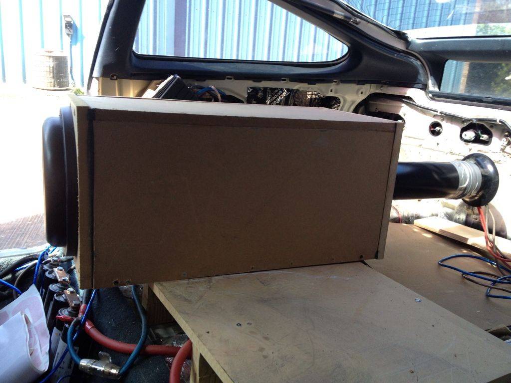

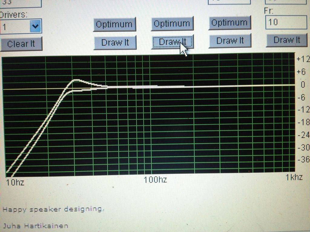

Round 1 - Slap some **** together.
Box - 1.8 @ 31hz. Why 1.8 @ 31? Because MDF remnant and full length 4" aero while waiting on the FedEx guy to deliver the Z. That's why.
Predicted response. You can see here the Z has a distinct advantage in this alignment.
Results...
30hz.
Z- 141.5db @ 30hz
HD- 140db @ 30hz
Peak.
Z- 145.5 @ 32
HD - 144.2 @ 32
Musical peak (same song).
Z- 145db @ 32
HD- 142.7 @ 32
The Z started pulling away from the HD on music in this box. This was a full tilt run on a pretty brutal song. This isn't an average. It's just a peak score on music.

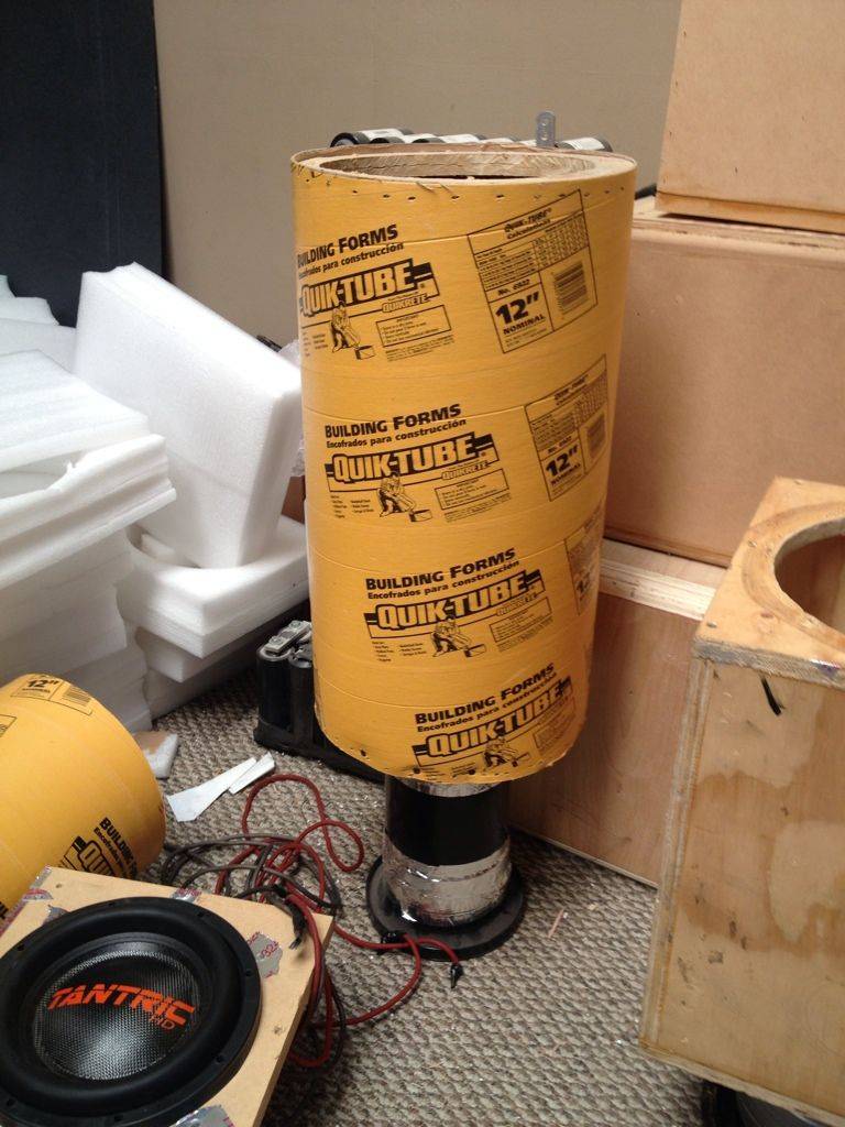

Round 3- TaylorFail.
I've been wanting to try something with a tube enclosure so I decided, "why not?" I fabbed it up all ghetto and what not (like I do).
Results...
Tube failure. The wood to tube joints got blown out. I didn't even record the scores. I know... I'm lame. Fwiw... I did actually try both in it in case the first sub just didn't "like" the tube. The Z was louder.

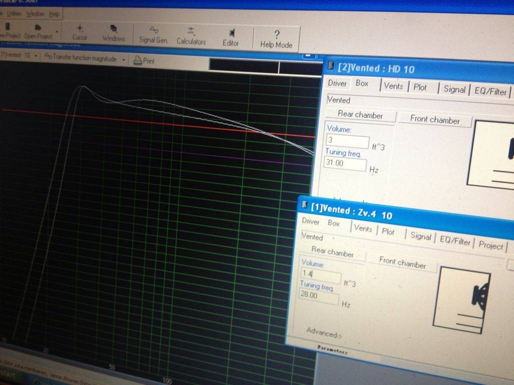

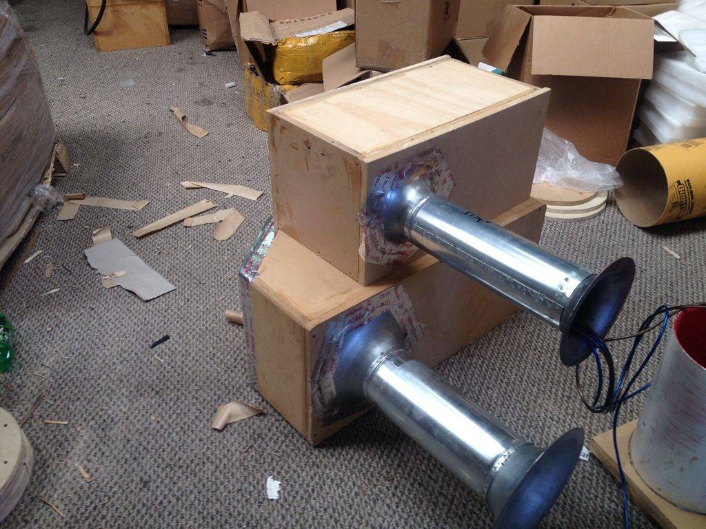

Round 4- WinISD.
So, we have the "drop in" tests done. It's time to get all nerdy and shit. This one is the meat and potatoes of this test. In the interest of consistency and taking myself out of the equation, I deferred to WinISD for the box specs in this round. This is what any ol' Joe Blow that didn't know crap about either sub would do. So, to put it bluntly... I don't want to hear any shit about these box specs. I had to completely abandon my instincts on this one and just do what the stupid computer told me.
I obviously pulled the TSP's for both subs and plugged them in. Since the entire premise of this test was "teh lowz", specifically 30hz, I fooled with the sizes and tuning until I got both subs' response to have a fat ass peak ~ 30hz while staying musical.
Predicted response (sorry for the shitty pic).

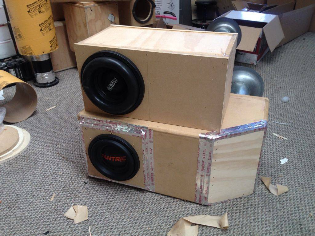

Boxes- Yes... you're reading that correctly. 3 cubes for the HD. 3cf @ 31hz. Z- 1.4 @ 28. Both boxes are oriented the same way and have very similar port area per cube. 9.3sq in per for the HD and 10sq in per for the Z. In case you're wondering... the one with the lower F3 is the Z's plot. You will notice that the HD's big ass box has an external 45* in front of the port. The Z has one too. But it's internal.
Results...
30hz.
Z- 144.3db @ 30hz
HD- 145.1db @ 30hz
Respective box peaks.
Z- 146.8 @ 33hz
HD- 145.1 @ 30hz
Street Beat runs. These are 30 second averages on the USACi street beat tracks. They're brutal "songs" with different frequency centers. Track 9 is centered around 32hz. Track 10 is centered around 27hz.
Track 9 (32hz).
Z- 144.8 (30 second average)
HD- 144.0 (30 second average)
Track 10 (27hz).
Z- 138.0db (30 second average)
---Peak score during the run- 139.2db @ 28hz)
HD- 139.6 (30 second average)
---Peak score during the run- 141.9db @ 28hz

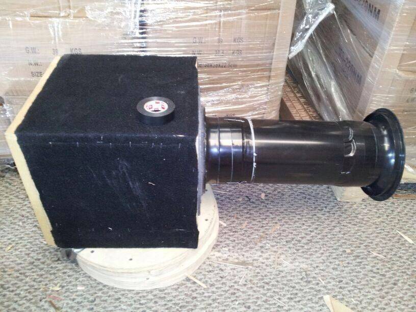

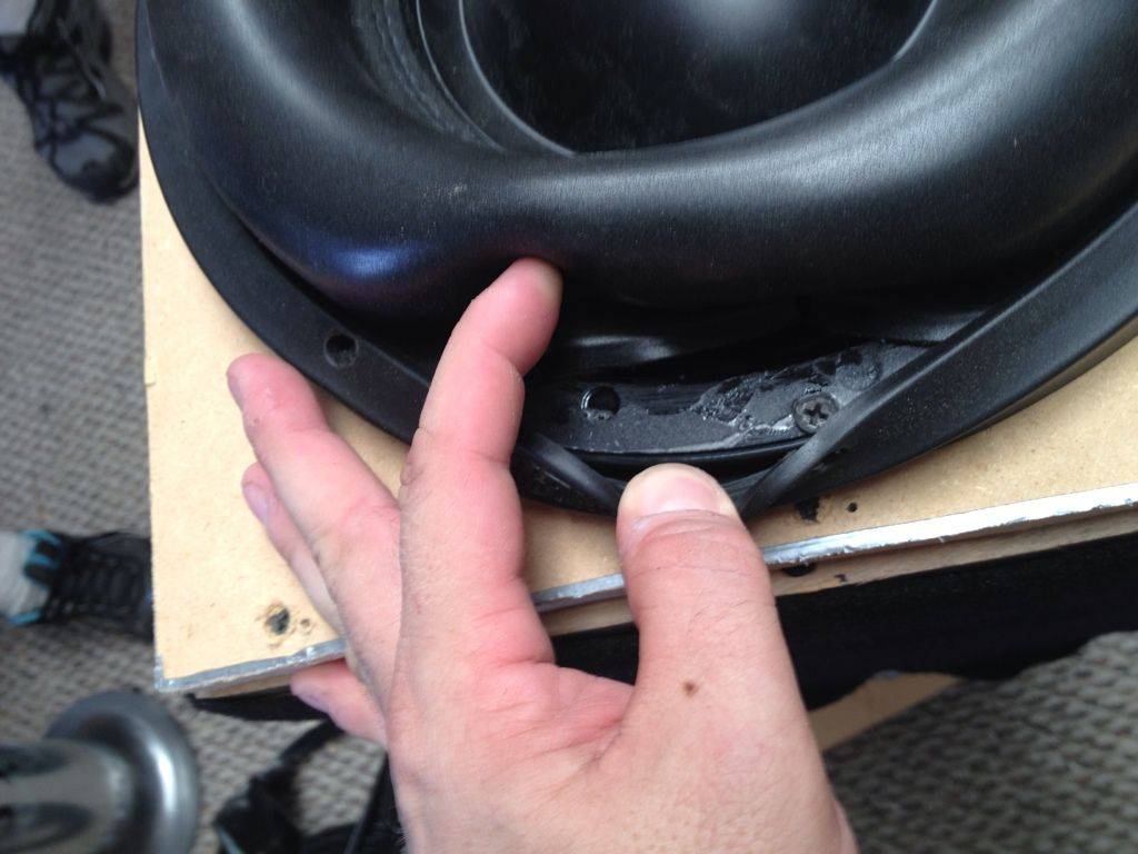

Round 5- Something borrowed, something loud.
To save a little time and get another data point, I borrowed a little burper from a teammate that he happened to have laying around. It's very similar to the burp warrior, but smaller and (should have) peaked a little higher.
Results...
Z- 149.1db @ CRX
HD- 148.4 @ 2 cycles lower.
In this box... the HD was pretty much tapped at volume 30 on the HU. It didn't get any louder at volume 35. That happens sometimes. A certain sub/box combo can just top out and it doesn't matter how much power you toss at it- it won't get any louder. The Z gained .4 from volume 30 to volume 35 and climbed to 149.5 but...
Shit happens.

Glue that Z back up and test it in the 3 cube box.
THAT... was also not the point of the test.
The whole thing about using WinISD was to do it the way some random person would do it. And the results speak for themselves in that regard.
With that said... I'd planned on it. I also have mo' powa to toss at it to see how much I can open it up. But... seeing as how it gained almost a full 3db at 30hz and 1.3db at 32 going from 1.8cf to 1.4cf, I'm not so confident that it'll like that 3 cube box.
