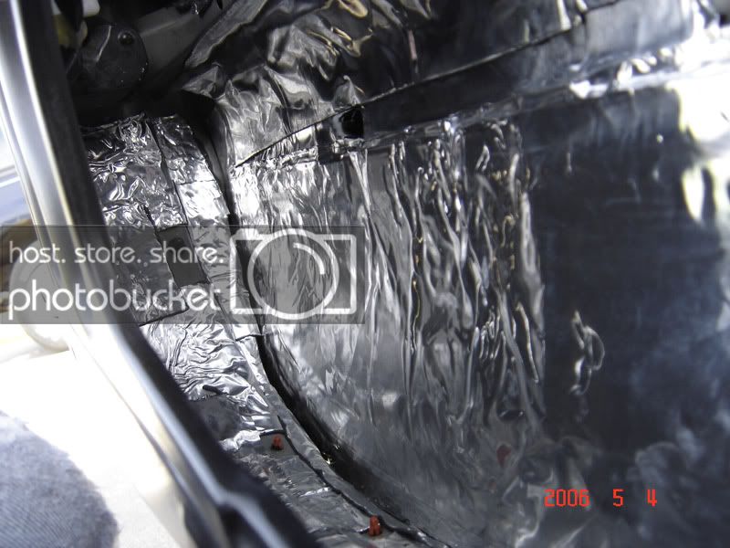

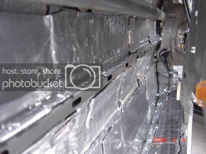

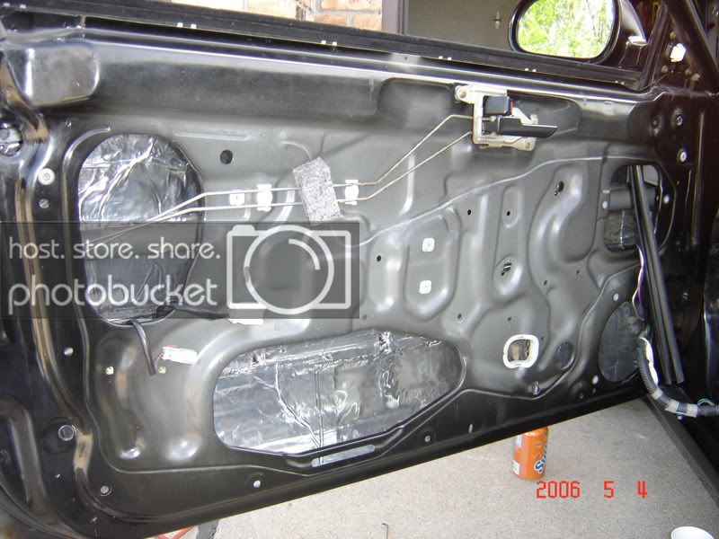

This is my first time applying this stuff, I put two layers on the large areas, as far as the part of the door where the door panel holds onto, should I apply it on the front of it, or behind it? (On this skin, should I apply it closest to the door panel?)
apply it everywhere you can, just make sure you get it stuck down really nice and if dont put it over spots that need the little clippy things to go in for your doorpanels.
so yes, put it on the whole 'inner face' of the second picture where you have not put it on yet. just be careful as you do it.

But good job so far, thats a good job applying behind the inner skin, its always hard to apply back there.

I finished my drivers side and reinstalled my Alpine X stuff, put the door panel back on and daaaaaamn, just that one side I can already hear so much of a difference. I ran out of damplifier for the passanger side (I need about 2sq feet to friggin finish it) so I'll end up ordering a little more. But in the mean time, I can start putting that in, I can already tell this is going to be worth it though. I'm glad I went ahead with 2 layers instead of one.
By the way, for future reference for anybody else, I DID end up using all 40sq feet in the two doors of my honda, if you can be a little more conservative, 40 would be perfect.
