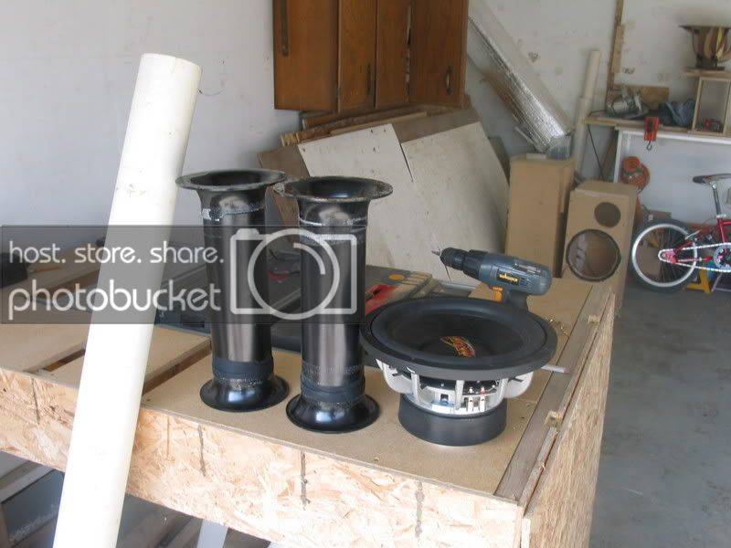

heres a few more pics from yesterday...

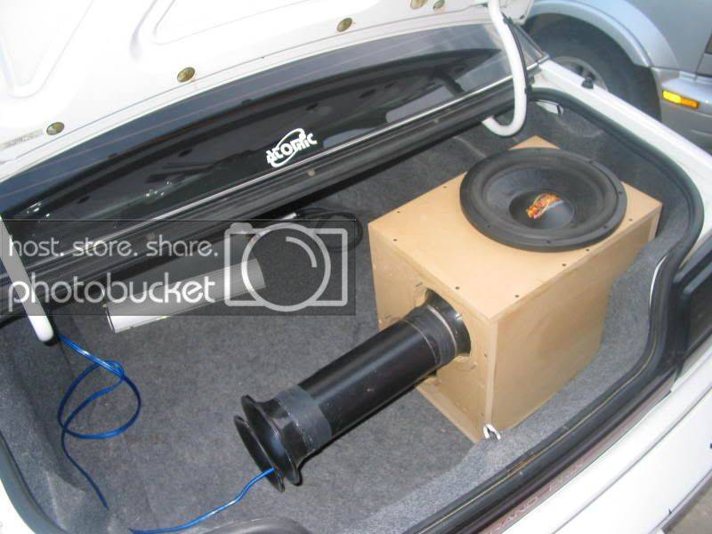

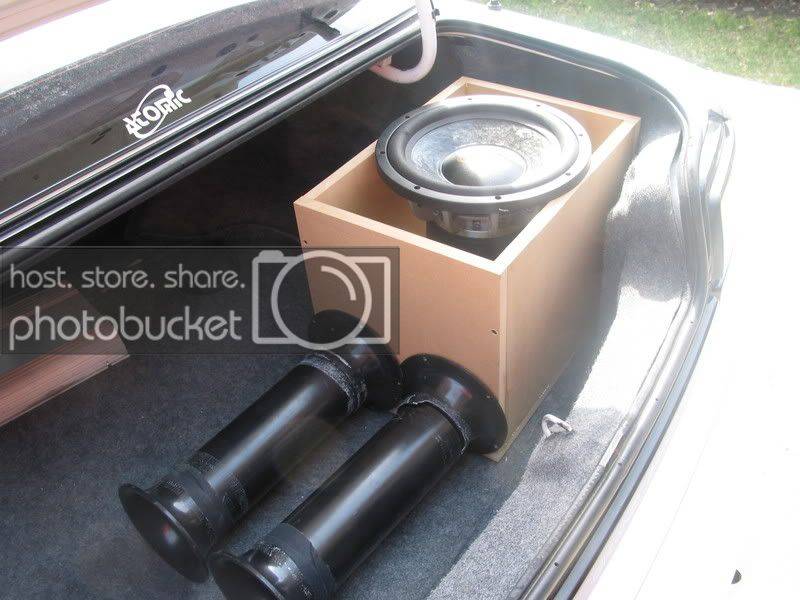

my box thats doing a 137.8(new tl, of course.) right now. last summer the same box was sub forward port back and did a 136.5...
by this weekend i hope to be over a 140, and doing a consistant 139.9 for bass race:)

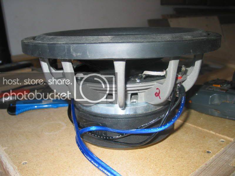

and in order to reach my goal, heres a teaser or what i am using...//content.invisioncic.com/y282845/emoticons/naughty.gif.94359f346c0f1259df8038d60b41863e.gif
high expectations i know, but we'll see how it goes. and if it doesnt happen, well my BL 18 will be here by friday
heres a few more pics from yesterday...my box thats doing a 137.8(new tl, of course.) right now. last summer the same box was sub forward port back and did a 136.5...

yea bj, the next thing on my list is definatly an outfeed table:)
and it's just a regual ap

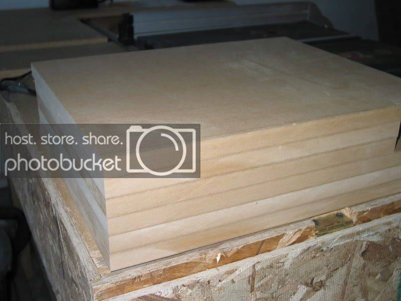

well i finished the box up, its 1.5@ ? hz. im going to guess around 55 right now, but im going to lower it tommarow to 45 which is what my vehicle peaks at.
heres a few pics i took
it definatly isnt as loud to the ear, but we will have to wait and see what the meter says:)

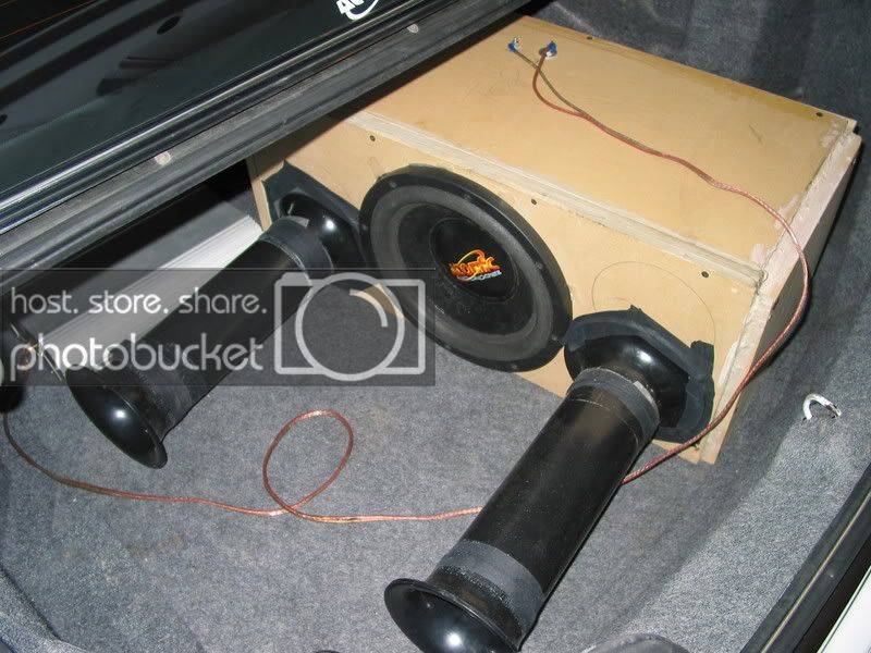

loolllllll anyhow i made the ports longer and brought the tuning down...sounds louder so we'll see...
well it wasnt louder, infact it was 1+ db's quieter....so needless to say it came out today and the other one is going back in. oh well i can use it as a shop stool or something //content.invisioncic.com/y282845/emoticons/laugh.gif.48439b2acf2cfca21620f01e7f77d1e4.gif
well after tearing that box out before i left for the comp, i put the old one back in. with the smaller ports...tuned to 44hz...it did a 137.4....then i put 3" longer port and did a 139.5 in street A.//content.invisioncic.com/y282845/emoticons/smile.gif.1ebc41e1811405b213edfc4622c41e27.gif i am very happy with that score considering i couldnt break a 137 last year (exact same box/equipment this time) and i know if i had a few more days of testing i could have easil broke a 140. butttt.... i sold the sub lol. now to pick up my BL once it gets here and have fun in bassrace.
