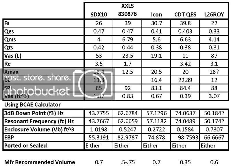

I've developed a list of subwoofers to choose for my next system. I entered each speakers' T/S parameters into a spreadsheet, and used BCAE's calculator to help determine what would work best given the box I will be using. Then I realized that I had very little idea what I was looking for in this data. I want the sub to hit hard, yet reproduce quality sound, basically an SQL system. I listen to everything, but primarily hip-hop/rap, then rock. The box will be ~.60ft^3 and will be in the rear hatch area of a 2002 Pontiac ***** Am. What should I be looking for in the T/S specs to fit my system goals? Below is my spreadsheet. Thanks.
