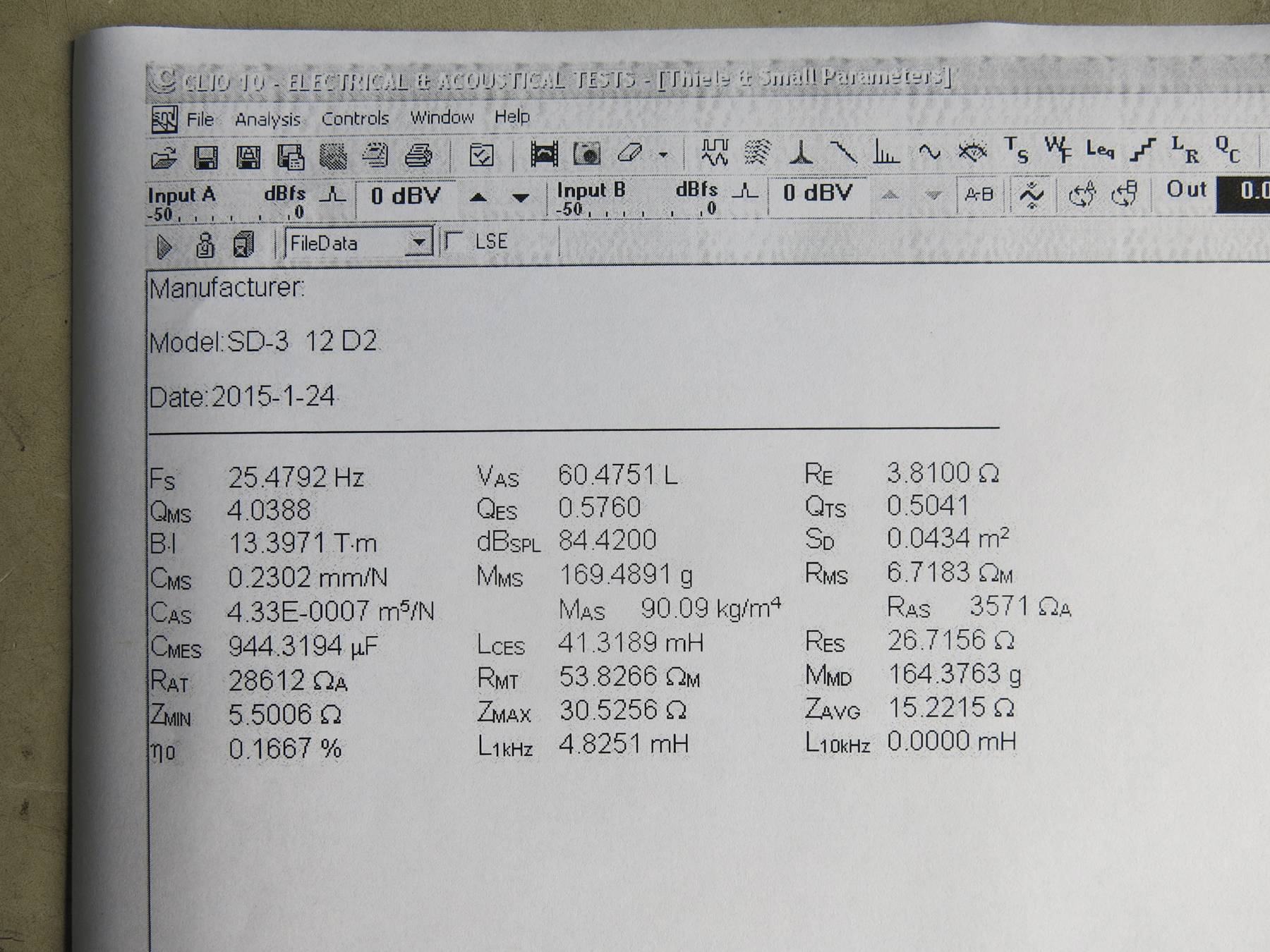

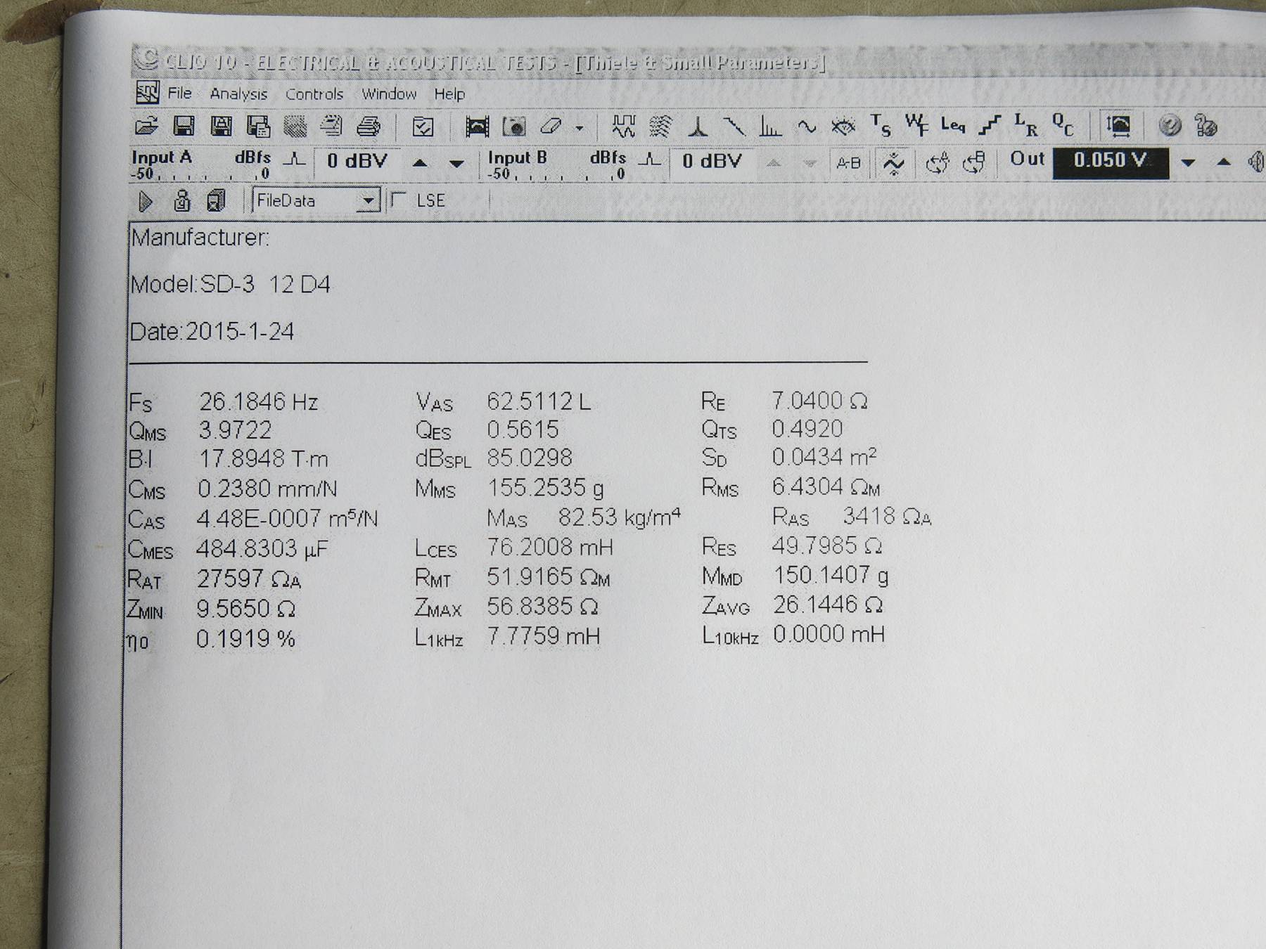

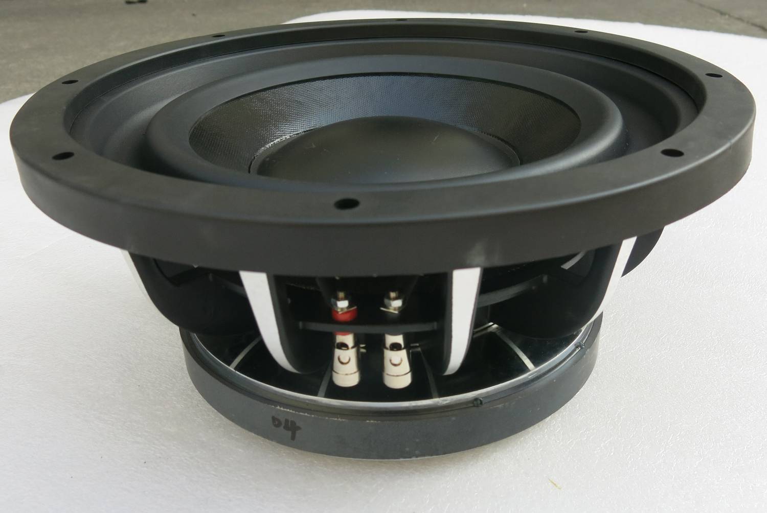

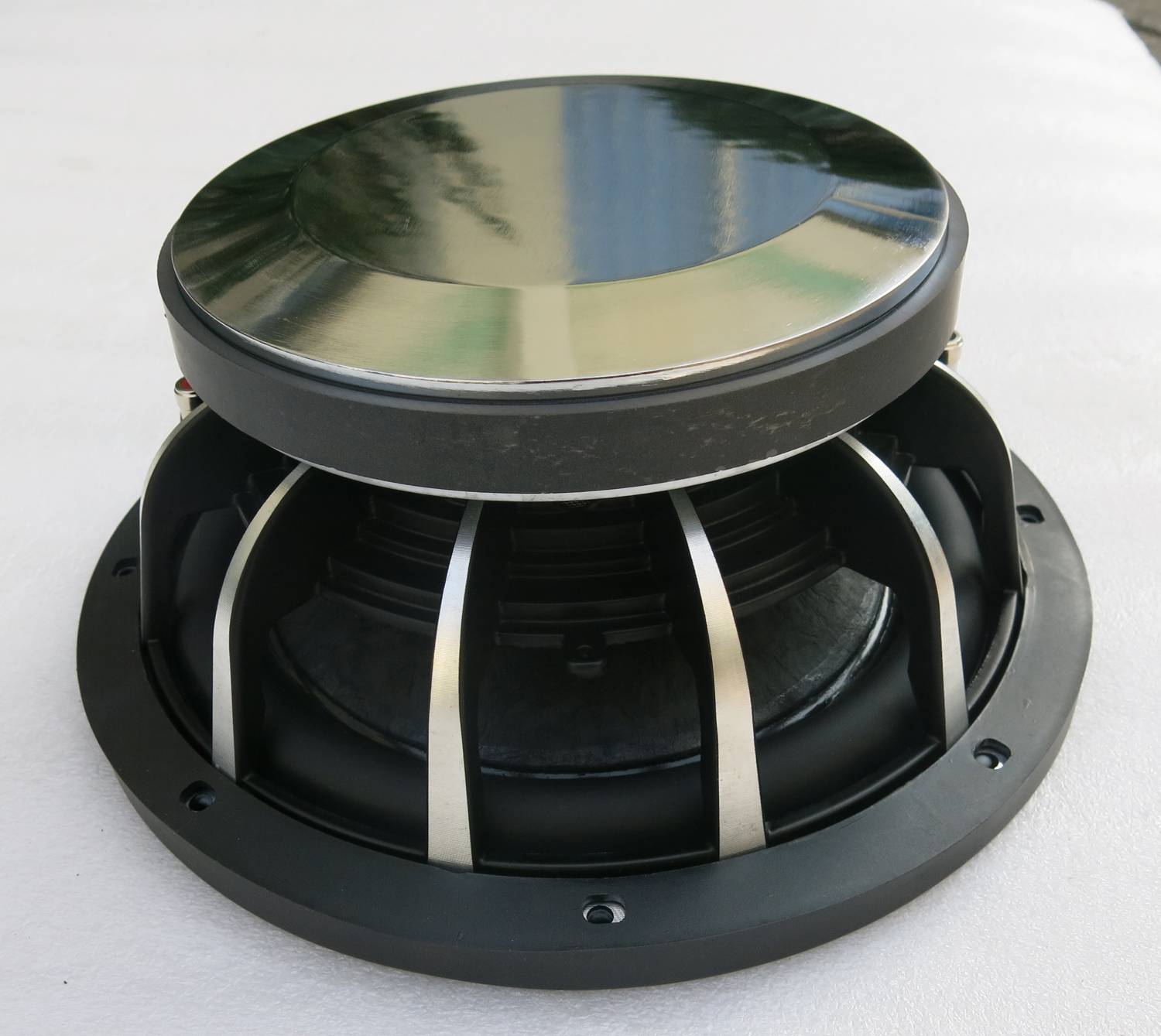

The 12" prototypes are completed @ the factory and on their way to me... since I nailed things such as surround thickness & compliance down on the 10s these were pretty simple. We did have to use a motor 30mm wider to drive the additional mass; so keep that in mind when I formulate pricing :
* The machined arms are just on the prototype. I am not going to spend the extra to do that on production since there is no performance gain.
* Factory spec on the D4
* Factory spec on the D2

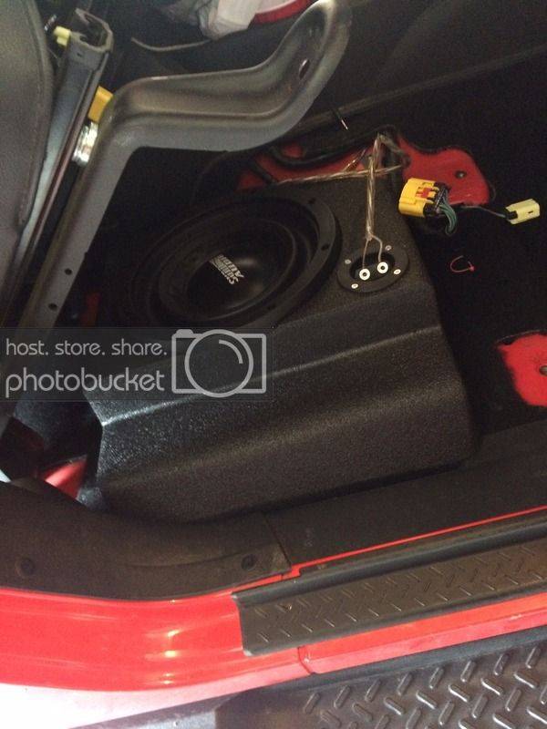

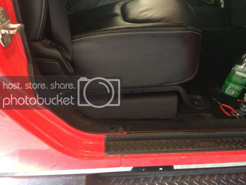

I'm using two of the SD-3 10" subs in my Jeep Wrangler under the front seats. They are replacing SD-2s. Enclosure is .62 cu ft, powered by 500w each. Low end seems to be better and they sound great so far. Still tweaking EQ but I can tell you these things are even better than the SD-2s if that is possible. Best "shallow" woofer I've heard so far including Alpine, JL, Kicker, etc.
