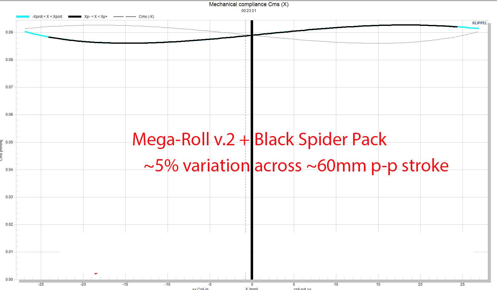

The new Mega-Roll v.2 surround achieves ~5% variation over a span of ~60mm p-p stroke. That is a huge improvement over the already excellent compliance behavior of the Mega-Roll v.1 surrounds. We've rolled out the Mega-Roll v.2 on the X, Z, NS, and TEAM lines already //content.invisioncic.com/y282845/emoticons/cool.gif.3bcaf8f141236c00f8044d07150e34f7.gif
The graph does not extend farther due to power limits of the Klippel machine @ Red Rock Acoustics (Capped at 1kw for the laser according to Patrick) -- but it's safe to say there is no trend showing the linearity will end any time soon after the range on the graph.
Clearly, we have improved suspension induced distortion once again with the new Mega-Roll v.2 surrounds! It's something that worked in theory, on paper, to my ears, and now to Klippel //content.invisioncic.com/y282845/emoticons/biggrin.gif.d71a5d36fcbab170f2364c9f2e3946cb.gif
