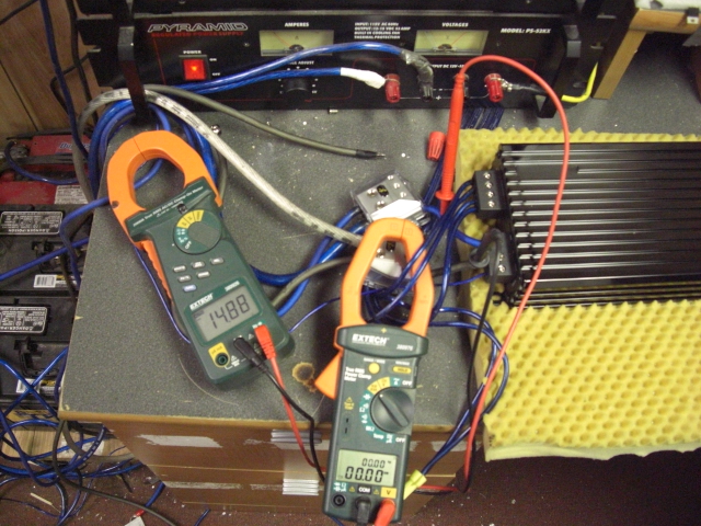

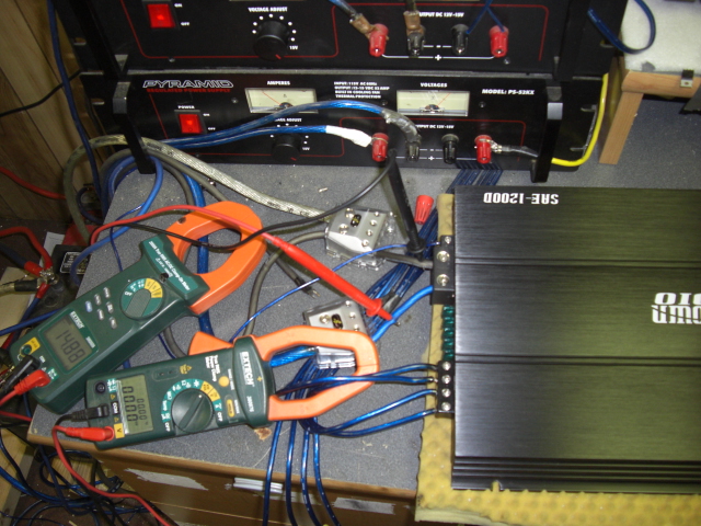

For the sake of this test I just turned everything wide open just to see when they quit making power. THD was not a factor at all, just wide open. Obviously this is not the ideal situation -- I may send them to Chris so he can use some of his equipment to do a test using a scope as well.
The amps are fed with a 4 awg and 8 awg wire in parallel reduced to 8 awg so it will fit both amps (the 1800 won't fit our 4 awg lead directly as it is tinned).
Test load consists of two Nightshade 12s wire to 1 ohm and the tone is 60 Hz.
* SAE-1200D on the bench
http://www.sundownaudio.com/misc/1800-watt_China/vs1200D/CIMG2617.MOV
* Power Test
http://www.sundownaudio.com/misc/1800-watt_China/vs1200D/CIMG2618.MOV
* Output Voltage Test
1730 watts
59 V
29.3 A (calculated)
2.01 ohms (calculated)
12.68v power supply
* 1800-watt on the bench
http://www.sundownaudio.com/misc/1800-watt_China/vs1200D/CIMG2621.MOV
* Power Test
http://www.sundownaudio.com/misc/1800-watt_China/vs1200D/CIMG2622.MOV
1440 watts
57.1 V
25.21 A (calculated)
2.2 ohms (calculated)
13.1v power supply
SAE-1200D produced ~20% more power... and this 1800 has an extra 2 output FETs above the AP1500D.
An SPL test may be more revealing... I may see if the 1800 will stay on in the Jeep at 1/2 nominal -- my rise is to just above 1 ohm.
