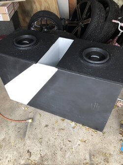

I got my SA 10s in a huge box. Like 10cubes.. they straight hammer. I have steering wheel flex and when my windows are half way down they shake they are going to break. They play down to like 25hz with authority. I love me some huge boxes. If u heard this setup on 500watts u would crap your pants
