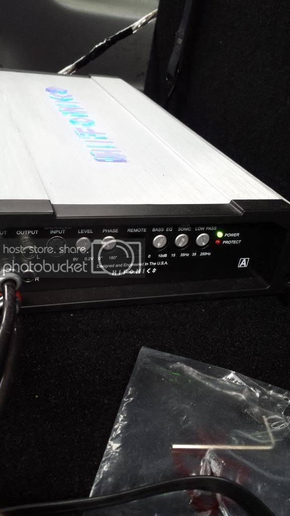

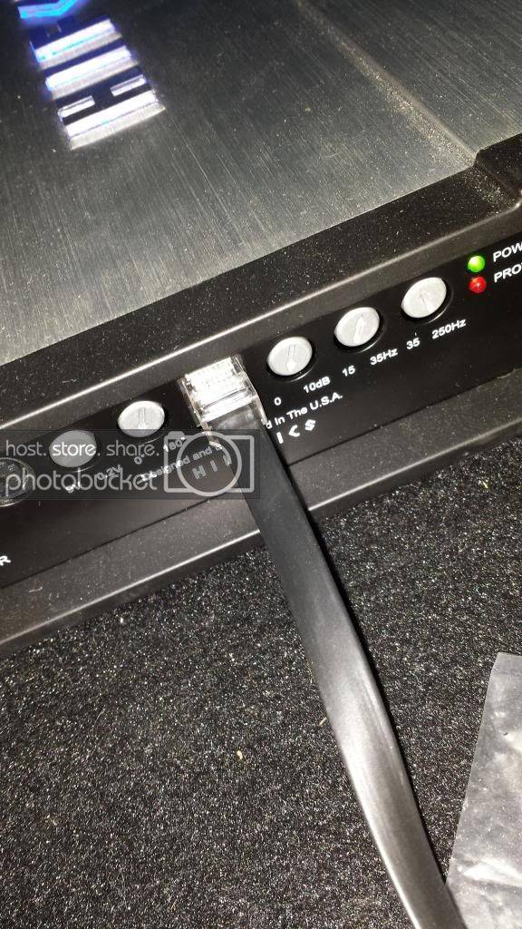

Ok guys I get PLENTY of output now it is ridiculous, even maybe a bit too much LOL... I tried just for fun the gain at 2.5 o'clock, with the preouts at the maximum (+6) and the volume at 40 (I should have done it at 50, maybe it is getting way too much now, but it did not smell yet, dustcap only getting a bit warm, and I have port noise XD). With those settings (with a -3 dB @ 50 hz test tone) I was getting about 32V, which is like ~1000W, subsonic and lowpass filter off). Now I get voltage drop, it goes down to like ~12.5 now):
Before it was like this:
Here is a video (sorry for the bad microphone quality and the phone orientation):
Is it really too much LOL? Or it will just be ok if I only do this like a few seconds per day XD? Thanks!
it actually seems okay, thats the deal with hifonics a lot of times if you have a budget (180$ or less) head unit, Its actually not at clipping levels even though the gain seems really high. Just to make sure though, have someone with an O scope run through to see if your signal is still in the green. if its clean and not getting warm after an hour or two on full tilt then your good to run it like that daily.
Sundown SA-12 (Flux Pavillon - Bass Cannon) - Vidéo Dailymotion
I know it is really hard to see but it almost get the same excursion as this:
If the sub isn't getting hot or bottoming out, it's all good! Yeah don't go running around like that all day, that may be a bit abusive, but seems like it all worked out for you. Did you reposition your box as well?
Nope I did not. I cannot fit it with the amp behind that way. I would have to put the amp on the enclosure and from what I've seen, it is not recommended. So I just kept my setup like it was. By the way, how do I know if it is close to bottom out or not? Thanks!
If it bottoms out you'll hear it, it'll sound like a mechanical noise from the sub. Literally your sub would be tapping the backplate or hitting it's suspension limit 60x per second, but from what I remember SA series is almost impossible to bottom, you'll smoke the coil first. So if it's not getting hot, dont' worry your safe. I guess it's time to go back to show your friend huh?
