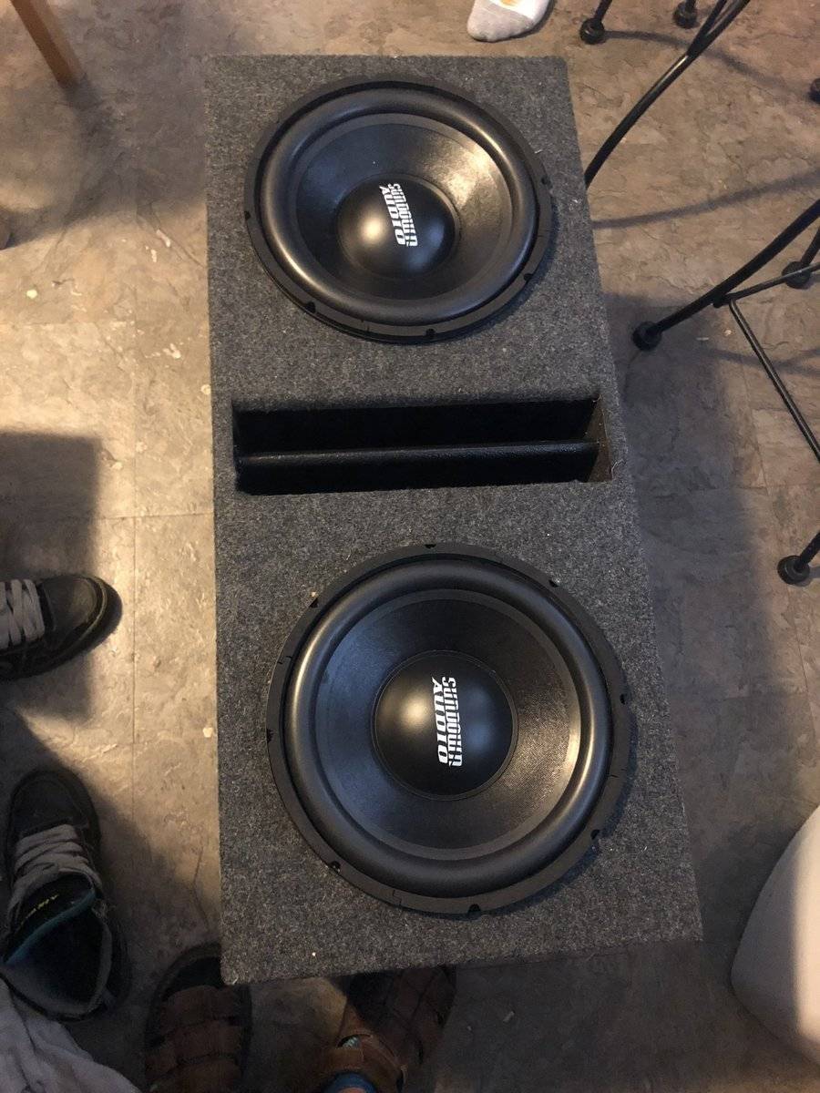

For two 12” d4 lcs woofers in a ported prefab box on a 1000d Memphis amp and they hammer for being $90 yard sale woofers. Decent budget set up
read my last i didn't quote u.. i know that box., i've checked the cf on it and it's lots smaller than they say.. i've tried to calculate tuning but can't tell if ports are 2" each., can u do me a favor and measure each for me (width)
You guys are funny. The lcs are sundowns woofer made for prefabs. They actually have good bandwidth and play lower.... this is massivespl/hertz mafia, lost password to those when the site changed over. I know what I’m doing... y’all quick to jump anyone u don’t know lmao.big internet thugs
Just trollin here man... but they look great in a bit over 2ft3 net tuned to 33hz or so to me... I wonder how much better they would sound in a driver specific enclosure?
1K amp looks like it ought to really move those too.
hey don't ya'll me in with him., i ran tahoe off flob last nite for being an *** to new guy with actual brain injury.. i really wanta know what port width is top check tuning (it's labyrinth right)? either 1.5 or 2" if 2" then yeah it's tuned high and probably 1.25cf per sub..
It’s just a ported box. Not labyrinth... I had a prefab sitting in the garage. I bought two lcs woofers to try them out for $90 for both... they are pretty nice for $45 each. I don’t care if I could build a better box. I have like $100 into the subs amp and box.
Box is
35” wide
17” deep
15” tall
port is 13.5”x1.5”x25” L shapes port not a labyrinth
