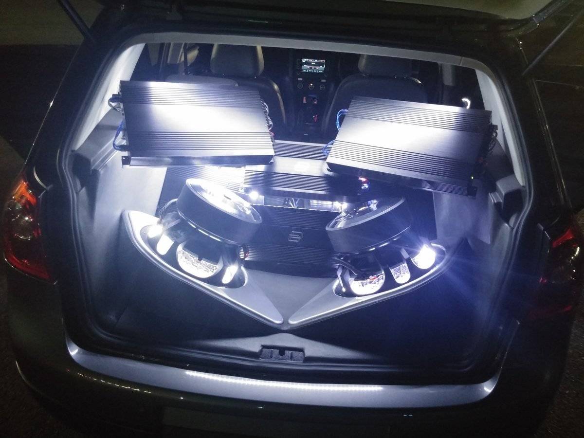

Hey guys, brand new to the forum. I really hate asking for help because I know just about every problem has been addressed alreadyI’ve searched and searched but cannot, for the life of me find a solution nor thread on what I’m experiencing right now. When I start the car, the amp light glows blue, but the subwoofers will not work until I disconnect and reconnect the positive speaker wire from the back of the sub. Once, the subwoofers started playing after I cranked the volume on the receiver up real high. Is this a poor connection? I’ve checked the power, ground, remote and speaker wires, I’ve replaced the plastic connector on the enclosure, switched the order of the subs (wired in parallel) but to no avail.
