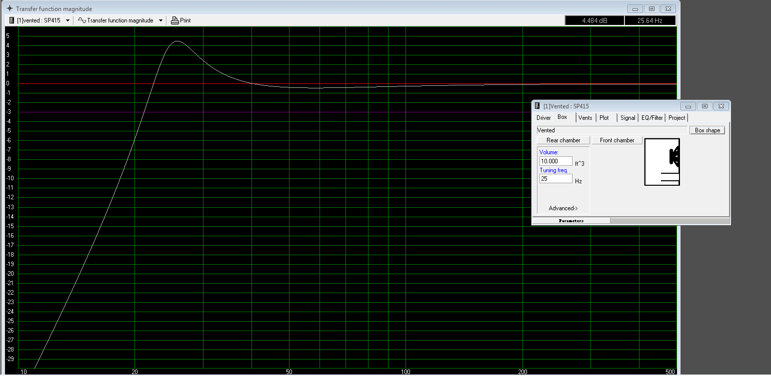

i modeled the fi sp4 the other day and it loves low tuning, the response curve was pretty **** **** and it seemed like i could get substantial peaks the larger the box i used
obviously 10 cubes for a 15 is ridiculous but this is 25hz tuning
