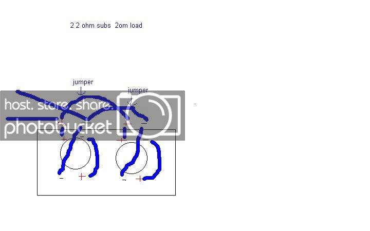

hello guys i understand the wiring diagrams jsut i dont know how to get the wires to the terminlas on the box then to the amp so is this right 2 ohm subs dvc to a 2 ohm load
if you want a 2 ohm load at amp with 2 subs that are 2ohm DVC - wire subs in series (4ohms) then from box to amp, both + and - goto amps bridge + and - terminal (parrell 2 ohm)
ok thanks guys thet drawing pretty much same as mine instead of jumpers you just have two positive wires coming form amp and two neg ative coming from amp
