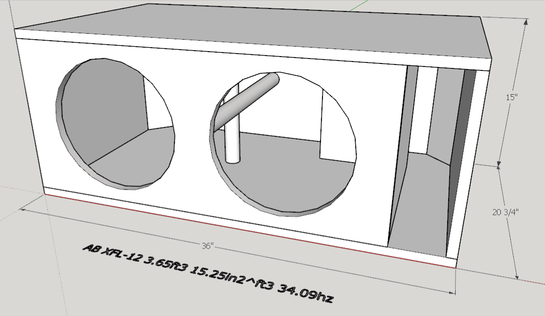

of course all would have to be ported the xfls should always be louder because of cone area but they do need good size box.., but like he said if space is a problem and u are trying to tighten subs up some u can go little smaller but with the power you have i wonder if u better with 1 xfl in 2cf tuned at 35hz..
I'd do the XFL's if I could, what will fit into that Cruze?
I'll bet you got enough room and a large enough opening to squeeze this one in...
