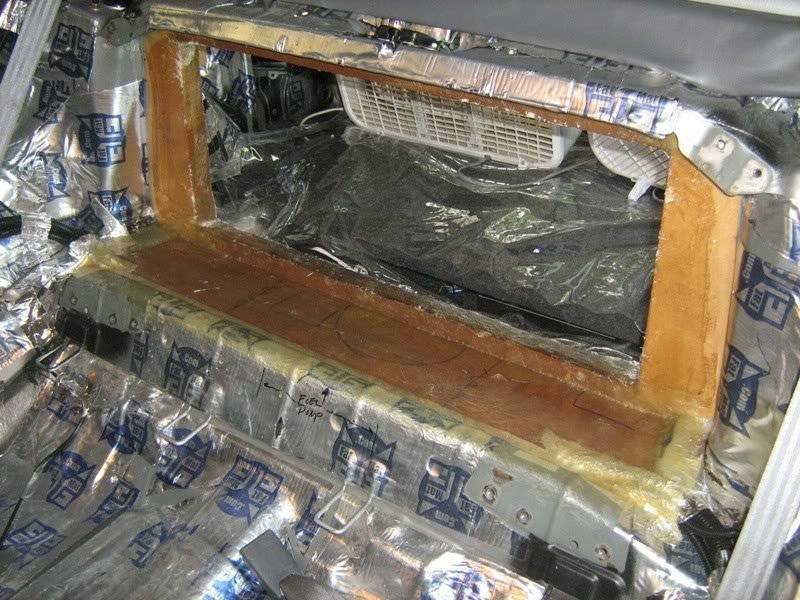

I think got this pic from of the builds of @keep_hope_alive
You could build a frame like that and seal around it, then do a slip in box design with an oversized baffle that is cut to fit over the frame and cover it like a beauty panel, then use lag bolts inside of the box that go into the frame to secure the box. That would allow you opportunity to remove the box in the future.
he did it right and with a certain amount of, shall we say, overkill LoL!! keep-hope-alive doesnt mess around in the slightest
