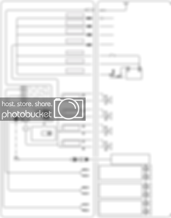

this may be able to help you on the pre outs of the head unit.

that does not really help me on the preouts man, a simple yes it has three sets of outs or yes i ran three sets of rca's to my amps would of been better. or maybe a yes the front outs from my hu go to the 4ch amp and the rear output is split to go to the 4ch and my sub amp would help too.
