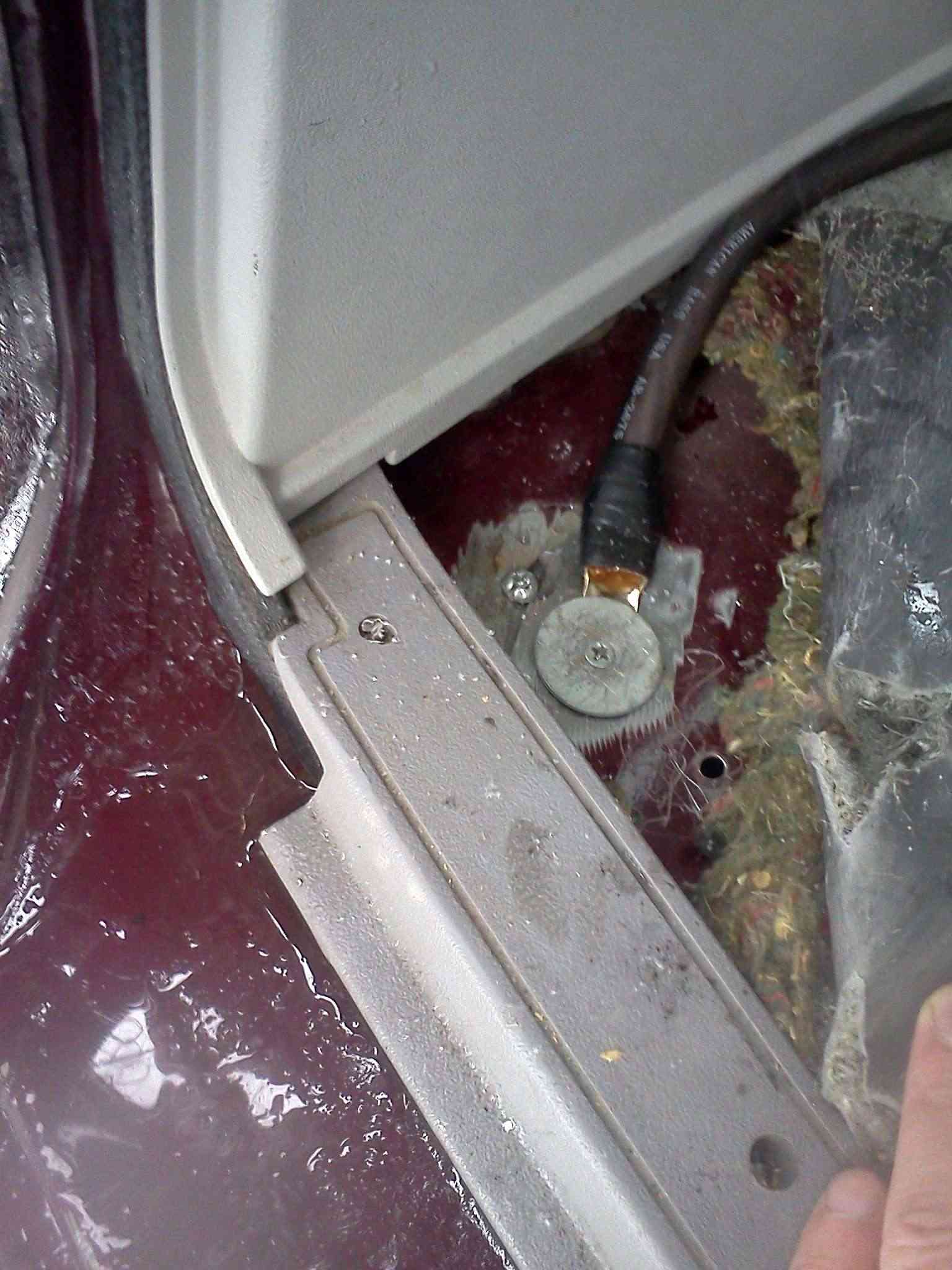

subs makes noise when i roll my windows down?
this how i got my ground
Electric motors and solenoids make electrical noise spikes. Your RCA cables could be picking up a power spike when the window motors start. Does it do the same thing when you click the door locks?
looks like an okay ground... maybe try sanding it down really smooth with some 220 sandpaper (that's what i did) and i noticed a hell of a difference in sound as well, so maybe that's something you'd like to try
maylar i actually didn't even think to try with door locks kinda late but i will look tomorrow
BoomBoxStereo idk i guess i could try it just weird the windows button would even pick up on my sub ??
