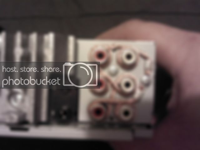

Try grounding your head unit RCAs like this

Wat cud I use to do this and wat does this do? Iv seen it a lot....

If your sub output is set to stereo on the head unit then you will need to plug both in or else the sound is uneven. For grounding head unit RCAs, its just speaker wire with jacket removed. 12 gauge 16 gauge 18 gauge all works fine.
