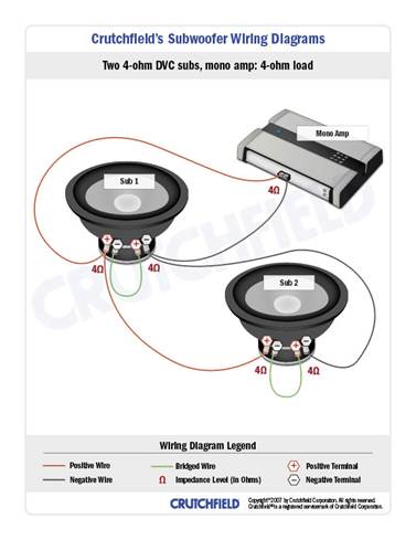

I didn't want to clog up the audio legion thread with this so I got 2 armada 4ohm dvc 12's coming and I pick up a smart 3k today for $100. Watching the dyno on it, I think I'd get more then enough power running at 4 ohm (the efficiency looked great at 91%). I saw a wiring diagram on Crutchfield that's looks odd (I've only ever wired in parallel or in series) that would get to 4 ohms at the amp
I'm gonna sound like a dumbazz here...but is this a legit way to get 4 ohm or am I better off running down to 1 ohm.
The subs are rated 600w a piece and the smart 3k does about 2k at 4ohm.

Send it. Breaking them in @ 4 ohms can't hurt. Then you can run them at 1 ohm if you want more.

You can run them @4ohms for the pair wired up as shown. Just tune them and you will be just fine man. Later on.. If you want to run the Pair @1 ohm you will need a 1 ohm stable amplifier..If you want to run a single DVC4.. You can wire it to a 2 ohm load. Use what you have man.
