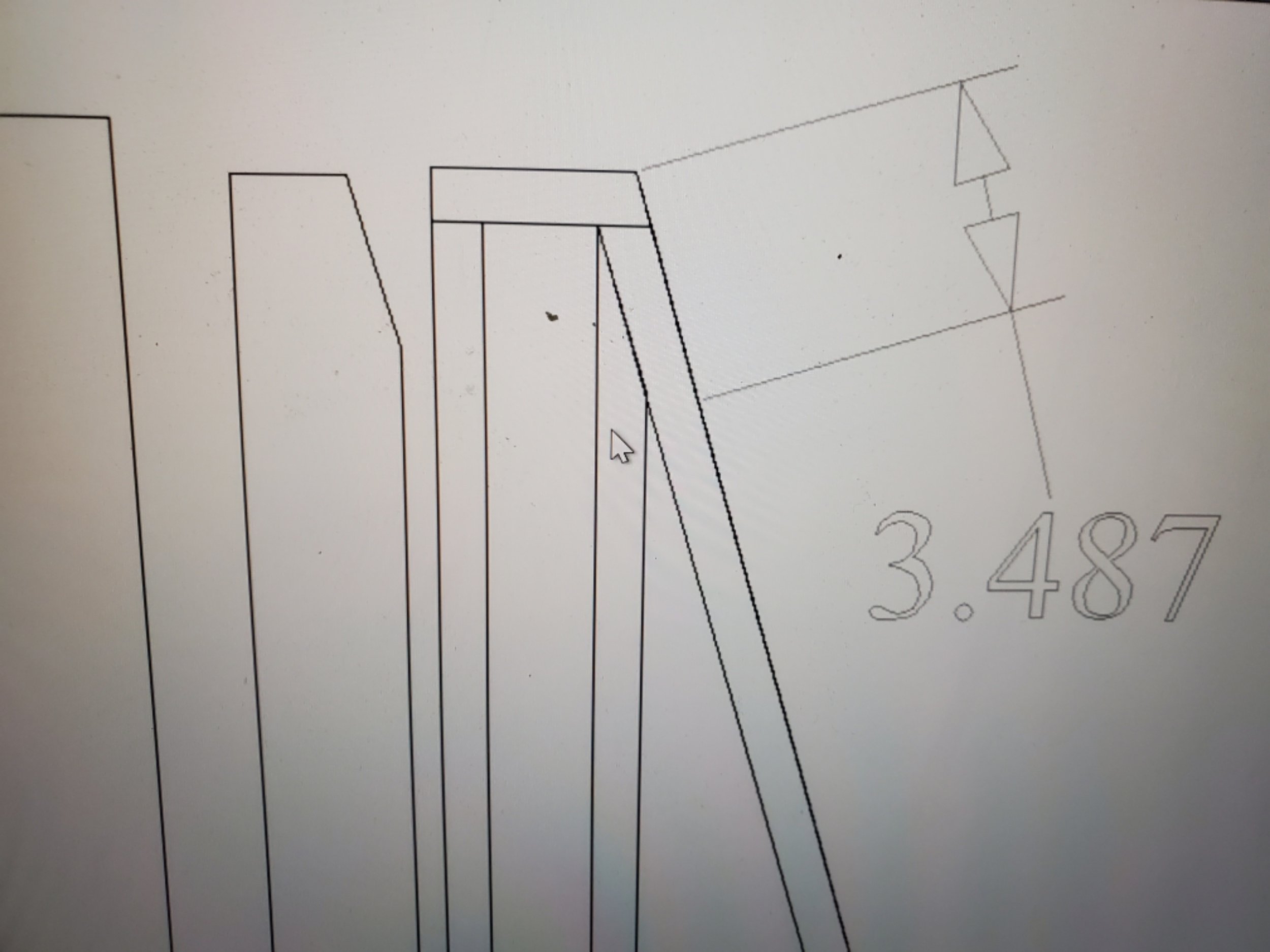

I had to drive about 3 hours to get it and he also drove about 2hrs and we met in the middle so I can’t meet back up with him. I will try to get you the dimensions but I can show you a pic that shows where he wanted me to put the the screw.
36635
the piece that is flexing is the outside piece that is slanted outwards not the straight piece

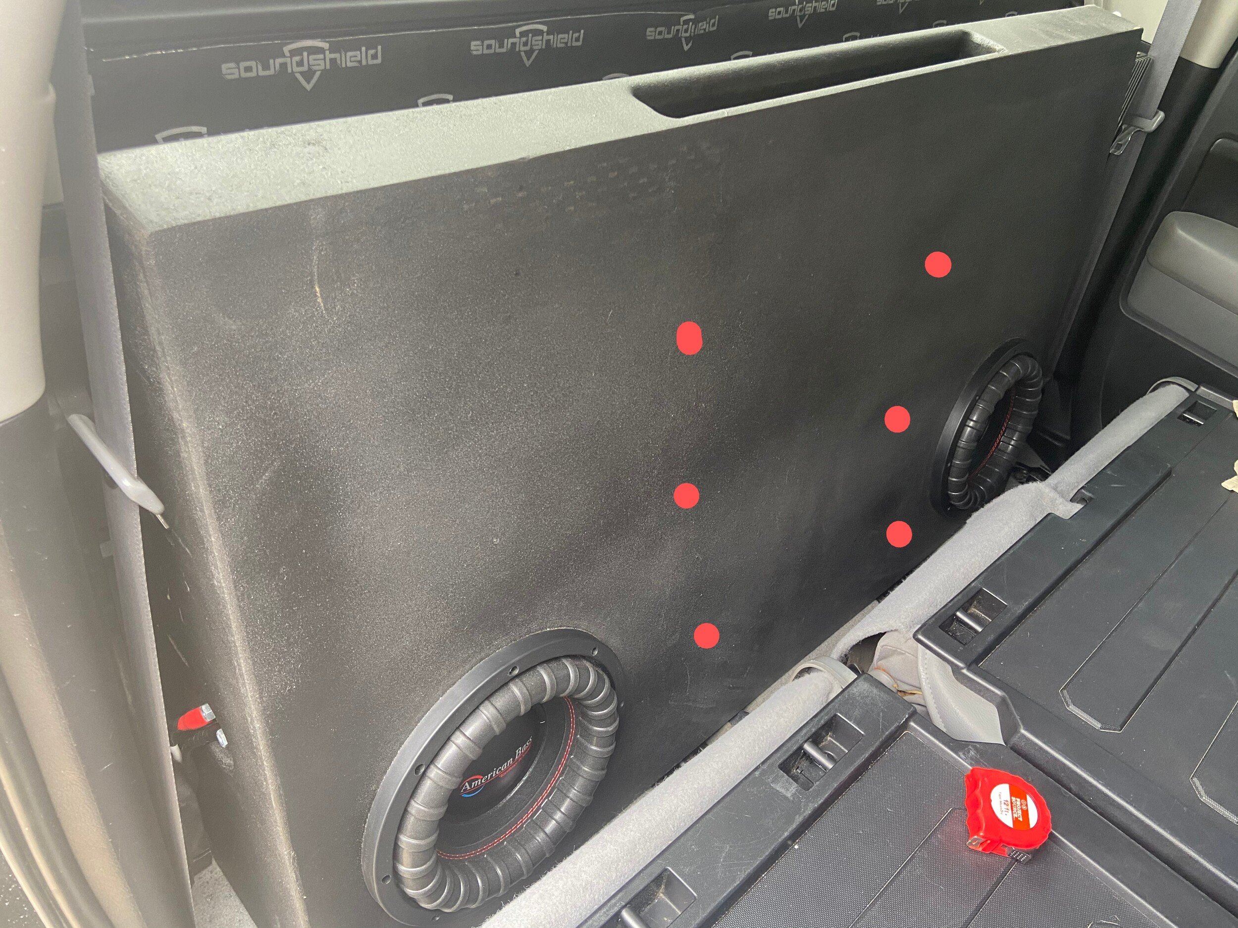

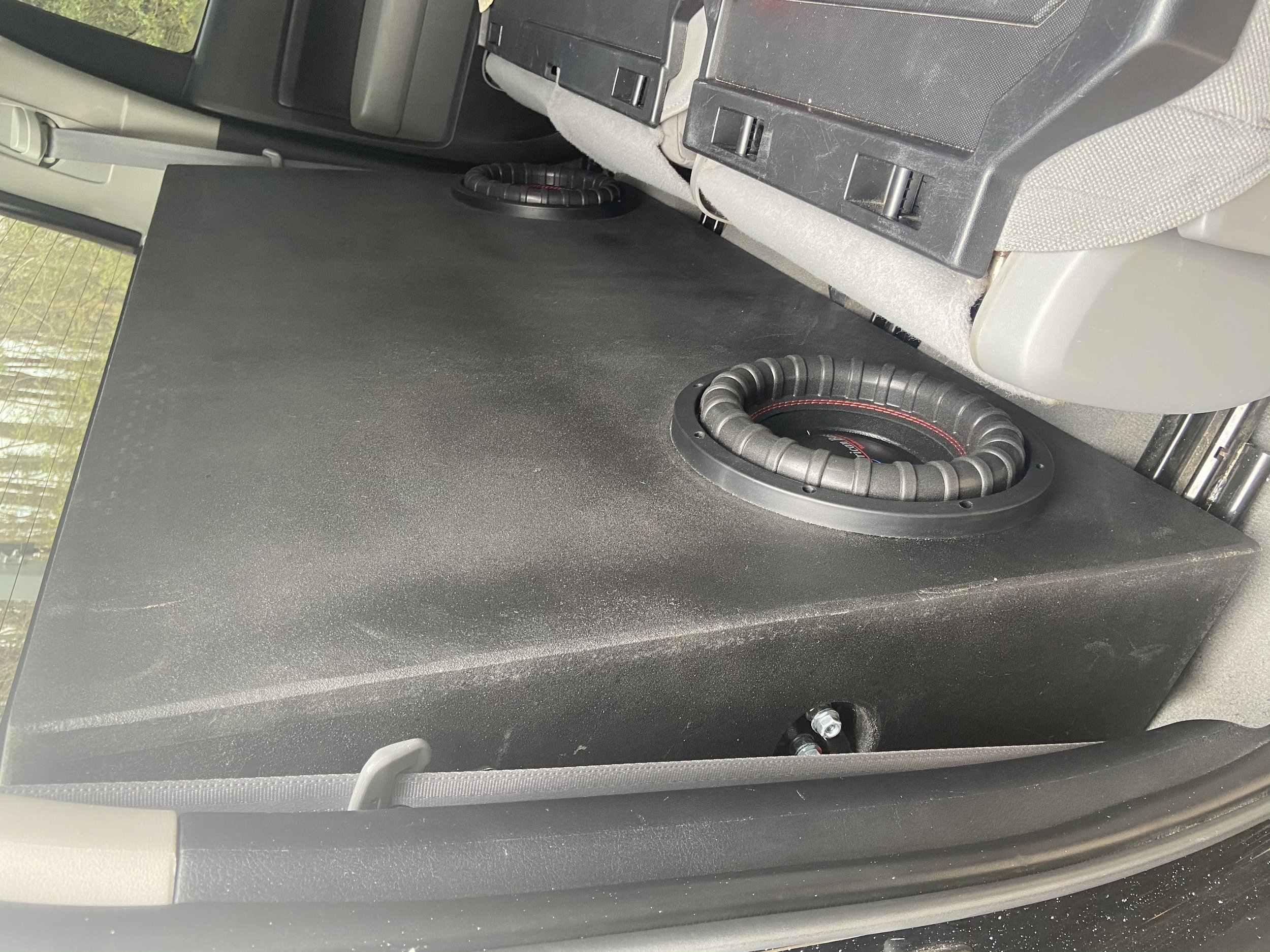

Instead of dimensions, could you post pictures of the box? I thought it was of the rectangle persuasion. Also, the flexing was on the baffle or the rear panel?
When I put my hand in the front of the box It’s hard to keep my hand on it’s because of the vibration and it also makes this deep bad sounding noise(that’s how I found out it was the enclosure because a car audio shop person had pushed against the front piece pretty hard and the noise stopped) about how many screws do you think should solve my problem?
The screws will go in the back panel. 5 equidistant screws starting 1 inch from the bottom of the port wall should suffice. Try using square dowels, easier to cut angled and hold in place while screwing. Red spots are dowel location. They should abut with the side port wall.
