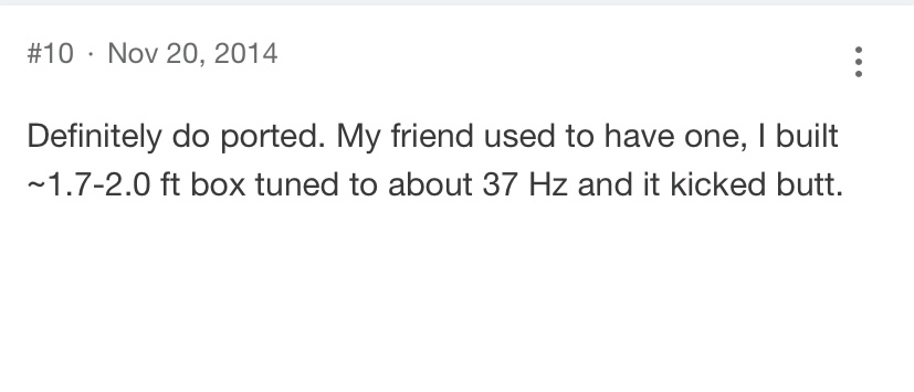

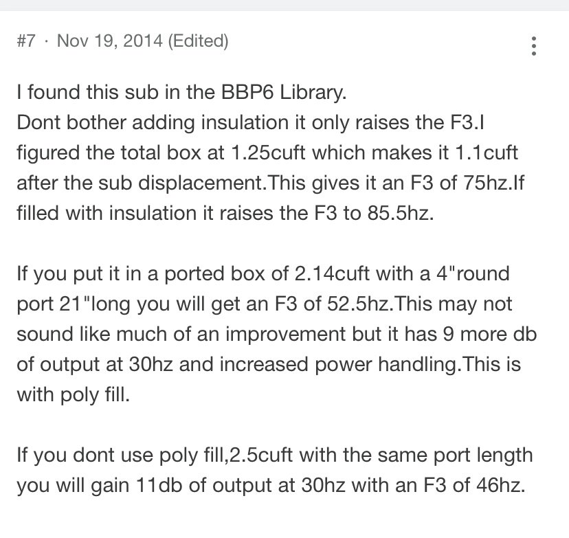

The .6 means they are the dual 6ohm version correct? I had the dual 4 ohm version and it was in 1.25 sealed. Nice sounding sun but not enough output for me so I traded it. This was back in mid 2000. Here are some post from diy from folks that ran the sub ported.

I found some posts on DIYMA from everyones help here so far. I think the 8812DVC is the same thing as the 8812.6 with the 6ohm coil split into 2 3ohm coils. I've started doing some plots using those parameters and they seem to make sense.
