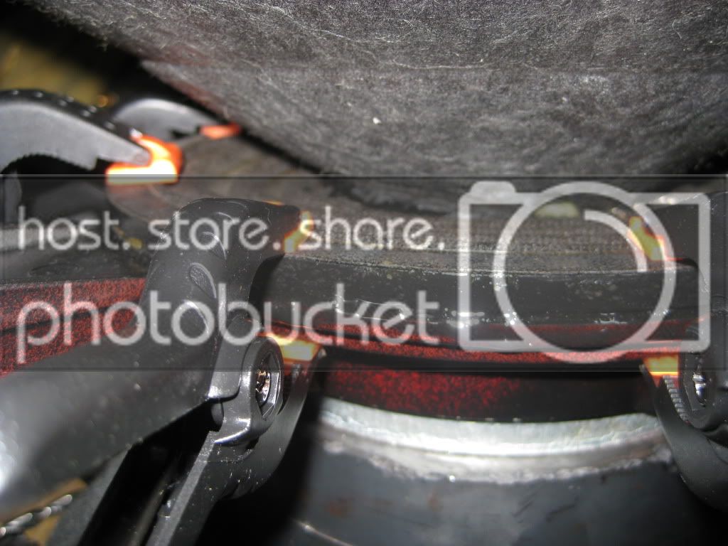

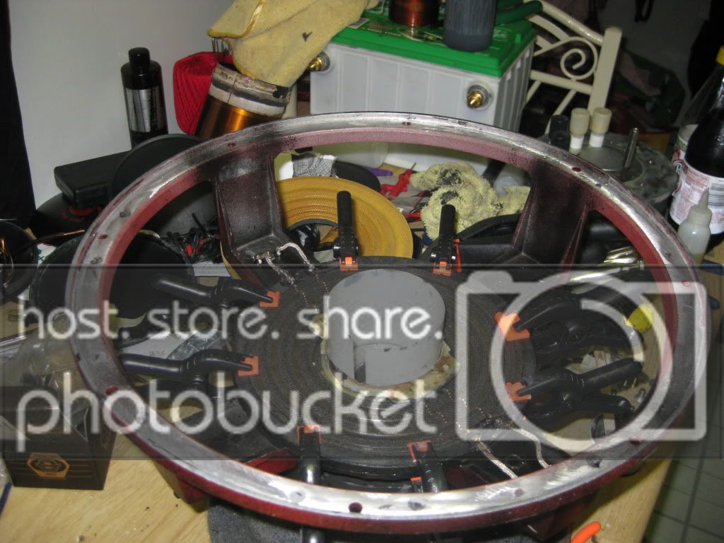

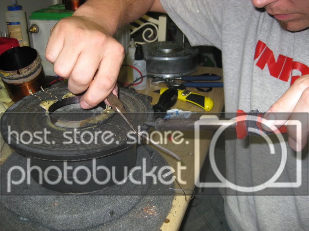

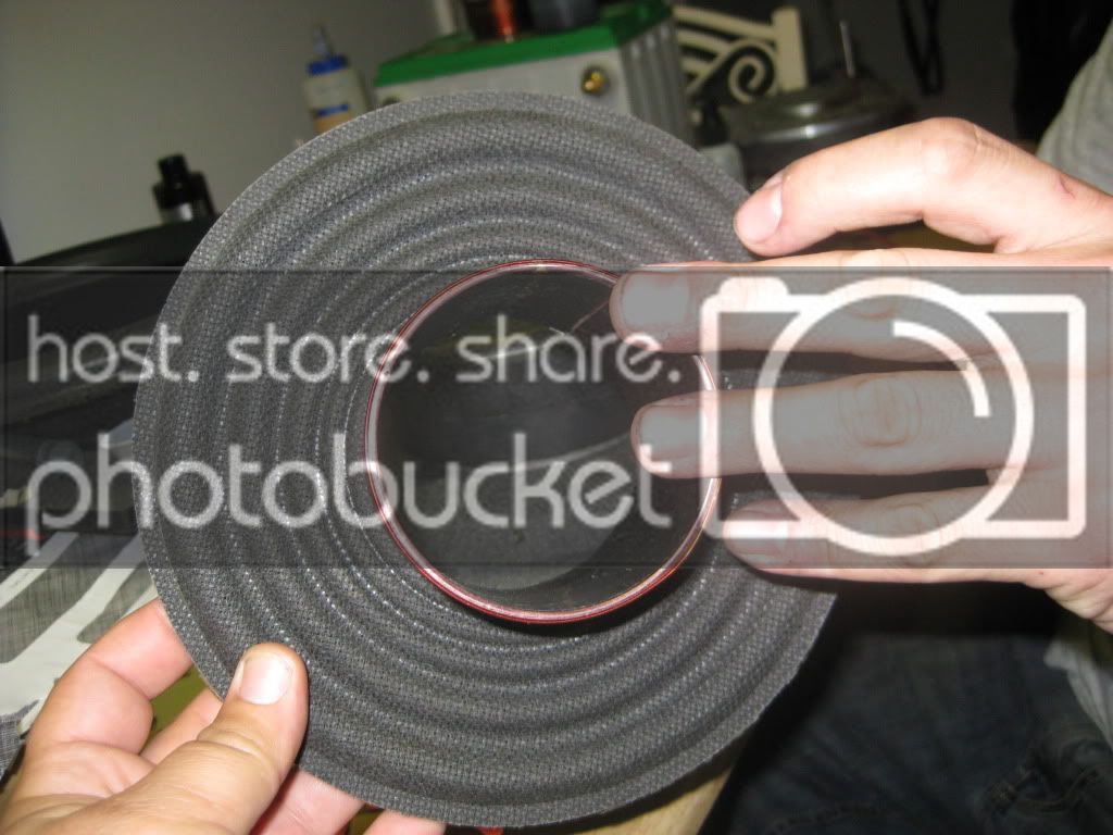

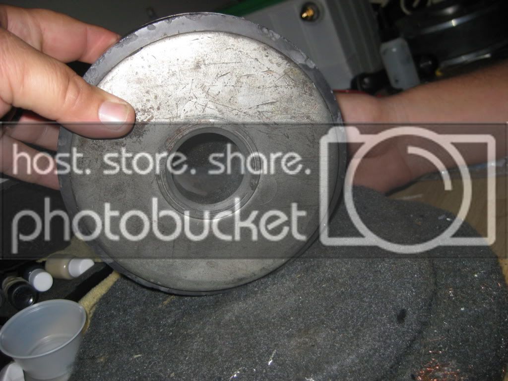

Sub built Completlly from used parts
lord baccus

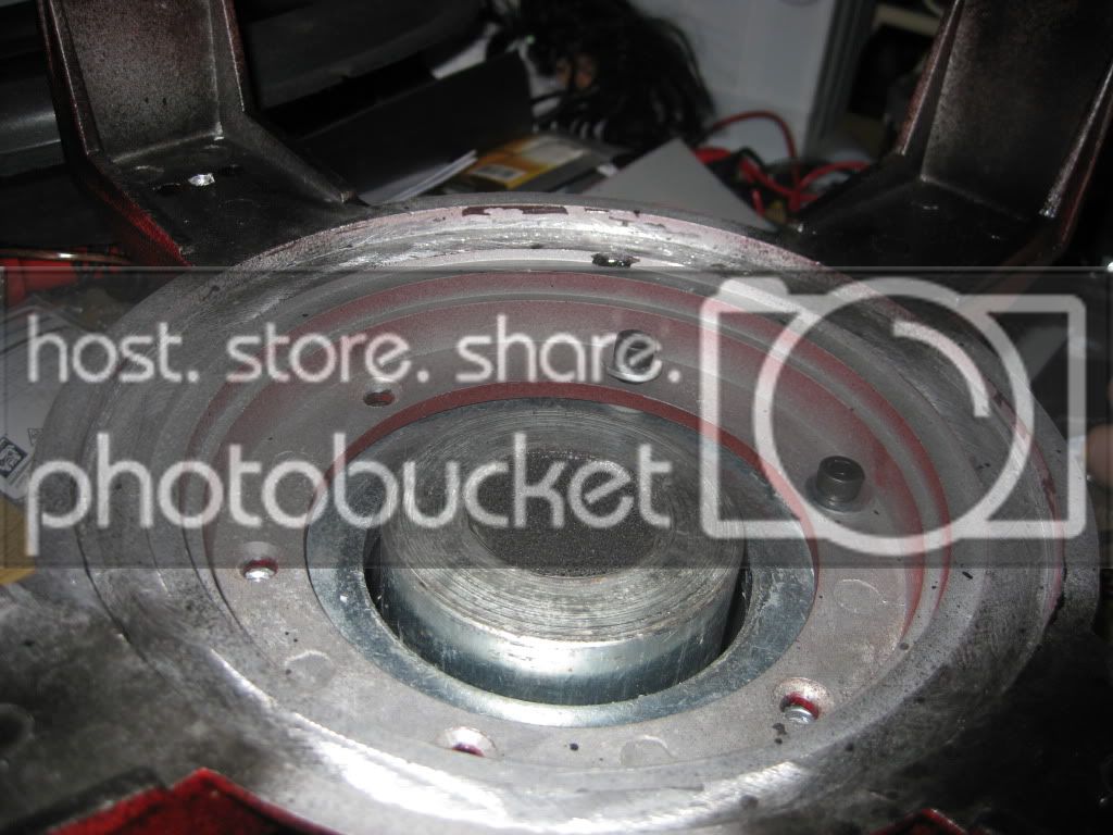

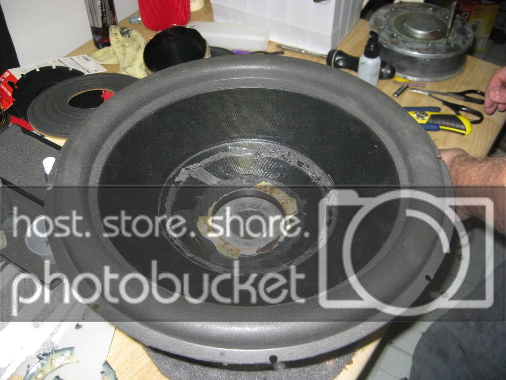

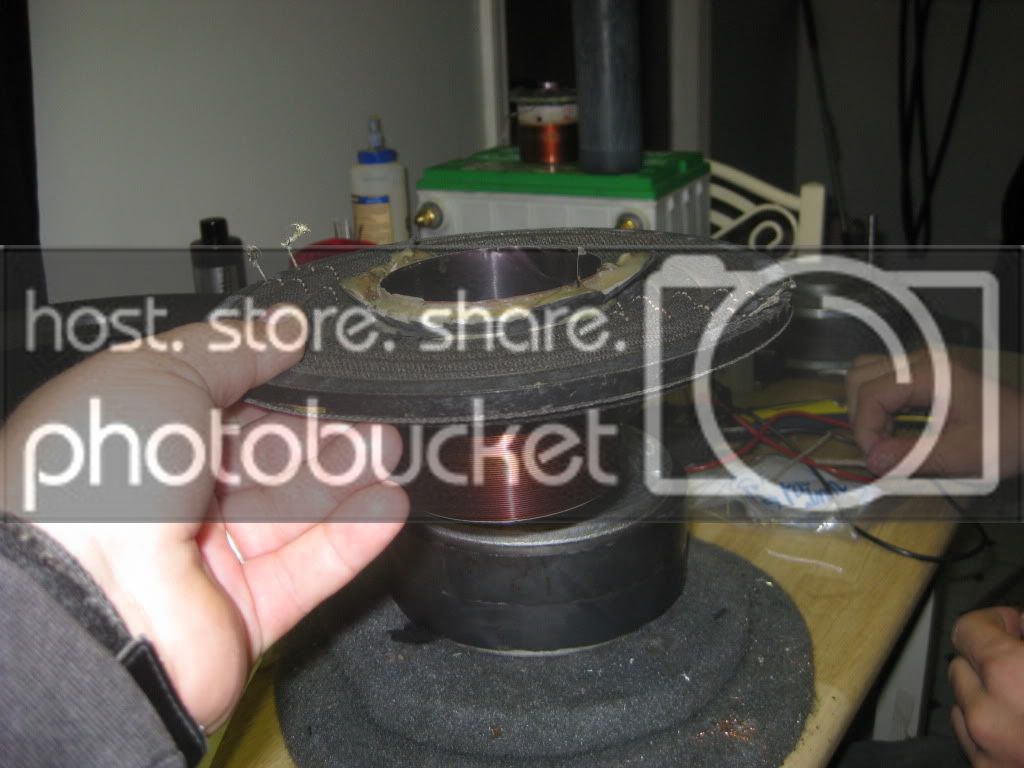

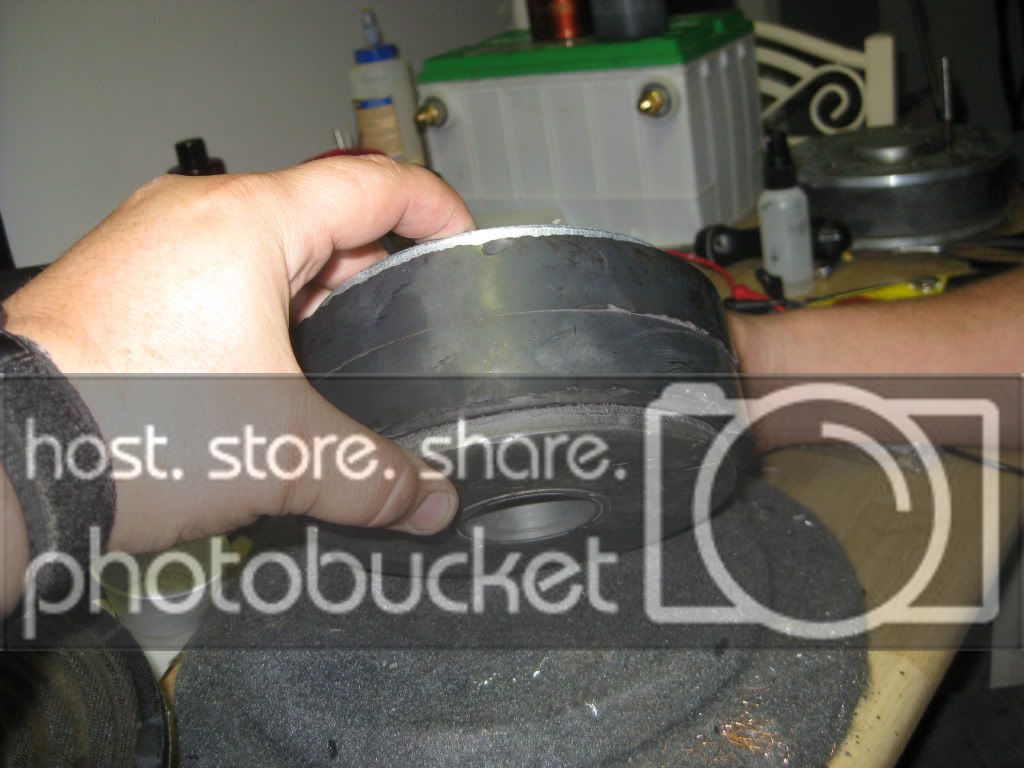

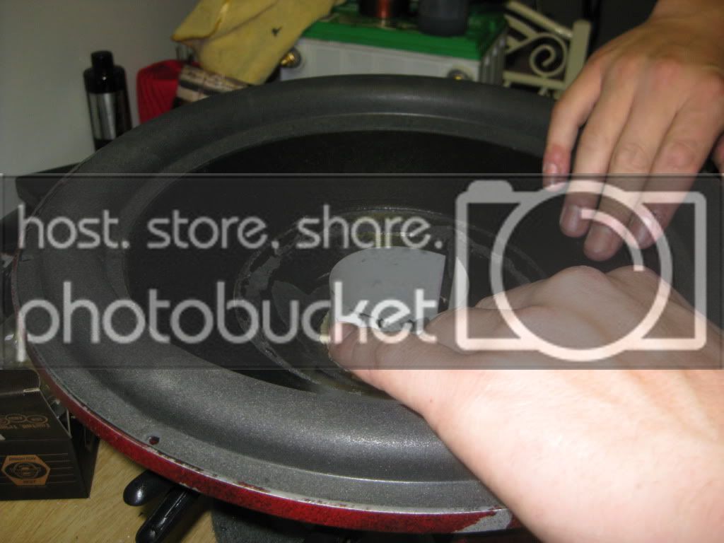

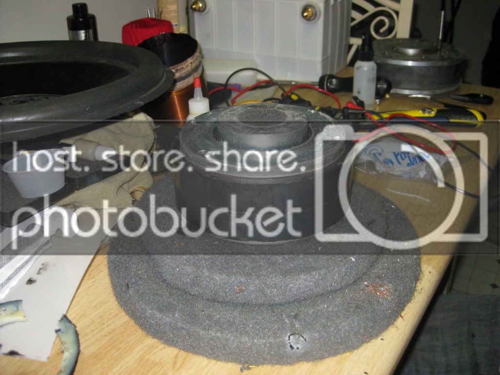

pics below vvv
Memphis Mojo 15” cone – reused
DD 9515 4 spoke basket – reused
Pierce Audio Products 6” / 2x slug motor – ¬ reused
8” Kove Armageddon Spider - reused top / 8” Psi hard spider modded bottom – new
2 part epoxy from Pap - black
Modded tinsel leads – new
RE style terminals ¬– reused
¼ washers used as spacers for custom venting – new
6” ABS dust cap ( maker unknown ) reused
Total parts cost:
Motor $15.00 + $10.00 shipping = $25.00
Spider $8.00
Re terminals 2.00 ea. = $4.00
Spare/scrap parts $0.00
Total = $37.00
