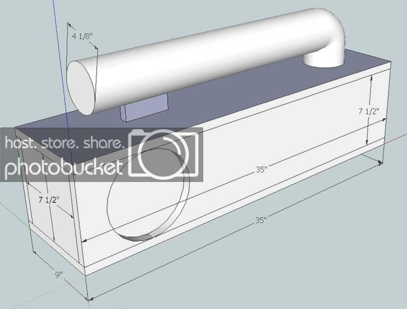

ok im going to cut the box to shrink it to .6 but is there anyone out there who can tell me how much needs to come off

and here is the the design of the box also how much do i have to cut the port to keep the tuning to 32
if you need .6 an your using aero ports ya can try this
10x8x30 with 2 2in aero ports 16in long tuned to 34hz give or take a few hz gross is .9 net is .8 after disp of port an sub. i didn't know what the disp of the sundown 8 was so i used the p2d48 which was .030 may not be the right one but i think it should be close. i think it should work never really worked with a 10 an don't know how much room you have to work but i hope this works out for ya.
